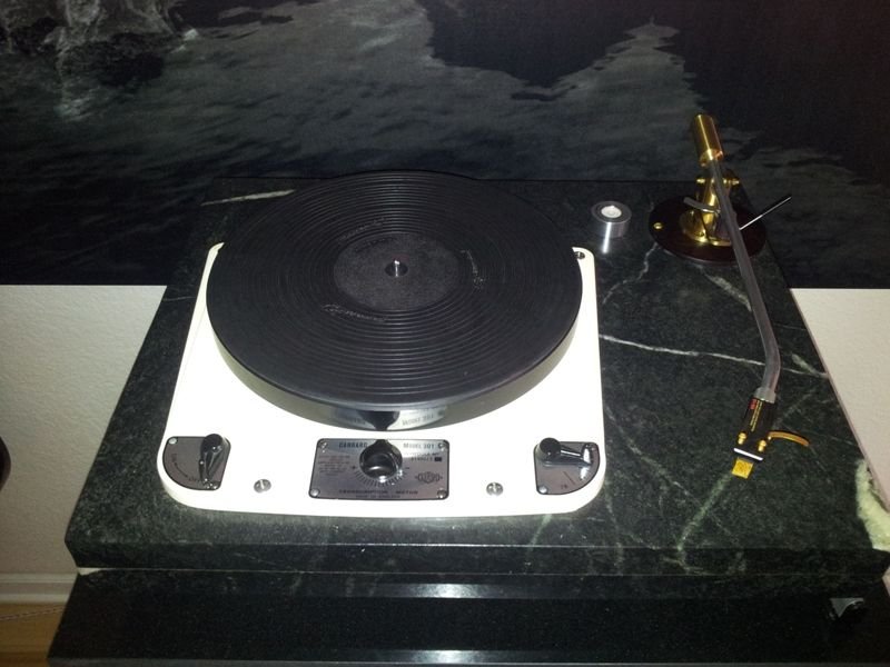

: The only time I will listen to MP3 'music' is when I'm on the tractor mowing the field. Other than that, no MP3 'music' here. Can't stand the sound of compressed audio.... I listen to vinyl with a tube amp....
'57 Gerrard 301 w/12" Thomas Schick tonearm in soapstone plinth I made.

you must have the really good shocks to be able to run your vinyl turntable in the F150 cargo box, OR DOES YOUR WIFE HOLD IT ON HER LAP?
