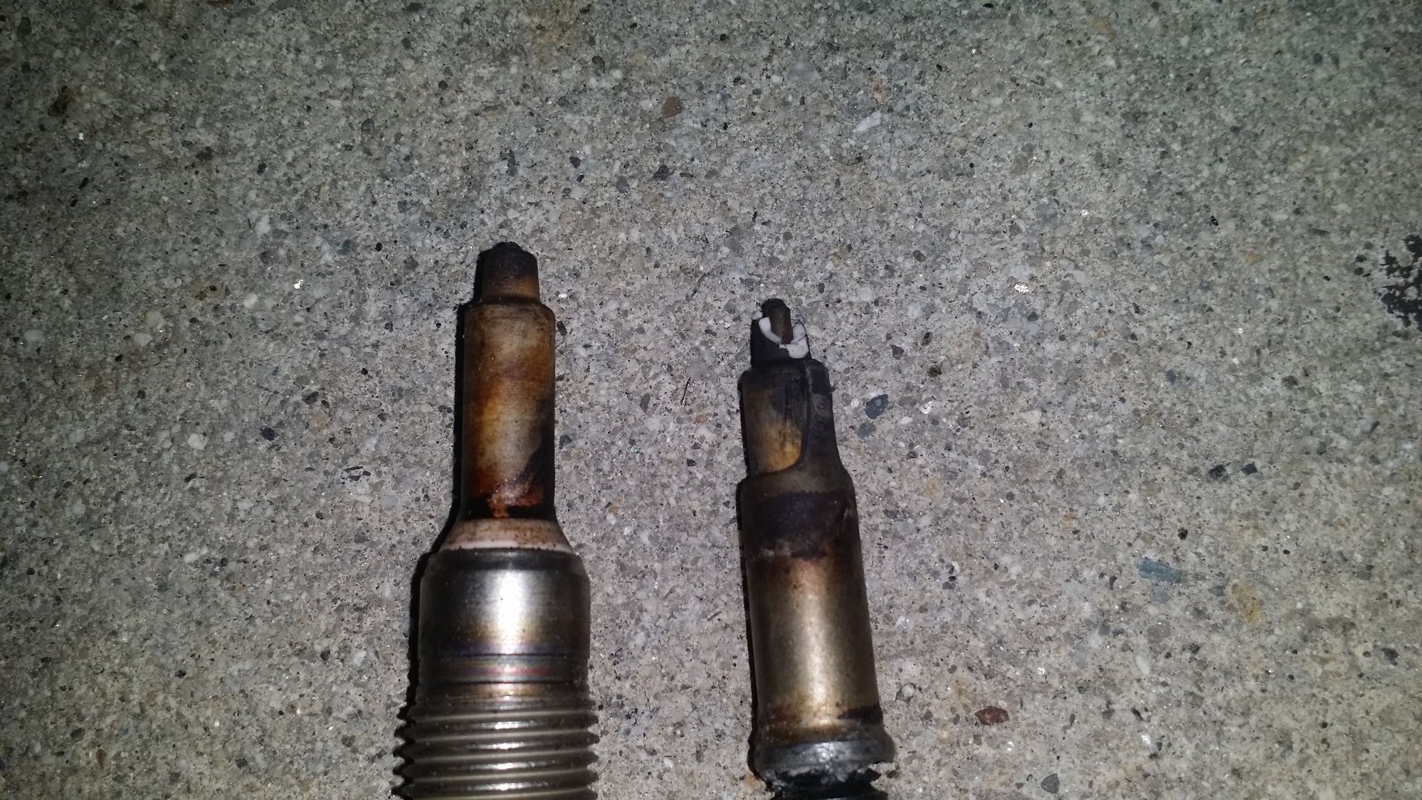

I've had this 2006 5.4L since 2009 when I got it with 44,000 miles, and I assume the original plugs. One of my friends got the same truck (a 2008 I think) a few years later, and we planned on doing both our plugs. His truck started misfiring and throwing codes for the individual cylinders so one day we doused all the plugs with kroil and tore into them a day or few later (this was 2-3 months ago.
I did mine first since it was at my house and I have extra vehicles. The first one I did I used a 1/2" electric impact wrench & it pretty much shattered the thing & we got good practice for worst case scenario (extractor kit worked well). Then we went to his, & only hit the 3 that had misfire codes....all of his went smoothly & came out in one piece.
Tonight I got back into mine, changed 4 before it got dark. I still have the farthest one (closest to cab) on the passenger side - I think I'll have to remove some sort of electrical device to get at that plug, and then I have the 2 closest to the cab on the driver side that I think will be pretty easy.
Moral of the story? Don't wait until 133,000 miles to change your plugs. My engine is still running perfectly (with a tic it's had since I got it), this is just late preventative maintenance.
I'll try to find the threads on spark plug changes, I think I'll warm it up for a while next time....cant believe I had problems with every single plug I doused them all with kroil before I closed the hood for the night. Tips stuck in (just the metal, not the ceramic...the ceramic tip stuck in the very first one but not since), the threaded rings came out & left the tip & the ceramic in (pull the ceramic with pliers or magnet, then use the extractor tool to remove the metal tip). Pretty frustrating!

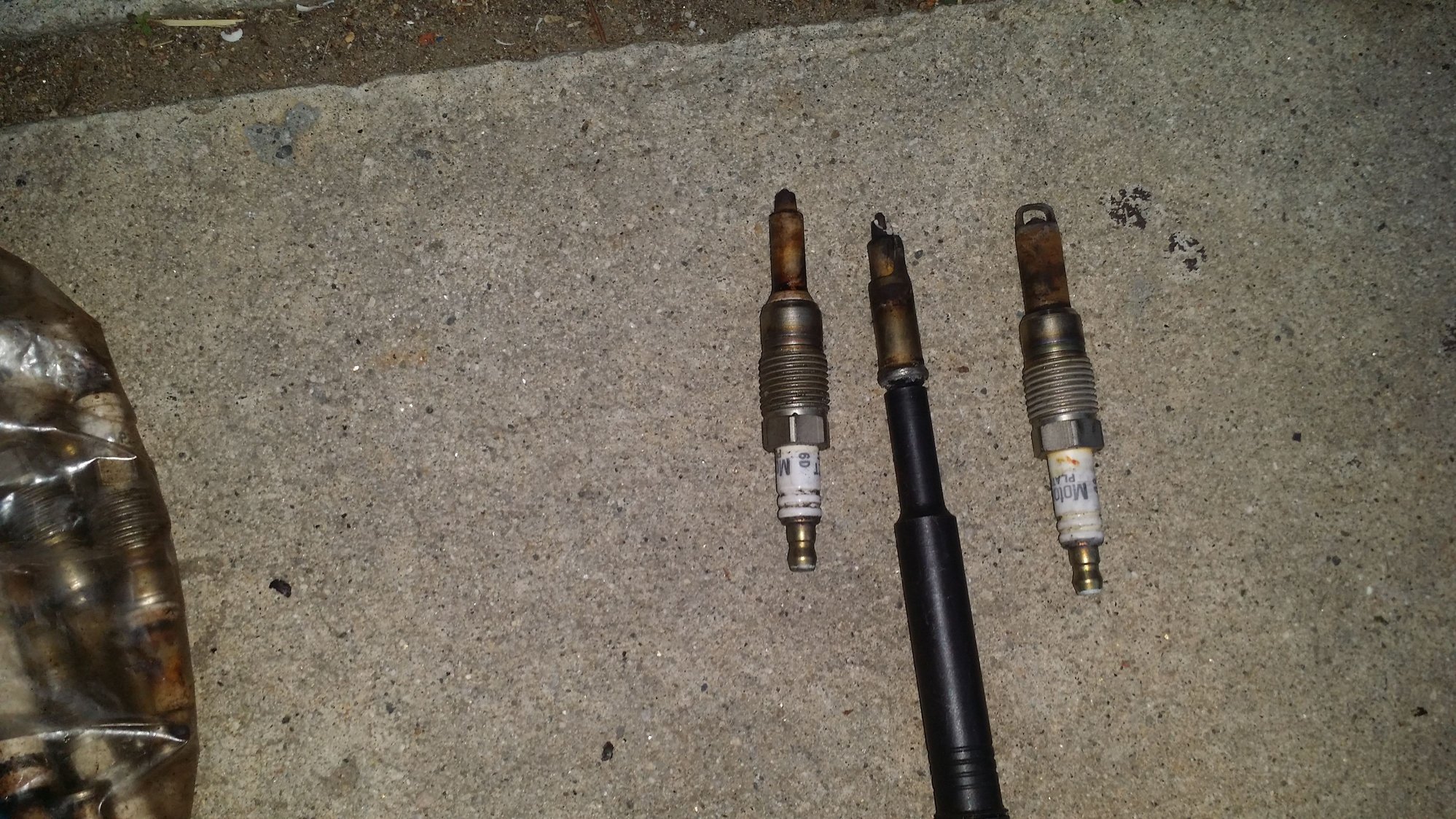

Success! I drove my truck to autozone & got some liquid seafoam & sucked in about 35%+ of the container, waited <10 minutes, smoked out my neighborhood, then loosened the first plug (third from front, driver side) and it just spun right out so I didn't stop to hit it with carb cleaner. The driver side closest to the cab - it broke the ceramic & left it and the tip in the hole (let it sit for ~15 min w/ carb cleaner after I loosened it). I went to the 4th one from the front on the passenger side & I thought it was broken for sure but when I pulled the socket, the plug was with it.
Extracting the broken ceramic/tip from the 4th on the driver side was rough. The tip pressed through the ground strap & a small portion of ceramic fell into the cylinder. I was able to vacuum a good portion of that, hopefully all (connected a ~1/2" tube to a shop vac, then I placed a muslin bag between the shop vac tube & the shop vac, so I could see what I was able to suck from the cylinder. After I'd vacc'd the cylinder for a while, I fired up the truck & held the vac on/near the spark plug hole & let it run for a while.

thought I'd post some pics
