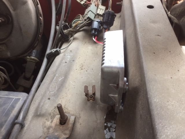

New Motorcraft module. I put some washers behind it for better air flow (like suggested). The old modules four wire plug had both the ears/clips broken off, so it's been off in the past for testing/diagnosing or something? Maybe I did that when I was in high school or something....You can see where the old epoxy leaked out on to the inner fender, I was able to pop the epoxy off with a chisel, you can see the clean original metal inner fender finish.
