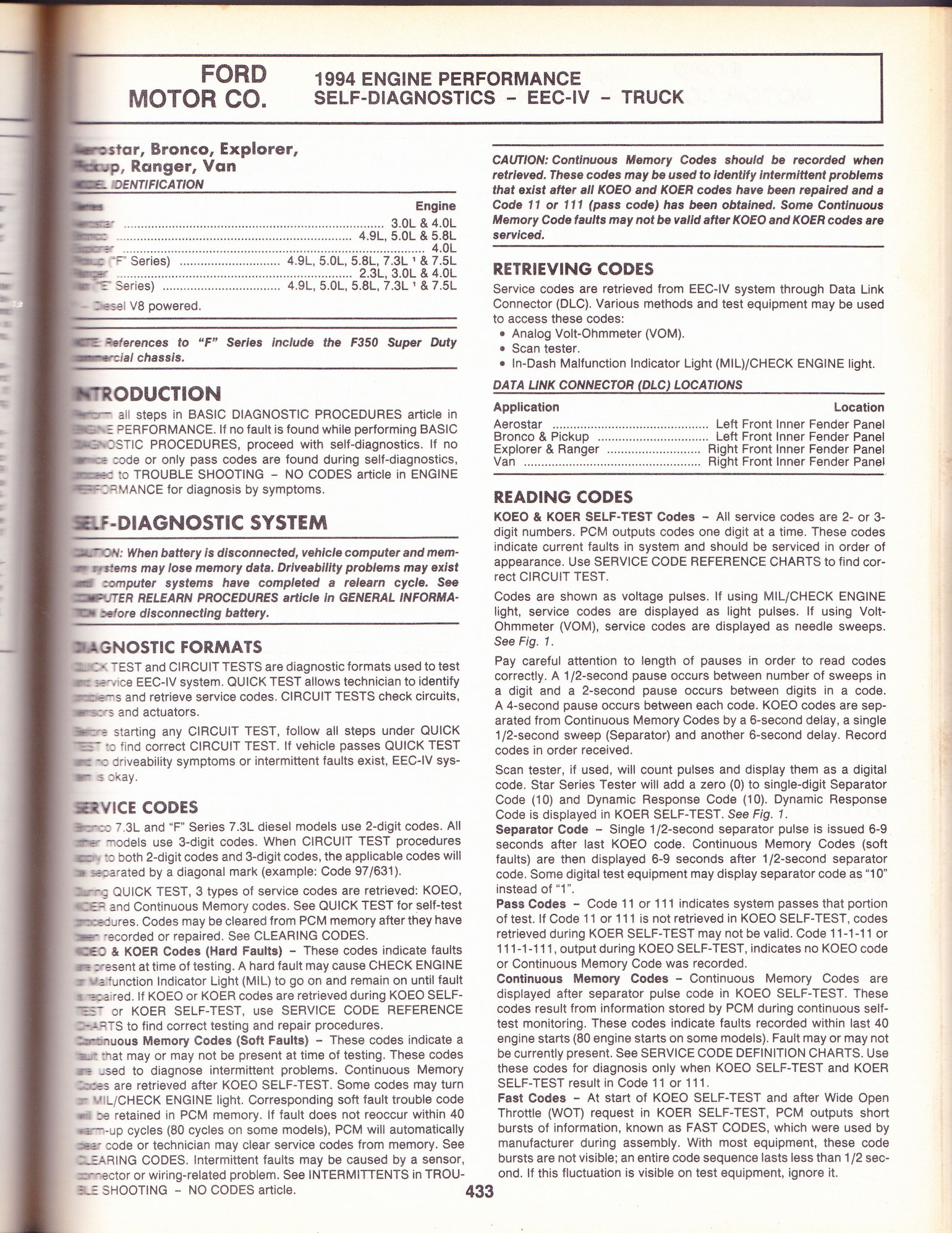

I still think you would have three digit codes not two.
I think those codes are all wrong.
There were no engine left that had a Knock sensor and two digit codes in 1994.
The one in 1994 that had the Knock sensor were three digit and the code was 225 for the Knock sensor.
Also the 5.8L engine like he has did not have a Knock sensor for any year..

I think this is what happened. He actually has two three digit codes both of which are real obd 1 codes and one for sure is for his 94 250 5.8. So, I think he had legit codes 122 and 565 ....... He wrote down 12-25-65........ 122 TPS low voltage... 565 canister purge circuit. Yes, I did run Scotland Yards in the 70's

Old Aug 12, 2017 | 09:55 PM
vjsimone's Avatar
vjsimone
Joined: Jun 2013
Posts: 3,174
Likes: 15
From: Somewhere n North America
FYI -
Looks like the 7.3 was the only configuration still using 2 digit codes in 94'.
