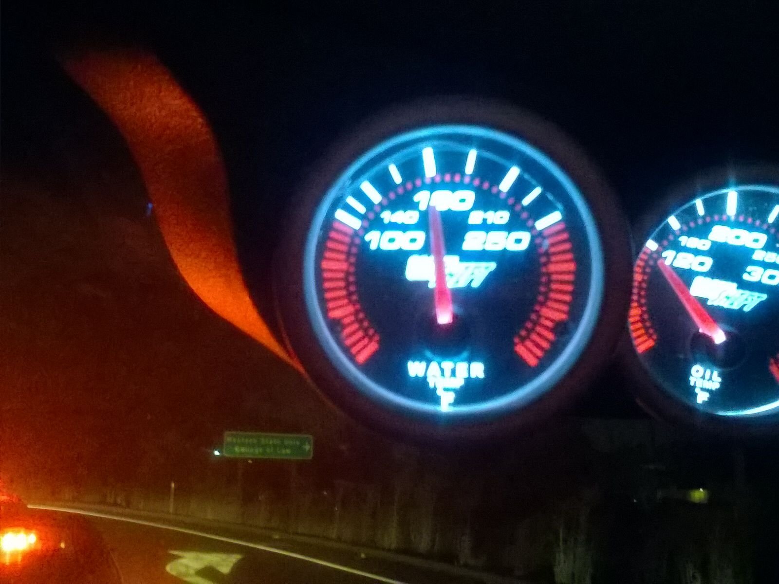

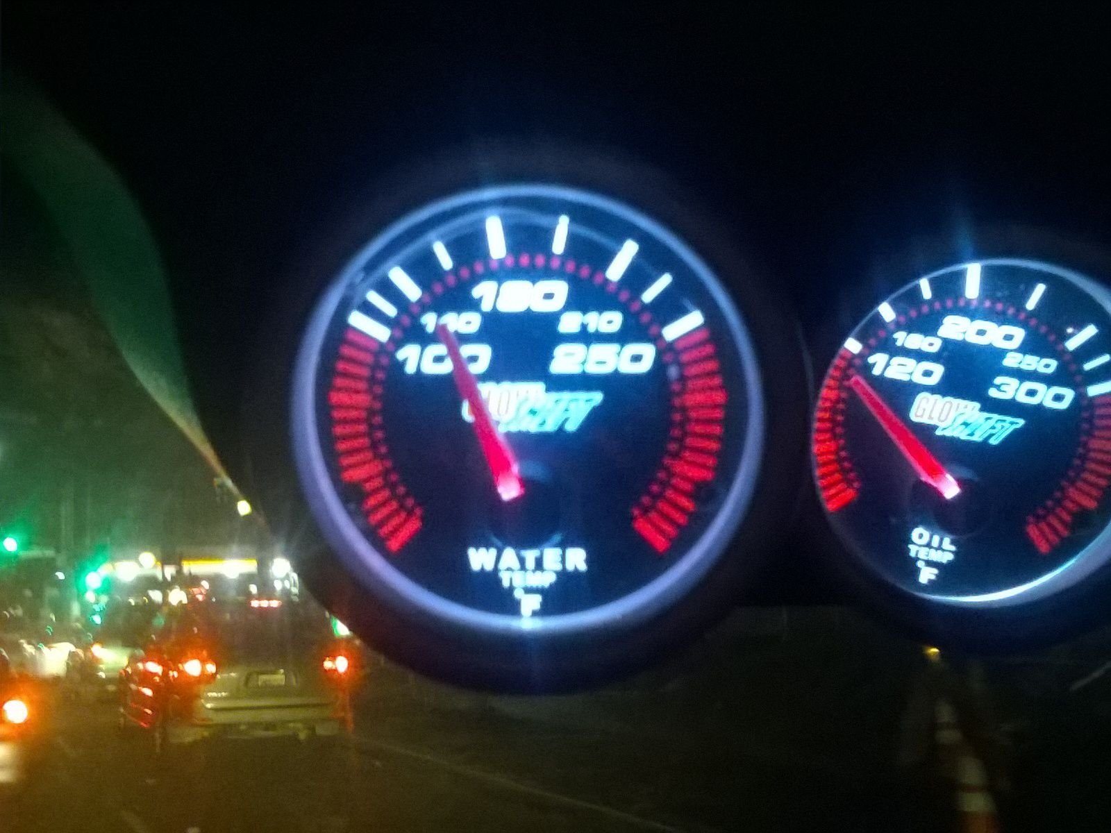

here's a few ECT from different times running, this past 2hrs..mind you, tuck had a 10min warmup 15min of city driving
45min city driving, ready to merge int freeway
180*, 1hr freeway driving, no traffic about 70mph
