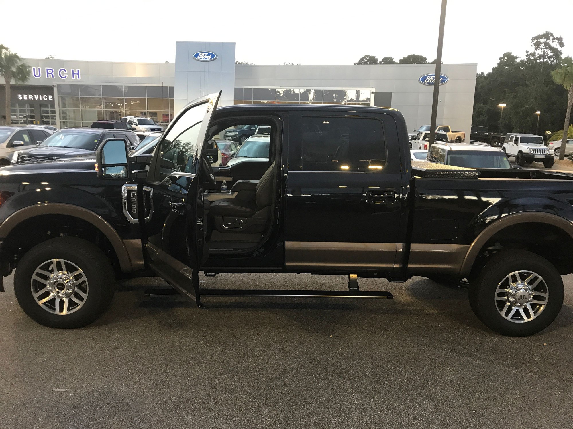

Today my super duty is going under the knife. Getting the wheels and tires and lift installed. Will be updating with pictures
current install list is a little modified but I'll explain why
BDS 6"coilover lift kit.
Fox 2.0 shocks all around
the coilovers are actually 8" coilovers because BDS is behind on making the 6" coilover. A Tech at BDS told me and the lift installer the 8" coilover is done but not released yet but will let me use them. Just adjust them to 6" the tech said in the long run it will be advantageous because the ride will be softer(idk how) also because they are behind on the 6" coilovers my 8" coilovers are coming with th DSC adjuster. No extra charge. Pretty excited about that!
Hypertech speedo calibrator!
they also just finished with the 2017 dual stabilizers so I am getting them installed also.
Wheels and and tires are 37x13.50r20 toyo mt and 20x10 -18 fuel beast. I wanted a little offset but not much because I am going to be driving down trails and hunting leases and don't wanna sling crap all up the side and scratch it.
Here is my truck(although some have seen it) for before and then after comparison
