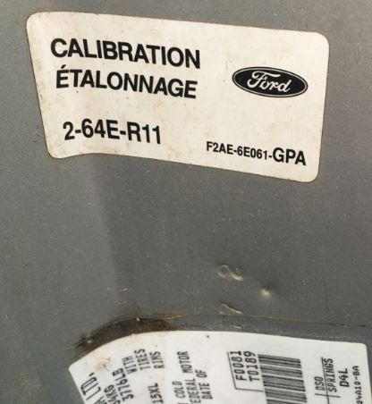

ECM - which version?
Can you help me out or point me in the right direction?
My truck is a 93 F150, 4WD 5.8L E40D transmission. HD front end. VIN 2FTEF14H0PCA28202

The post fix CC & MC can be for completely different PCMs.
With out your calibration code number off the drivers "B" pillar can not help you on the right PCM.

OK. Here you go. Thanks.

F2TF-12A650-CC is the right Engineering # for calibration code number 2-64E-R11.
The Ford Part for 2-64E-R11 number is F2TZ-12A650-CC.
This is listed on Parts List #252.

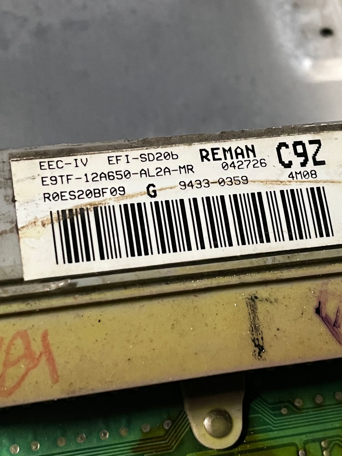

1990 F150 5.0 c6 ecm
I have a 1990 f150 5.0 that the previous owner swapped the rod to a C6 now it needs a new ecm.
replace with the same EcM or find one for the C6 tranny swap? Thank you.

1990 F150 ECM for a 5.0 with a C6
Originally Posted by Dealio63
I have a 1990 f150 5.0 that the previous owner swapped the AOD to a 1986 C6 now it needs a new ecm.
and the Rockauto vs advanced auto.
Old Mar 25, 2022 | 06:33 PM
Dealio63's Avatar
Dealio63
Joined: Mar 2022
Posts: 5
Swapped to a C6 from what transmission? What is the trans code on the sticker?
This is the current ECM The last owner just told me this tranny is an 1986 C6 and he used a ecm from a 1987. Lol. I will go look on the B post and take a pick. Thank you
9-54J-R10
