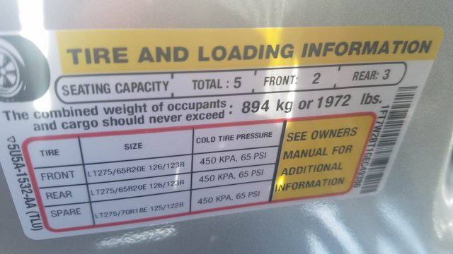

Your limiting number will likely be your payload. This is listed on your driver door jam yellow label. That number is the max total weight of passengers, cargo, 5th wheel hitch, dog, stuff you carry in the bed PLUS 5th wheel pin weight.
If your 2016 KR SRW F250 FX4 is a Diesel your payload will be around 2000 lbs.
Below is a payload sticker for a 2016 Platinum CCSB I looked at. I wanted to tow a 14000 lb 5th wheel with a loaded 2600-2800 pin weight. I would have been at least 1400 lbs overweight with this truck. That why I went with a F350 diesel with a 3500 payload.
Post your payload numbers and we can start recommendation from that number.
Here's a 2016 Platinum payload sticker.

As soon as I was done replying I looked at my sticker. Still confused. lol Here is my sticker:
Mine didn't seem to be as clear as your sticker. Looks like it's saying that the max weight on the rear axle should not exceed 6100 lbs. So if I have two 200 pound individuals in the front seats (400 lbs) would that take away from the 6100 or would that go towards the front axle of 5200 lbs? haha sorry this is kicking my butt.

Post your yellow Tire and Loading Information label on your door post.
The "The Combined weight of occupants and cargo should never exceed" number will likely be the LIMITING FACTOR and you should use this as a starting number.
For example. If that number is 1972 lbs as on my example
If you carry
400 lbs for you and your girlfriend or wife
200 lbs for 5th wheel hitch and firewood in your bed
Then that leaves 1372 lbs max pin weight for a 5th wheel trailer
1972-400-200=1372 lbs
Assuming trailer pin weight is 20% of the total weight of the trailer then max trailer you could tow and be below Payload is 1372x5=6,860 lb trailer.

One other factors for your F250 based on your white sticker are;
10,000 lbs limit total weight of truck, passengers, cargo, hitch and pin weight
6,100 lbs max on rear axle
5,200 lbs on front axle
15,000 lbs max loaded trailer weight of 5th wheel trailer per ford specs.

I'm sorry, I thought I had attached my yellow sticker. Here it is:
