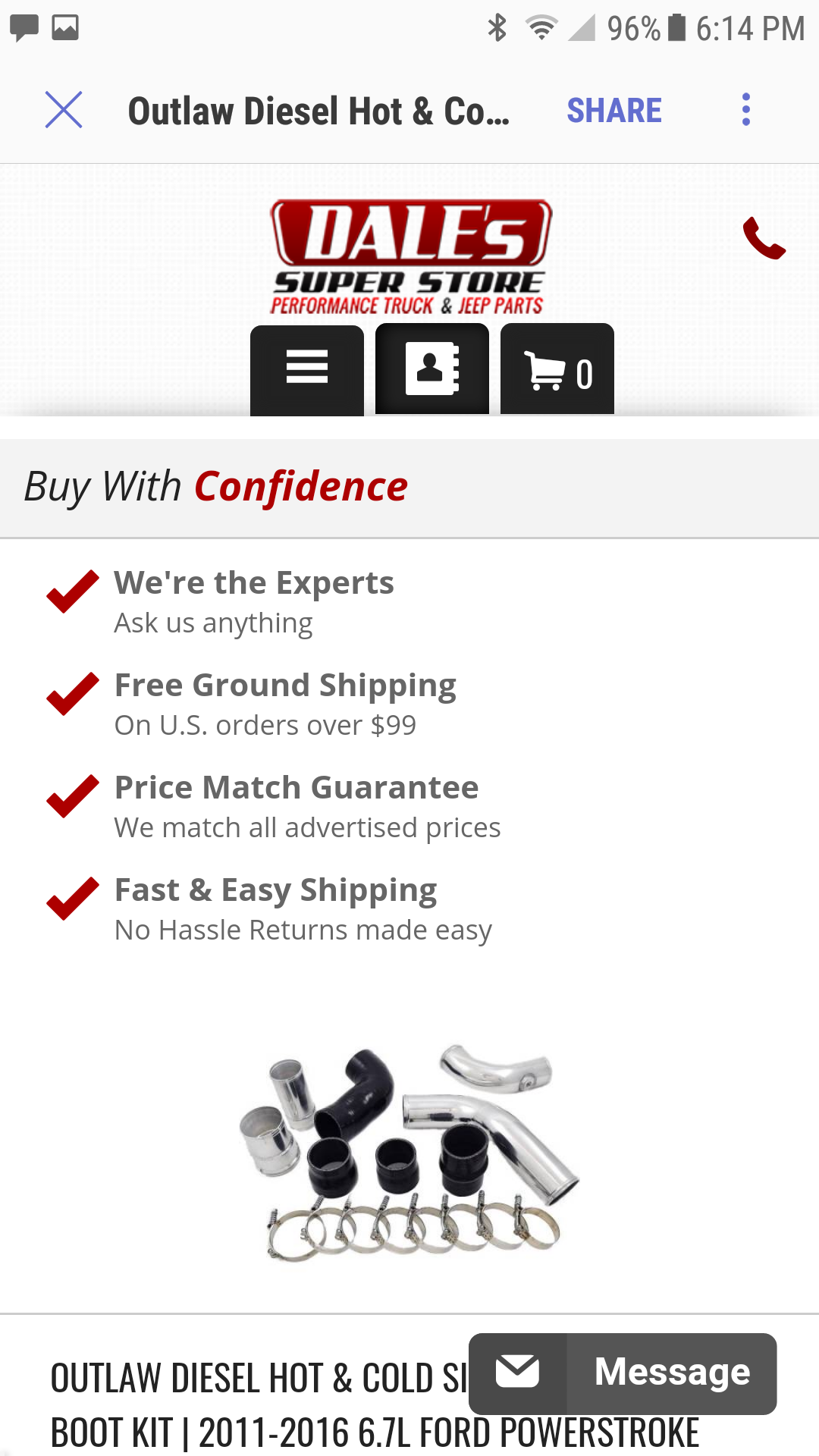

I guess my main reason for questioning I want to find out brands that people have used and are happy with also if people are changing their hot side as well as the cold or just the cold I know they're issues with the cold part and there are kids out there for the hot and cold like this company has anybody heard of them and are they reputable? Otherwise I may go with Rudy's just because of cost right now I would assume anything better than the factory plastic

This is probably a new one to most of us. The hot side pipe has never been a problem and the only reason to replace it is to have matching pipes. AFE is the only kit we've heard that leaks. Wrong sized clamps has been a problem for a couple of folks with the Rudy's kit, but that is easy to fix at the NAPA store.
