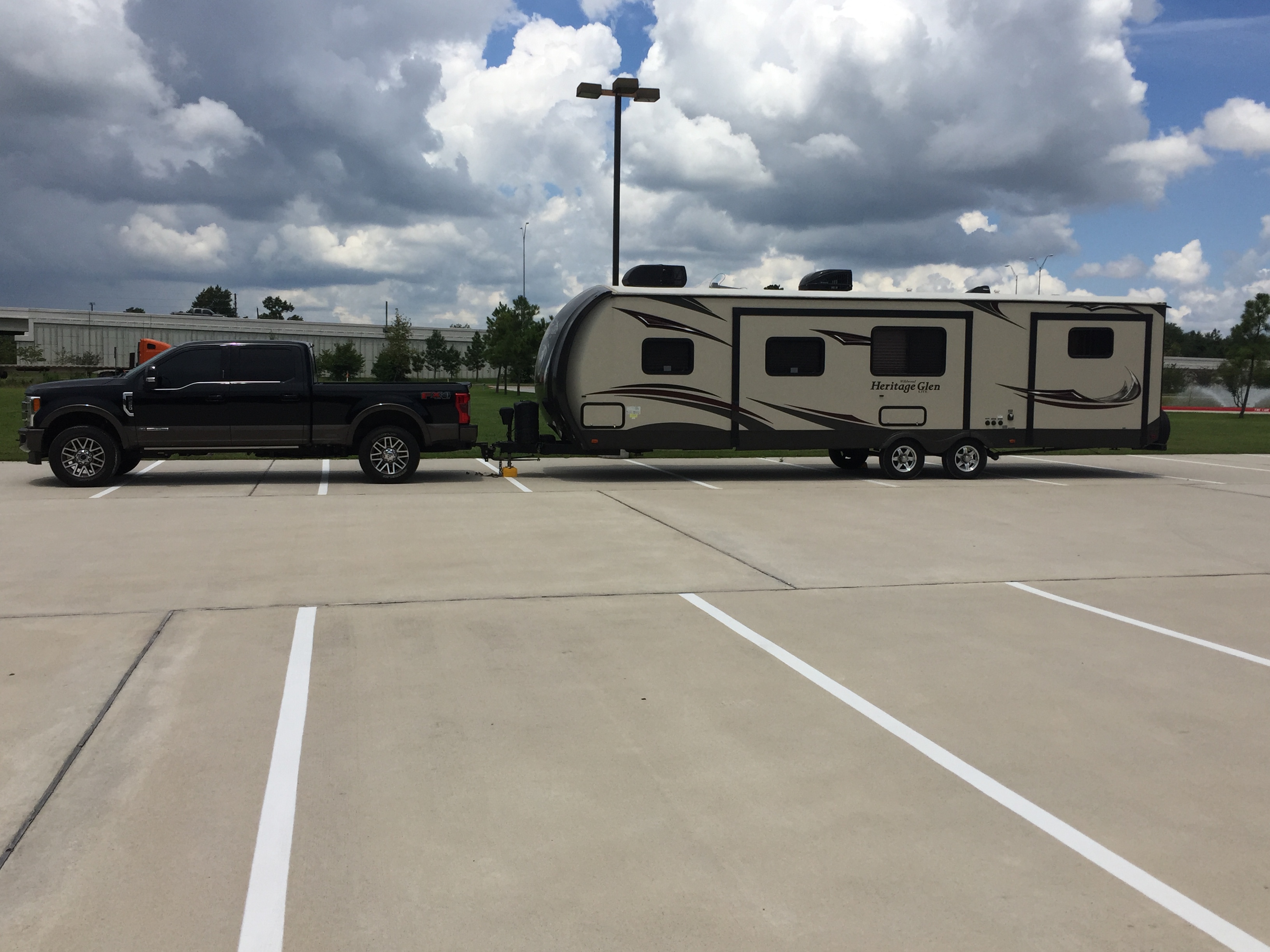

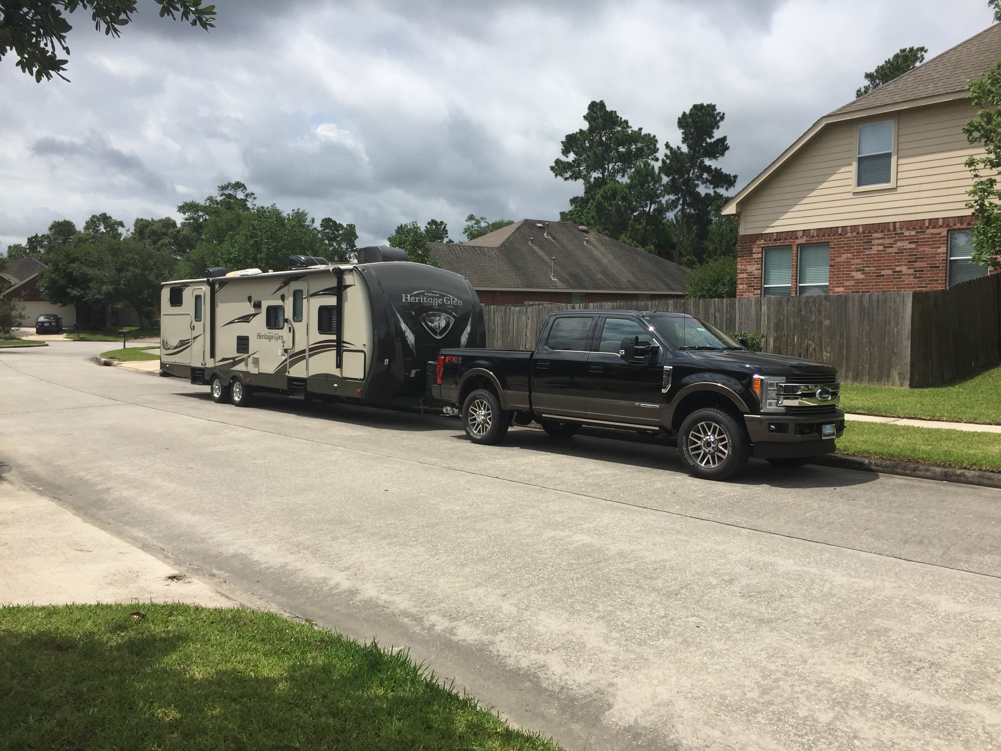

This is the one I test drove with very little WD appliedName:  IMG_2197.JPG
This is with the husky I had and the truck I purchased. Block under it due to all the adjustments I was making but is nit touching in the pic.Name:  IMG_2200.JPG
This is how it sits now. I've had the same issue with all 3 set ups.
