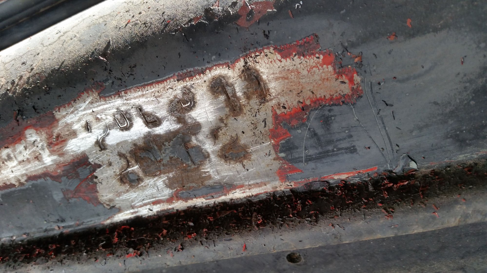

Here is my cab stamps while it was going down the assembly line.
Hi Lindsey, Welcome to FTE. There is a great forum post where we are building a data base of the Serial numbers and plant building stamps (Stamped right into the firewall). Like yours to be in the DB with all it's info. https://www.ford-trucks.com/forums/4...n-cut-off.html
