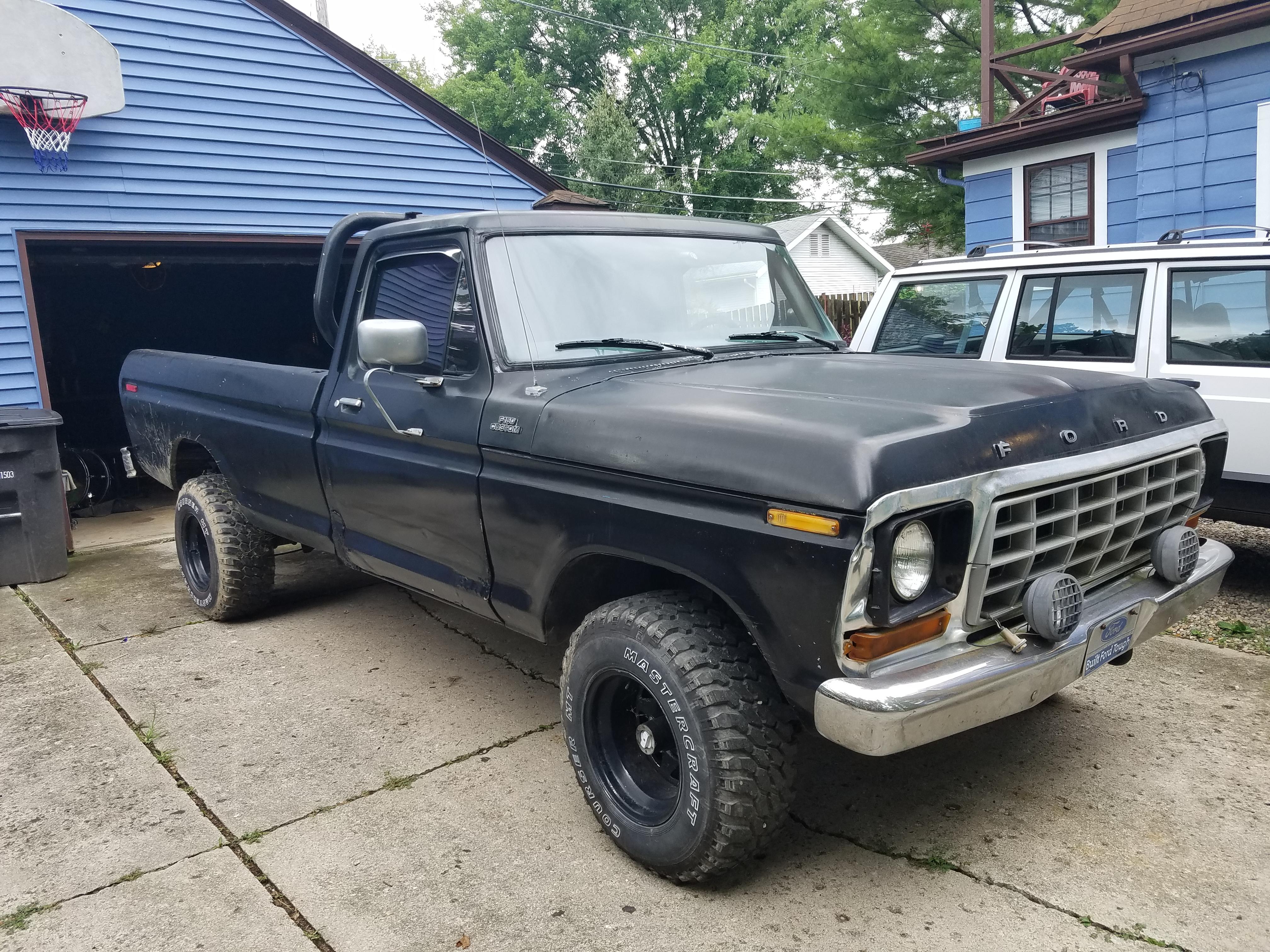

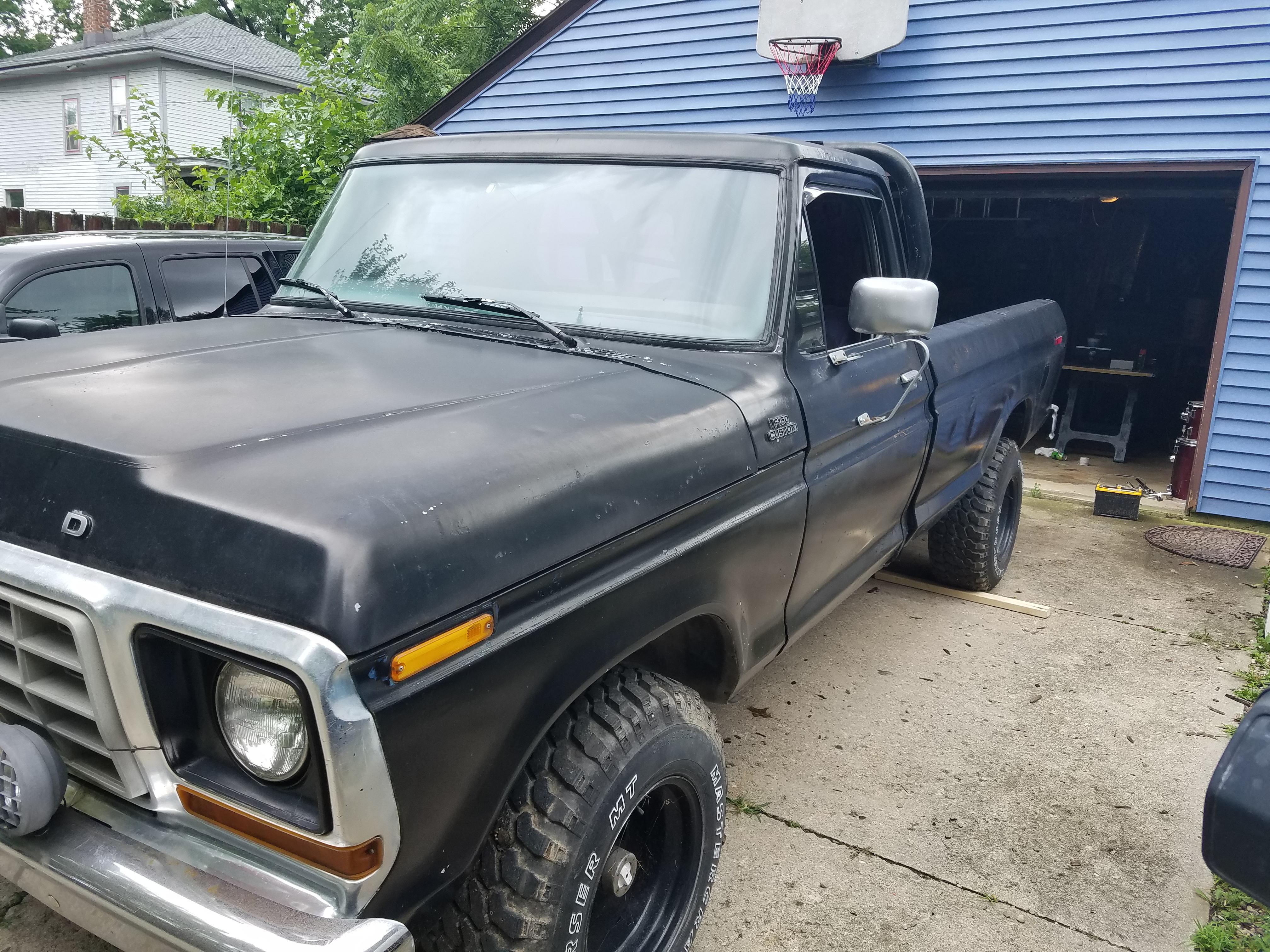

Hello everyone time to jump into the deep end with this one. This will be a family project for sure my wife and I both have good memories of these trucks both our dads had one like it when we were kids. Now we have two teenage boys (16yr and 13yr) that will enjoy this also. The boys like the truck and the ideas we are talking about as a family we all are looking forward to this truck and will be working on it over the winter.
I have been looking for a while for a nice project and I found this 1978 Ford truck on Craigslist for $1,500 asking price. So checked it out and saw the extras talked him down to $1,100 and I'm pretty happy at that price. To get it home I had a flatbed tow it the 15 miles because it was cheap and much less stress then driving it, $70 was a good deal I think.
The truck came with a extra set of doors with glass, front grill and passenger floor pan(need that for sure)
My goal with this truck is make a fun driver, might not make it a daily driver but I want that option. I don't plan on doing major off road stuff or lifting it, but I want to be able to pull anything I need to so will do some engine upgrades and maybe gears. I do want a nice growl from the V8 and if I can leave some black marks on the pavement that will be nice too. I told my boys it will be for fun so we all will drive it like we stole it and when we break it we will fix it and do it again.

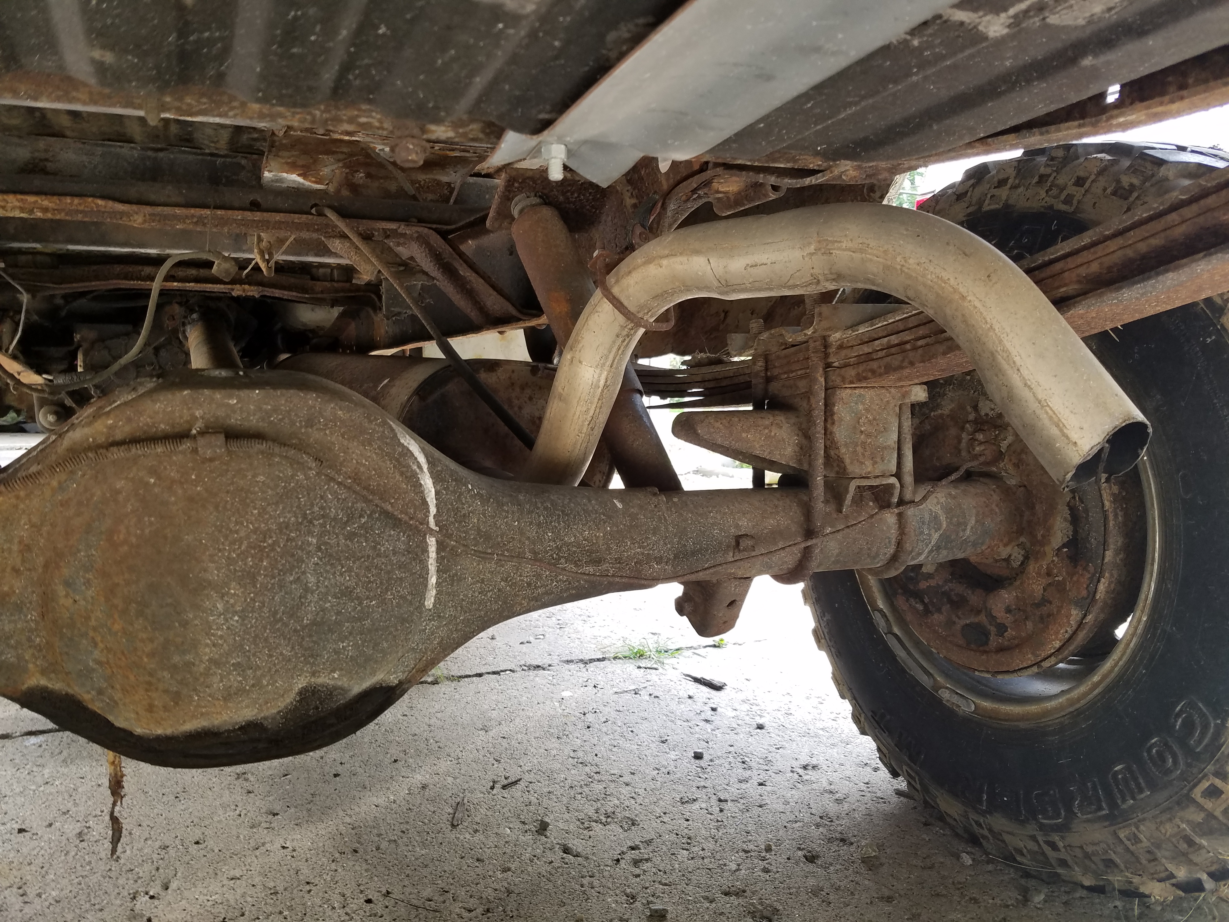

Help me ID the axle and Transfer case please.

And can anyone tell me if this is factory or has someone lifted the truck?

I found a axle tag while cleaning out what is left of the glove box. The tag is hard to read but I think it says. Not sure what all the numbers mean so any help would be good.
WDM CR 8LA
350 9 622A
WDM CR is listed 79 Ford Bronco
8LA = No idea
350 = 3.50 gears
9 = 9" axle
622A = No idea
That is based off this info.
http://www.fordification.com/tech/rearends_ford03.htm
I can tell someone has opened the axle at some point and for what ever reason they didn't put the tag back on. Maybe they swapped gears or something so I will have to decode that stuff later. All that is for a later date.

I'd say the front axle is a standard Dana 44. And x2 on those are stock factory rear blocks. The inside tab is for your frame mounted rubber overloads to rest on when it is pilled up with fire wood.

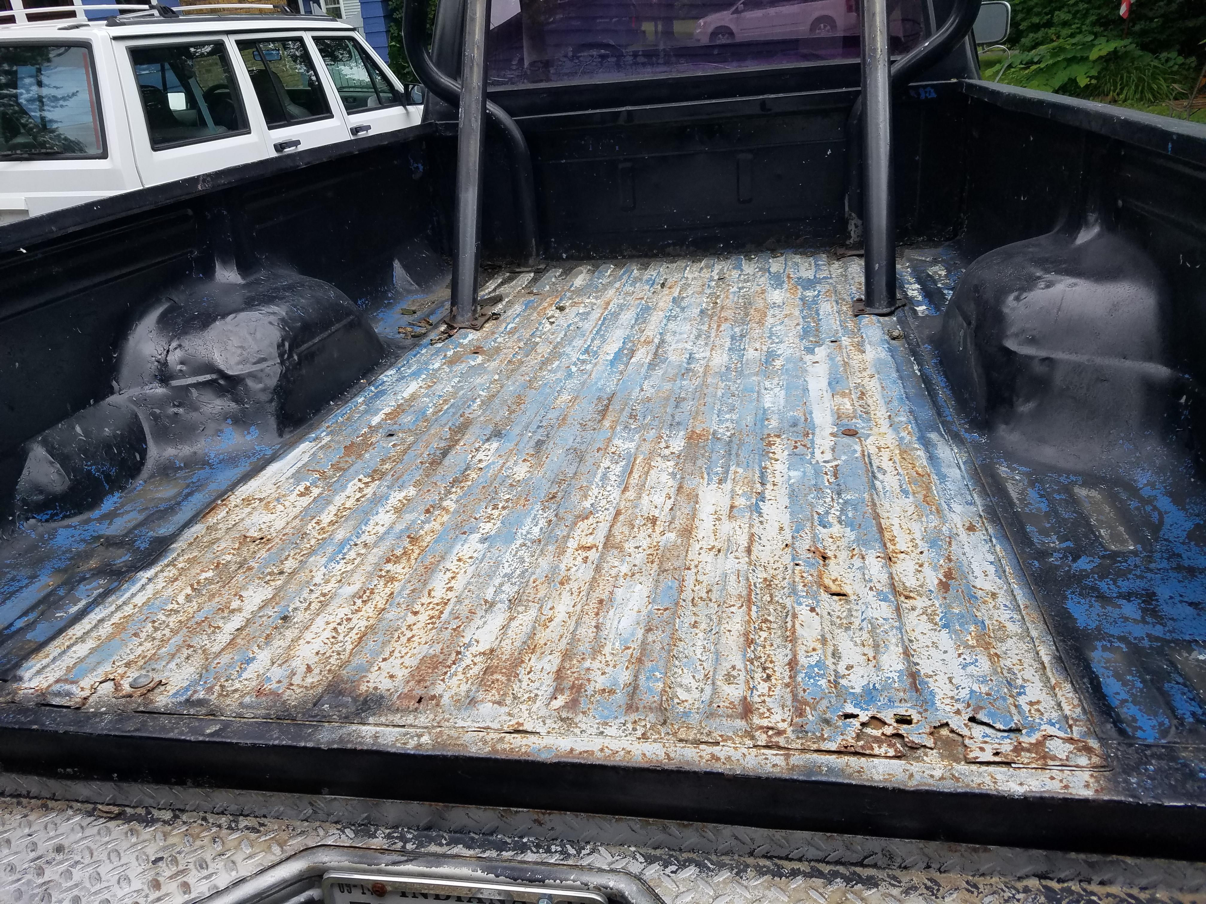

So looking at the cab I could tell it would be much easier to pull the bed off and fix the back of the cab then try to work around it. So last night I pulled the bed off.
The bed has been replaced before and it was nice of the person to only put 4 of the 8 bolts back in. That made it easier to get it off. I removed the bolts ratchet strapped the bed to the ceiling and rolled the truck out from under it. It wasn't as easy as it sounds but got it done and no one got hurt.
On the plus side the frame is in great shape just a little light surface rust and lots of nice black paint. I really believe someone started a full restore on this truck not too many years ago.
