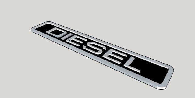

Whipped up a 3D model so we can have these made again - I've been searching for one of these emblems for years with no luck. Not that I am a fan of LMC but i couldn't find it in their catalog, nor NPD. I'll get with my parts guy today and see if there is any old stock floating around the country anymore, and to get a good part #.

How did you get the correct font?

Measure, measure, measure. The smaller horizontal lines were all 1/16" tall, the wider vertical lines all 1/8" wide, and all the letters had an 1/8" spacing. Letters were all 1/2" tall, too. The inside curves on all the letters had a 1/16" radius and all the outside curves had a 1/8" radius. It all just kind of falls together when you look at it.
