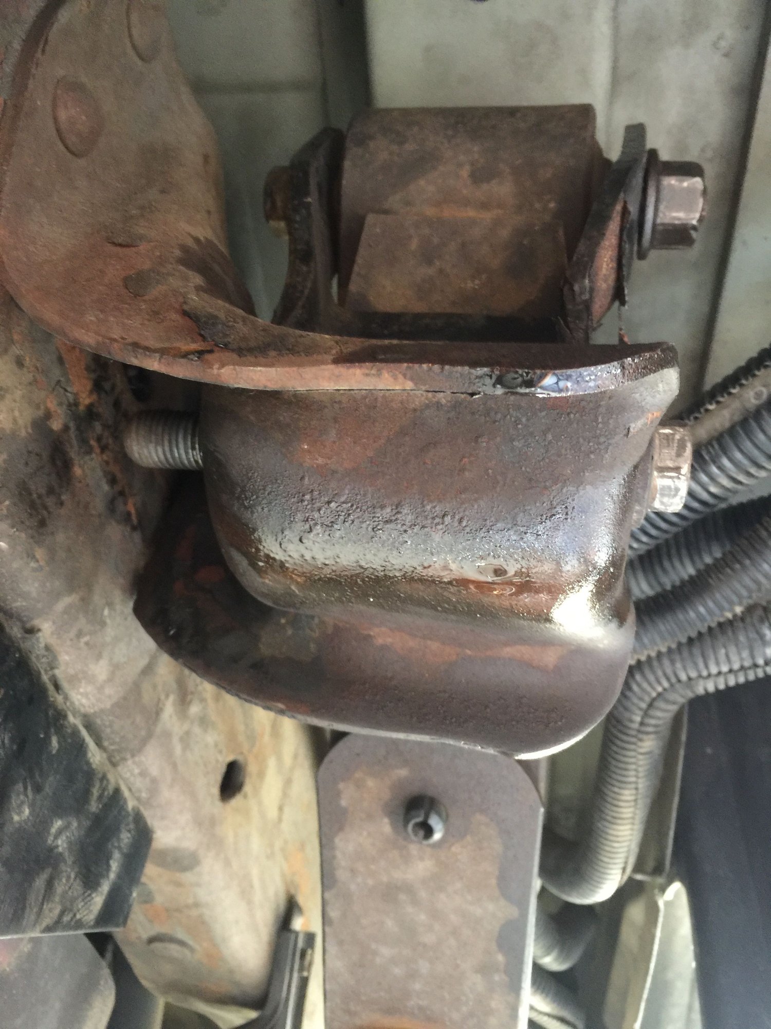

I'm trying to remove the rear springs and I can not get the rear bolt out because it hits the frame (the nut should have been on the inside of the spring, not the bolt head). I thought I would just remove the shackle but I can NOT get the bolt out of the shackle. I got the nut off of one side after a long time of grunting, cussing, straining, etc... The bolt will NOT come out and I am now stuck... I tried to give myself a break and work on the driver side but the shackle is damn near impossible to turn (like the passenger side was). Yes, I have heated, PB Blastered it, waited, repeated, etc... I'm seriously stuck and can't continue due to this. ANY help would be greatly appreciated. Thank you!!!

It's been a while since I did this, but as I recall, I removed the lower shackle bolt, not the upper one for the very reason you state. The lower bolt has it's nut next to the frame so it can be removed much easier. Thus the spring will come out with the rear shackle attached. Once off the truck, you can easily remove. Anyway, that how it was on my 2000.
See pic below from my C mod spring install.
If I'm misunderstanding and you are working on the lower bolt and it's stuck in there. Overnight soak, then try again in the AM with your air wrench. Last resort; blue tip wrench and find a new/used shackle.

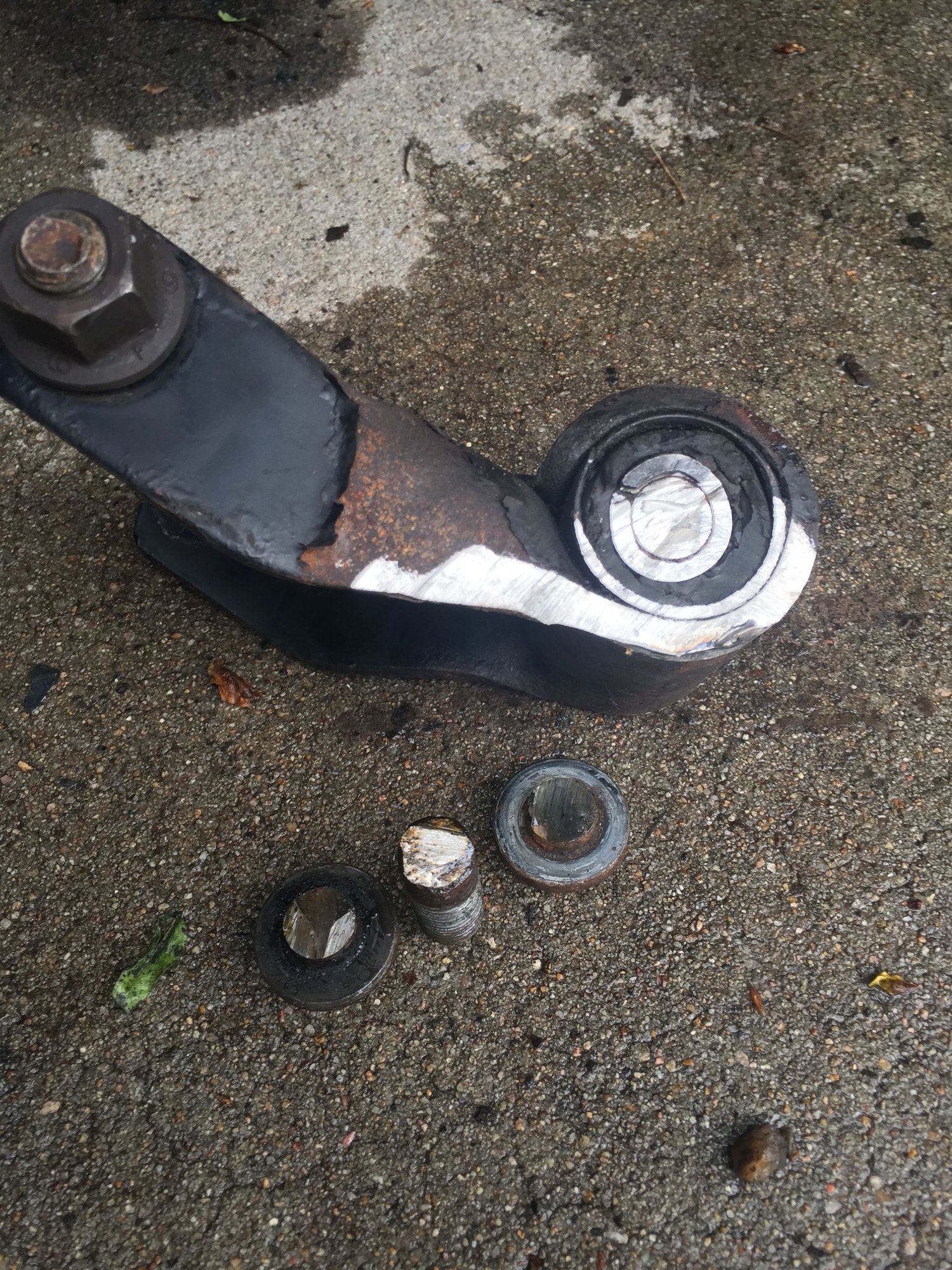

Tried prying, spinning, hoping, praying.... had to resort to Oldguyfl's suggestion - cut... 4" grinder and the passenger side came off pretty quick. Driver side, not so much. The inner side of the shackle between the hanger and it doesn't give the grinder enough room... Gonna try a 5" wheel... New shackles purchased.

Sometimes you just gotta do what you gotta do. You might have spent 2 days getting that sucker out of there.
Your time IS worth something !!

Since you are buying new shackles, cut the shackle 90 degrees a few inches down to where you are now. Then the spring will be out of the way and you can do what you did earlier
