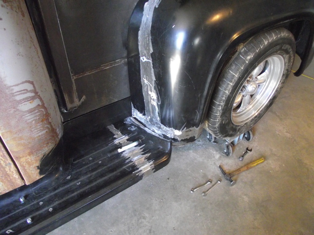

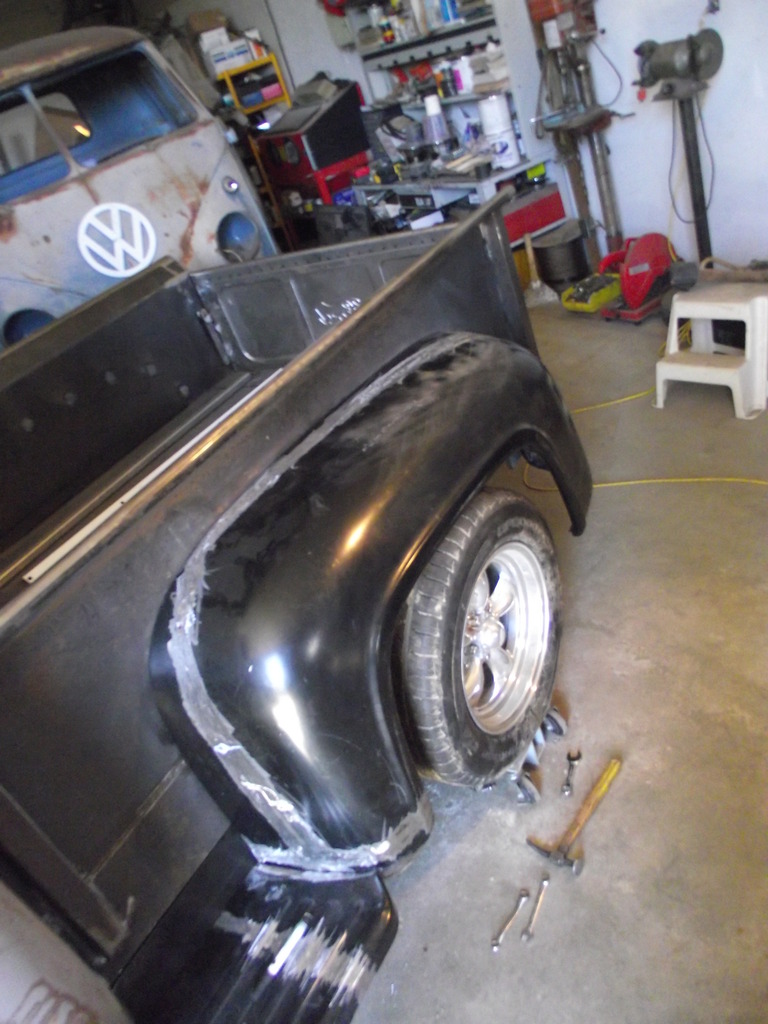

We used pie shaped wedges to widen the rears, these are the best pics I have. Worked out well.

I've got a couple of pics. of the long pie-cut method. I think they only cut the top and back, and just past the curve on the front side. not my pics.
