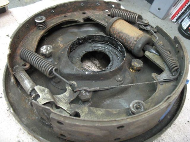

Here's a photo of what I have. As Bill mentioned, no part number stamped just an ID number. I guess you could look at your other side and see if it has the same number (316628 L) followed by "R". I'm sure this is left, unfortunately, I can't be sure if it's F100 or F250, as I have parted both trucks. Maybe Bill can shed some light on the difference. The brakes are 11"x2" and the backing plate is 12" overall. Also, do you need any of the shown mounting or brake hardware?? Pretty sure, I'll have a spindle too....but I need some way to ID it.
This is the manufacturers number, it's not FoMoCo related.
I could not find this number in the master cross reference: Ford to Manufacturer/Manufacturer to Ford .. part numbers section of the 1964/72 truck catalog.
11" x 2" front brakes would be 1967 or older.

the brake set in the pic i believe to be correct - its a spitting image of the r/h side and the measurements do match - let me know how much $
