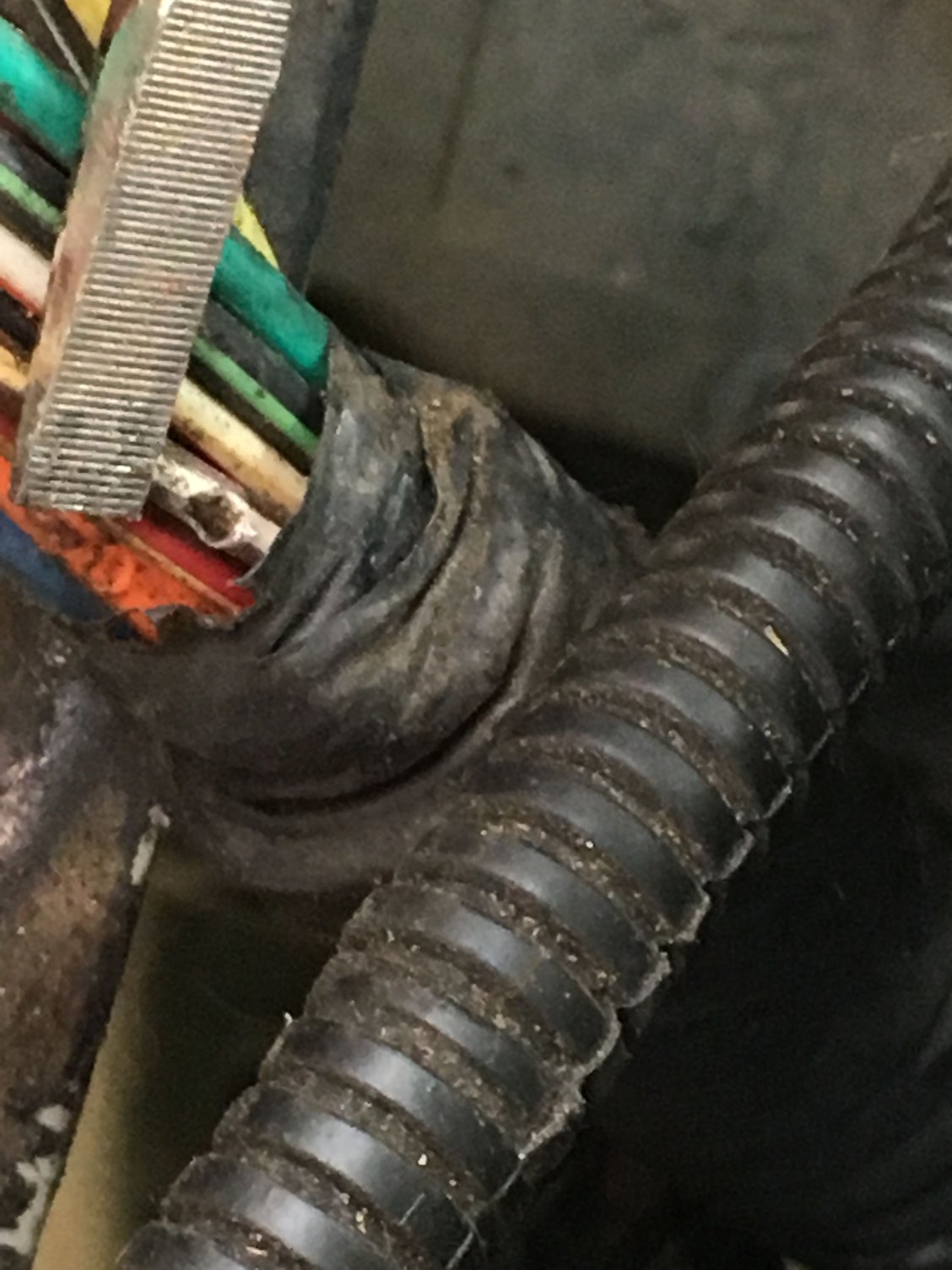

Ok update time.
For about 2 weeks the problem was gone. Then it came back today. So I went ahead and traced out the wires for the connector going from the back to the front. Well underneath the air filter box is were the went into another connection and sure enough tone of the wires had been rubbing on the metal bracket and had exposed the wire. What I think cleared it for the two weeks was I had changed the air filter so I may have moved those wires just enough so they did not ground out but after driving around eventually touched again.
