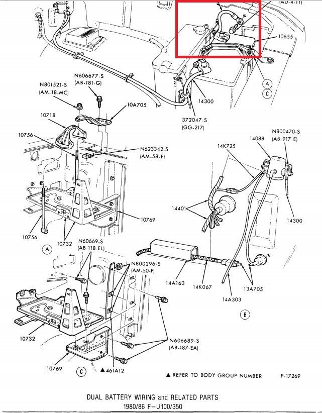

Yes, I'm asking for part number help. Or, at least a picture. Let me explain.
I got the auxiliary battery tray mounted on Big Blue today, and then mounted the coolant recovery reservoir to it, as shown below. But, that leaves the reservoir sorta hanging in the breeze, with a bolt on one end and the pin in the middle. Just seems like it needs something where the red arrow is.
So, I went to the parts catalog and looked closely at this page that shows how things mount. And, in the red rectangle you can just barely see something that might be what I'm talking about.

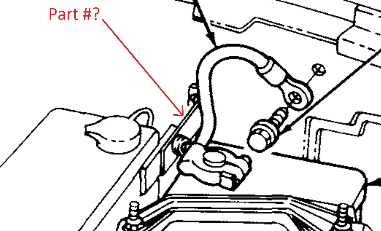

Here's a closeup on that part, blown up to 800%. Does anyone have one in order to look for a number on it? Or, at least get a picture of it? I can probably make something, but want to make it somewhat like the original if possible. Thanks!

Go to ILL for PN Basic 17618 (Washer Reservoir) and see if there is an install Ill there.
The PN may also be under Attaching Parts for Basic PN 17618 and/or 16138.
EDIT -
I see the reservoir also contains coolant. Also try ILL for 8A080 if not found @ 17618.

Thanks, but I've looked at all of those illustrations, and there are many as Ford had several different reservoirs. But none seem to have anything that looks like what I need.

Usually @ the end of a MPC TEXT Basic PN application, there will be usually listed ATTACHING PARTS, i.e hardware and the like. Anything after any of the Basic PN's 8A080 - 17618 - 16138?
EDIT -
There is also an Alphabetical Parts Listing @ the front of the TEXT Catalog. Maybe you will get lucky.
Now you see why the MPC had it's shortcomings.

I think I've found it, with your help. Unfortunately it appears to be no-longer available. But, now I think I know what it should be. I think, because there is no illustration in the catalog for that part on an 1980-86 F-series truck.
Are you talking to me... ?
Anyways, how did you finally come across it? I need to know.
Dealers need qualified parts salesmen you know...
I think you are like me (well I hope not as I am CDO- correct alphabetical order), it has to have an OEM appearance.
Do I feel a trip to a salvage yard coming up?
Old Jul 4, 2017 | 08:42 PM
Gary Lewis's Avatar
Gary Lewis
Joined: Jul 2010
Posts: 32,875
Likes: 48
From: Northeast, OK
Yep, talking to you. I took your advice and looked at the illustrations on the coolant reservoir. In those the brackets are usually "17651". I have my catalog OCR'd so I searched for 17651 in the Text section and there it was. Then I went to the Illustration section and searched for every use of "17651". None of them were for the 1980-86 F-Series gassers with an auxiliary battery, which is why I can say that there is no illustration depicting the part I need.
