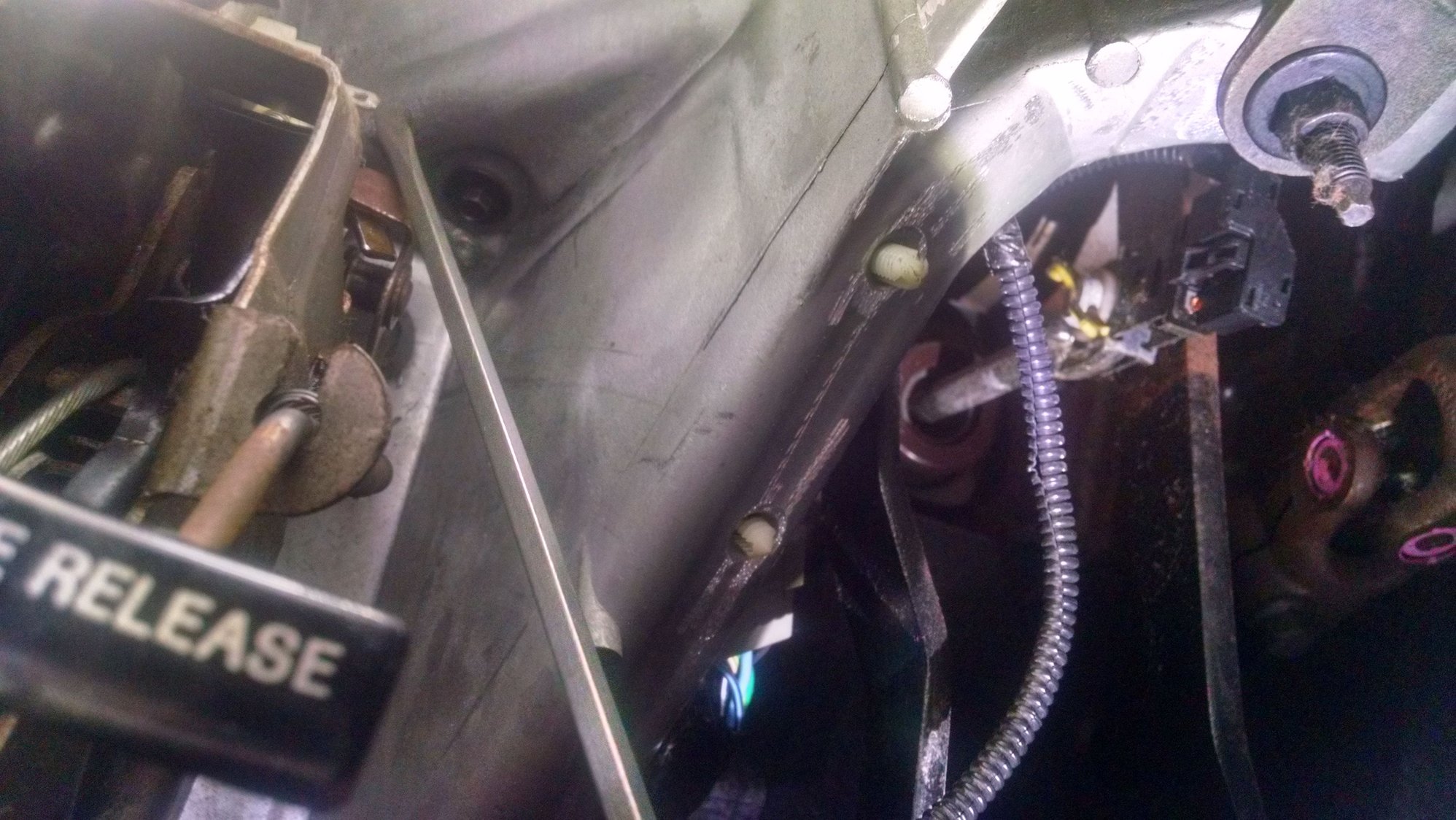

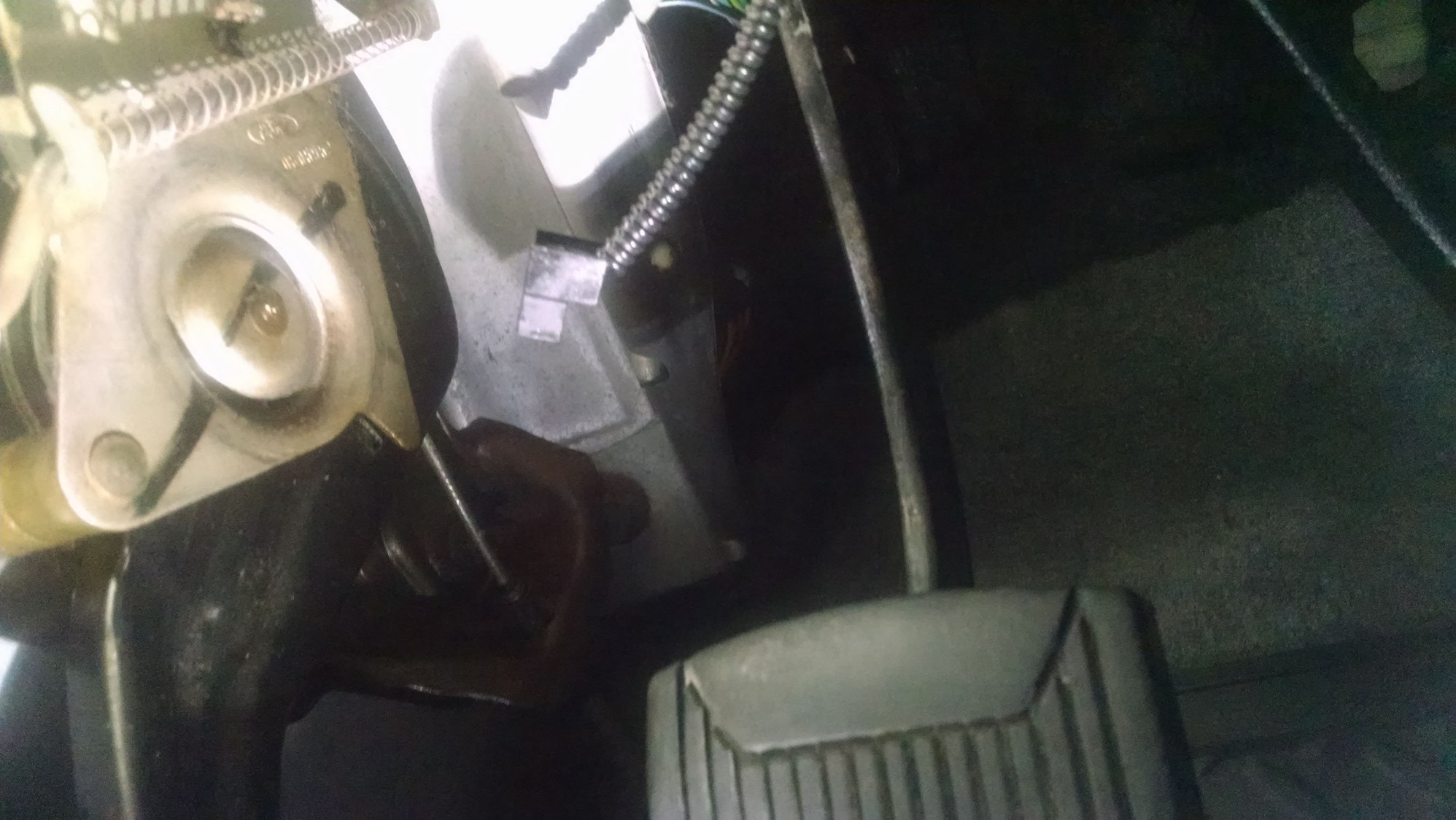

This single prong plug was hanging under my dash. Anybody ID it? In the next picture the only connector I can see that it might go to is at the end of the screwdriver above the PB release handle. The PO installed an aftermarket radio so this may go to the original? Any thoughts? Thanks Sandy

I'm not sure what the PB release handle is, but I am almost positive that wire goes to the emergency brake switch.

PB=Parking brake. Yes the screwdriver is pointing to the connection right above the parking brake. The wire wants to go in that direction. What is the purpose of that emergency brake switch? Thanks Red. Sandy

I believe that switch is for the dash light for your parking brake. Do you use your parking brake? If so, does the light come on when you do?

You are absolutely correct. I hooked it up and the light came on the dash. I never knew it had a light. Thanks again Red. Sandy
