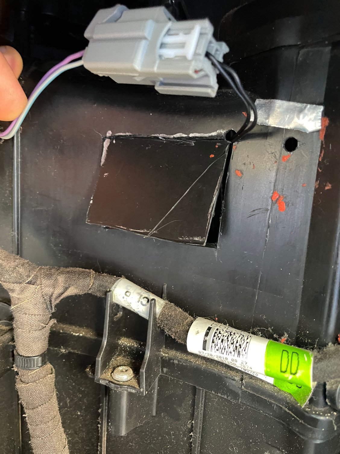

I ended up replacing the evap temp sensor, cut a hole in the plenum and swapped it. Then a year or so later had a leak in the evap and had that replaced.

Just a follow up, I hooked up to Forscan and the Evap. Temp. Sensor was showing -1degee Celsius and it was 90 degrees F. I replaced the sensor using a hole saw method so I didn't have to remove the dash. It works like a champ now every time!!
