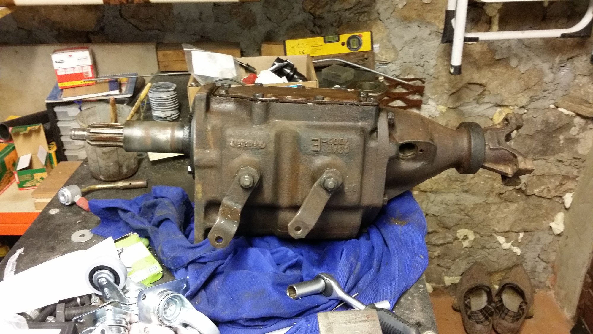

Hello, salutations from Spain. I recently acquired a transmission for my f100 of 56. It is the one you see in the picture I think it is 63 or 64 three speeds synchronized. I have to buy the pinion and the cable of the speedometer but I do not know what it is. some help? Thank you

Ford type 3.03 3 speed manual all syncromesh trans introduced in 1963.
1963/79 Ford/Merc Passenger Cars; 1963/86 F100/250; 1965/87 E100/250; 1966/77 Bronco.
What is this pinion you're asking about?

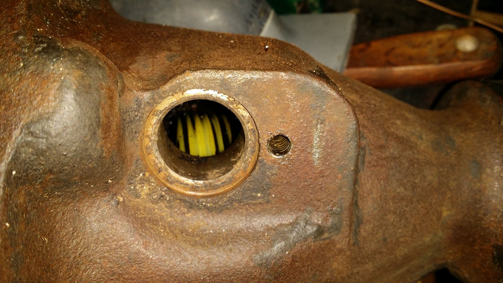

I was referring to the speedometer Drive n gear (17271) and the cable. (17262)

Speedometer DRIVE (on the output shaft) & DRIVEN (at the end of the cable) gears: Rear axle ratio, tire size and transmission type must be known to get the correct parts.
Trans is the Ford 3.03 3 speed, what is the rear axle ratio and tire size?

The formula for caluculating the driven gear number of teeth on the speedo cable is as such
# DRIVE TEETH x AXLE RATIO x TIRE REV. PER MI.
_____________________________________________ = # DRIVEN TEETH
1001
To calculate tire revs per mile
20168
_______________________________ = REVIOLUTIONS PER MILE
TIRE DIAMETER (in inches)
The yellow drive gear is 7 teeth if I remember correctly and it appears to have 7 teeth in your pic. ND will correct me if I'm wrong.
So with that
We know the tire diameter is 28.89"
So 20168 / 28.89= 698.096 And round to 698 Revs per mile.
Knowing that we can use the other formula
7 x 3.92 x 698 / 1001 = 19.13 and to round it to 19 So you need a driven gear with 19 teeth.
This is the one you need.
Ford - Ford Pickup Truck Speedometer Driven Gear - 19 Teeth - Plastic | B5A-17322-C - Macs Auto Parts
Hope that helps

The Drive gear Is white 6 teeth.
Thank you very much for that information but that piece is like the one that now mounts my transmission of 56 and the box that I am going to mount is the one of 63. I think they are different gears and that is one of my doubts. I also have to buy the cable and I do not know which is correct. A little more help? Thank you
