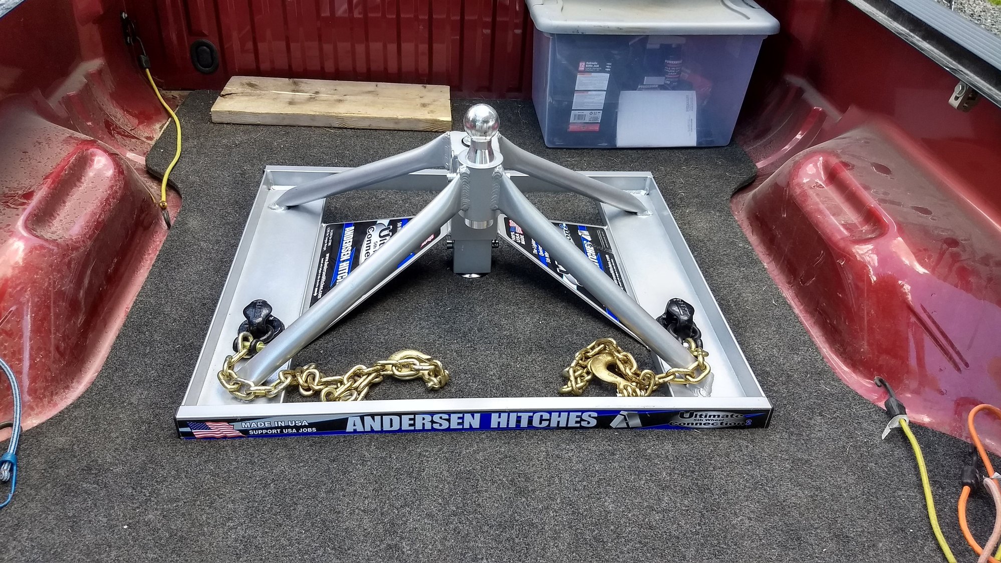

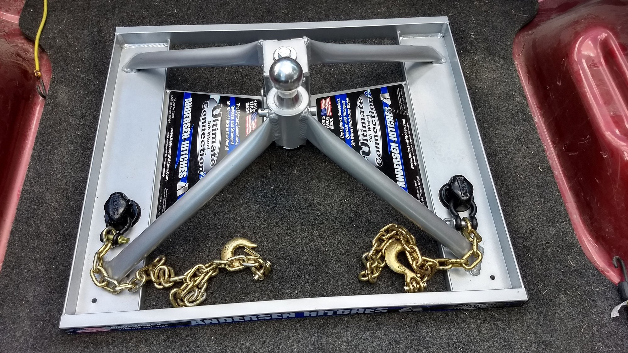

I cut 3" holes in the base of my 3220 today for access to the Reese safety chain loops and got the safety chains installed.
Reese puck safety chain loops through 3" holes in the Andersen hitch.

I like how you did the safety chains. Any hints, tips or tricks ?

I used masking tape on the truck bed to outline the installed hitch. I then removed the hitch and measured puck centers then used those measurements to drill the holes.
I seem to remember the puck max diameter was 3 1/8" so I drilled the holes 3.1/4" to give some room.
Verify your measurements. Some members have reported Slight differences where my 10 1/16" measurement was 9 7/8" on theirs. The 3/16" dirrerence could be attributed to how the hitch was installed, fore and aft before it was torqued down.
Directions state to push the hitch as far back towards the truck cab before tightening. I didn't do that, I just squared it up before tightening it and measuring for holes. That could account for the 3/16 difference. There's enough slop on the hole size so that mine fits which ever way the hitch is biased.
Here is my diagram.

The safety chains are not required and Ford and Dodge have different puck systems so it would complicate a simple system. It is easy enough to use a hole cutter to make the holes if you desire safety chains. FWIW, I cut 3" holes, it was a little tight so I used a half-round ******* file to elongate the holes slightly. 3 1/8" would be perfect but I couldn't find saw that size.
