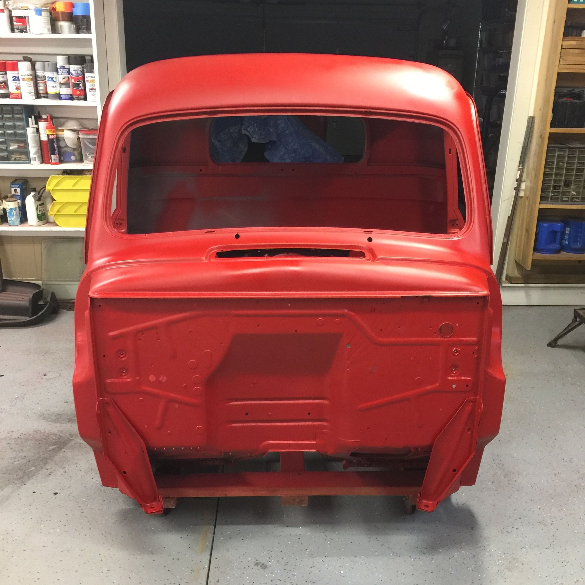

I am a novice painter and am using Hot Rod Flatz Hot Rod Red from TCPGlobal with an HVLP paint gun. I'm using their recommended mix of 4-1-1 and with 1 ½ quarts I was able to cover the cab inside and out and the front half of the box. So I would estimate that a gallon should do the whole truck. I buy their kits which come with hardener and reducer. If you need more TCPGlobal ships quickly and you can buy another quart kit and get it quickly. If you want a gloss finish they sell that too or you can shoot a high gloss clearcoat over this afterwards. This is nice paint and goes on very easily with good coverage.
