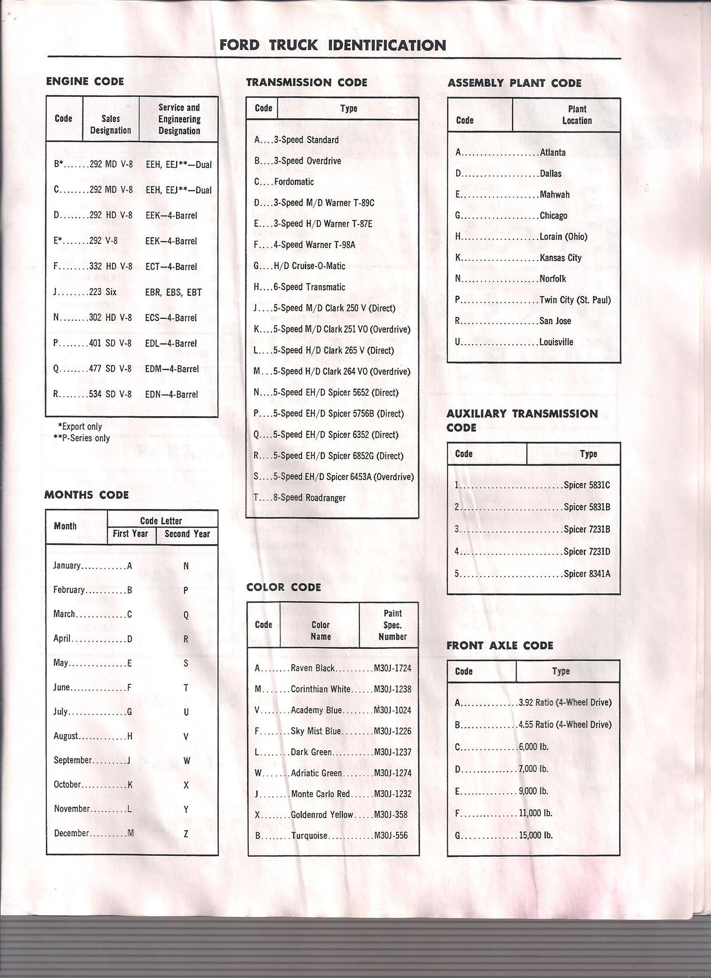

Many thanks for the replies, is there any way of getting this info in print like a scan of the source page from the 1960 Ford truck shop manual.
As i need genuine proof of the build date to register my truck in the uk.
Again many thanks for the info.

Here's a scan from my '60 shop manual of the date info; bottom left.

many thanks, that should do it. I also took your advice and got the cd, it will come in very handy.
