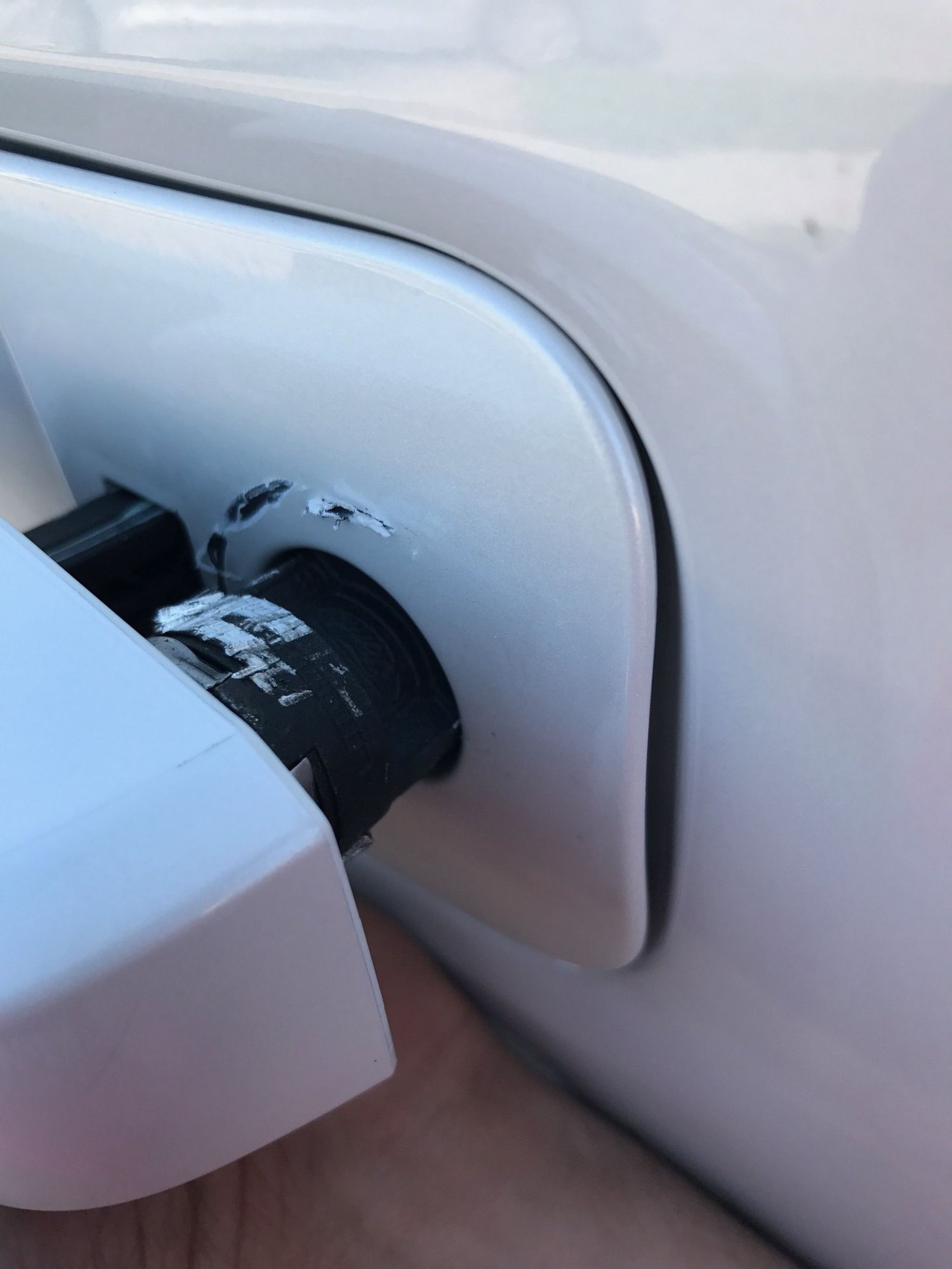

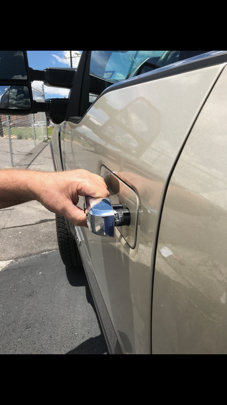

I posted in another post here awhile back about a San Antonio break in. On his...they used channel locks to "twist" the cylinder with the handle pulled out. If you look at the two pics above...that's exactly what they did. They are pulling the handle out...putting channel lock on the cylinder and twisting it to open the door. The alarm does not go off because it thinks the spare little key hidden in the key FOB has opened the door via the key hole. I'm surprised in picture one that the even caused damage to the plastic. Here's a pic again of my friends. Also...YES....everyone on here should do the back handle to front handle switch which eliminates the cylinder and key hole. It's called shaving the door...or door handle to No Key Entry. Only FOD and manual key pad on pillar will open for you.

Yes that's where mine was. Not sure how to get another and how to have the factory one changed. I did manage to take it apart and get everything working temporarily until I can get a new handle trim piece. This is the dumbest design I've ever seen. Just asking for it. I put my handle back in and left the rod that goes to the lock cylinder disconnected so if someone does it again it won't open that way. Here are some pics.
