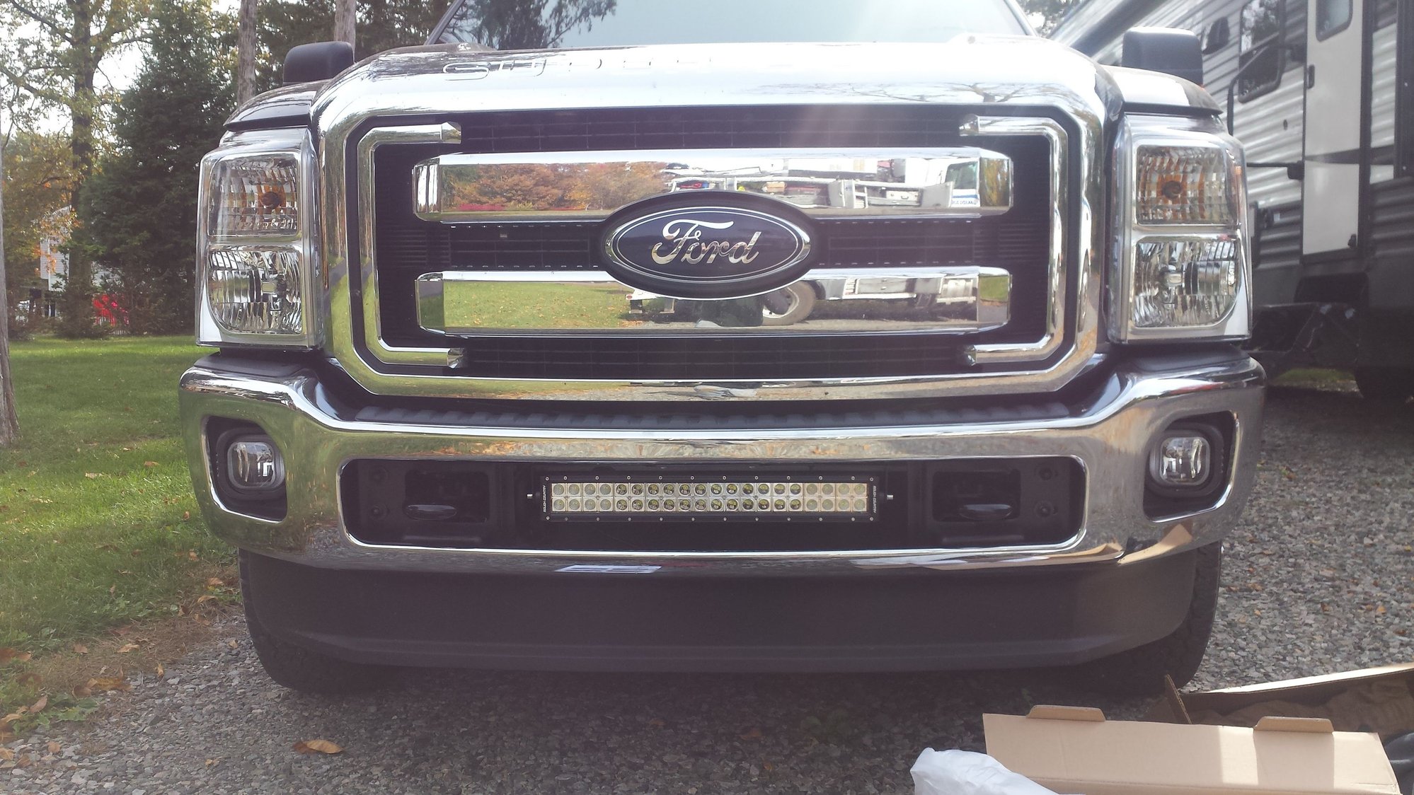

I have
Put a Rough County light in the front bumper. Looks and works great. I use a wireless remote to control it.

I used a rough country and their bracket that is designed for the super duty. Install was a piece of cake. I use upfitter 1 to control power to mine, but also have it wired to come on with high beams only.
Makes a huge difference on dark back roads.

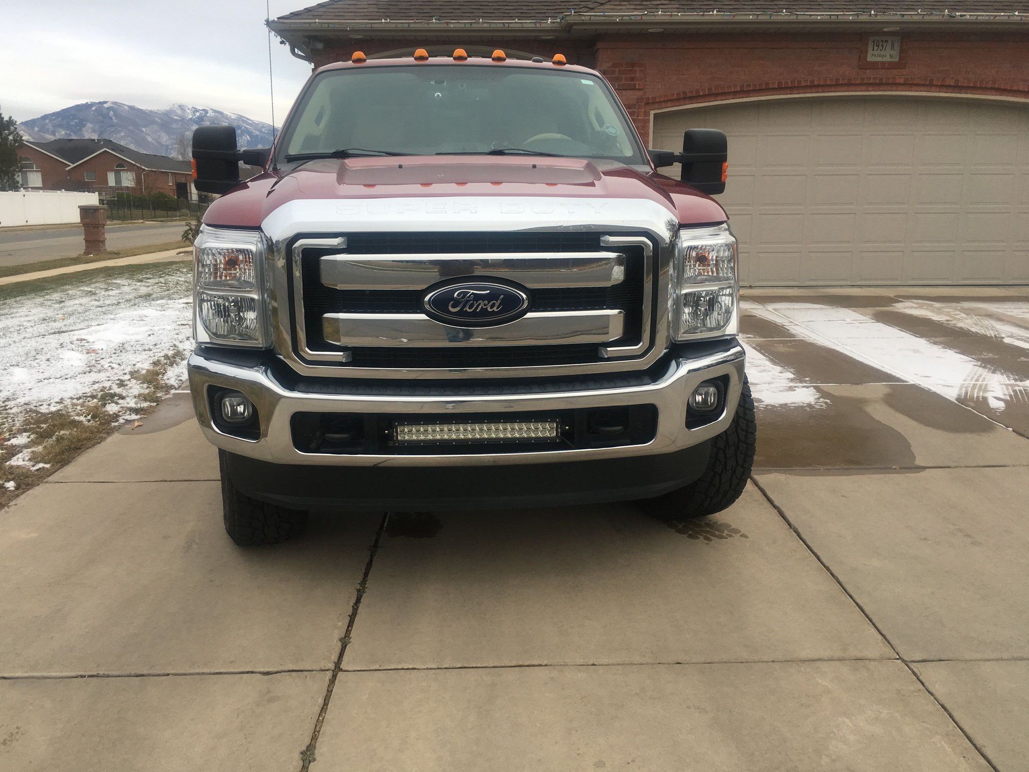

I stopped by the local Metal store ( Where I buy all my Rebar and Window Bucks etc ) and bought a piece of plate metal. I think it was 14 gauge and 31" x 4"
This fit between my tow hooks. I mounted the light bar to the plate and then mounted the plate to the brackets holding the hooks. I had to shim it a bit to get the lights flush with the bumper. I think I put 2 pieces of 3/16" steel plate behind the main plate to push the bar out another 1/2" Took all of a half hour and cost $8-$10.
