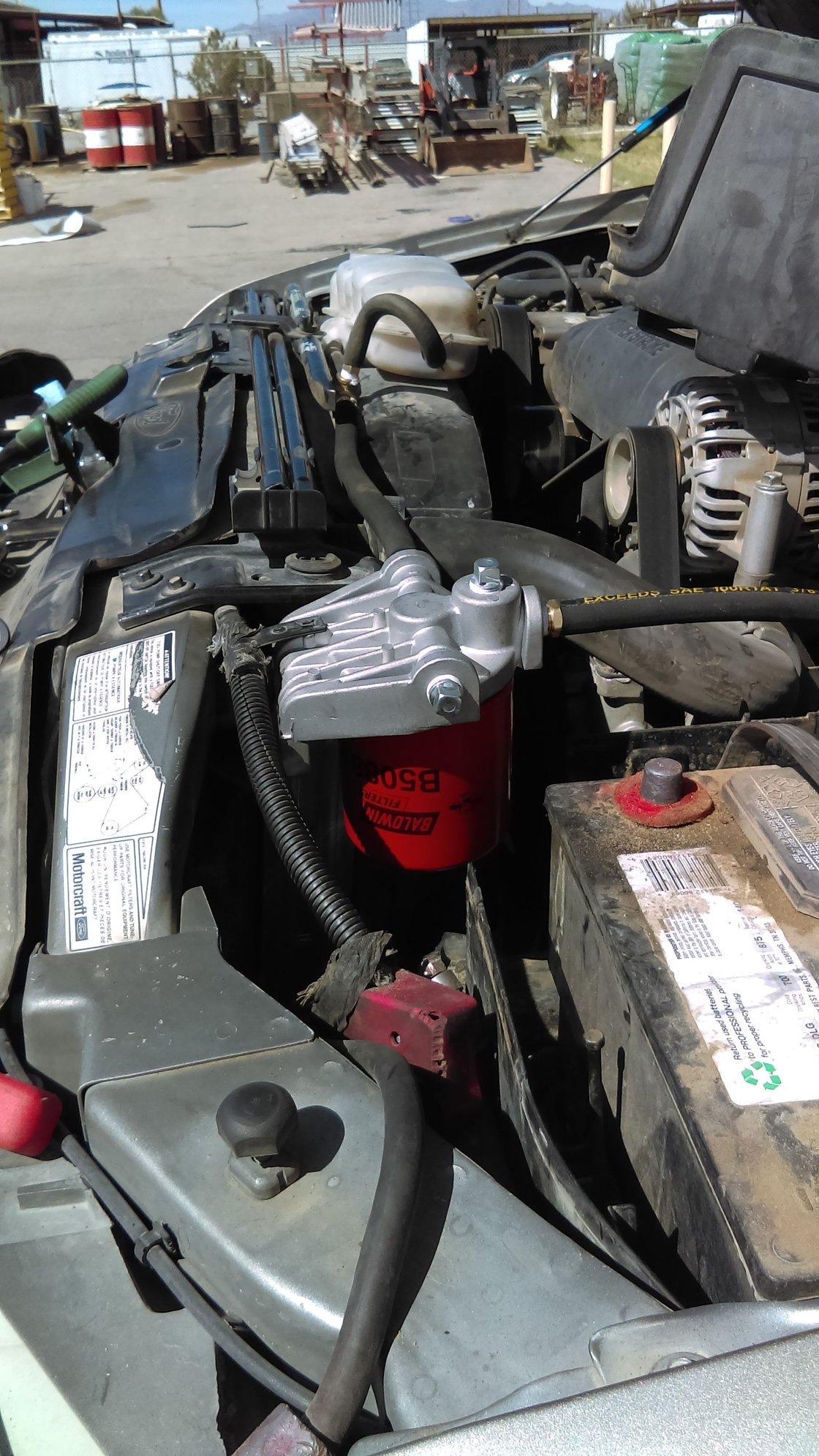

A DIY coolant set up is way cheaper than a pre made one, I spent only $65 on the one on my work truck.
It's on a Super Duty.

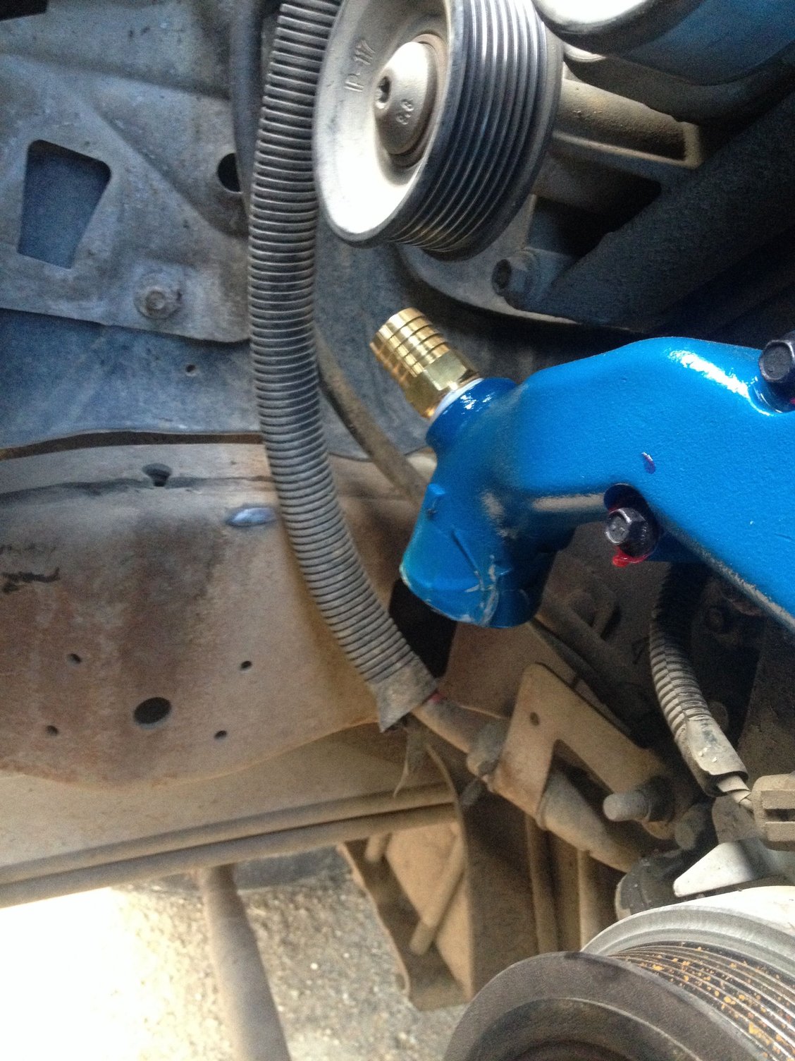

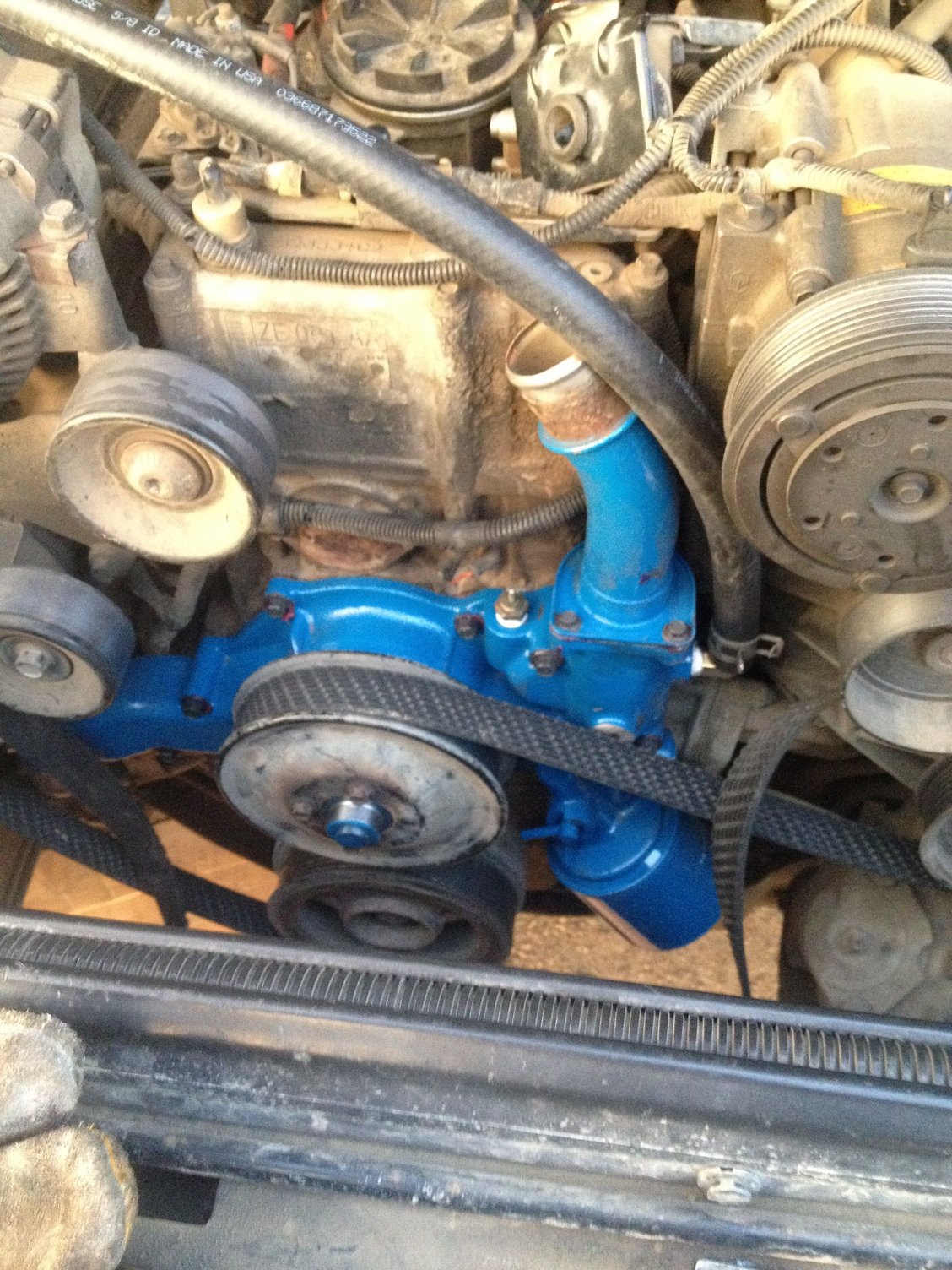

Well I was in the city today so I stopped by the local international dealer and pulled the trigger on their pump. I guess we'll see how this goes and I'll update after the install. The pump won't be in until next week tho. And I think I'll build my own filter kit for my other truck that I did the pump on a few years ago

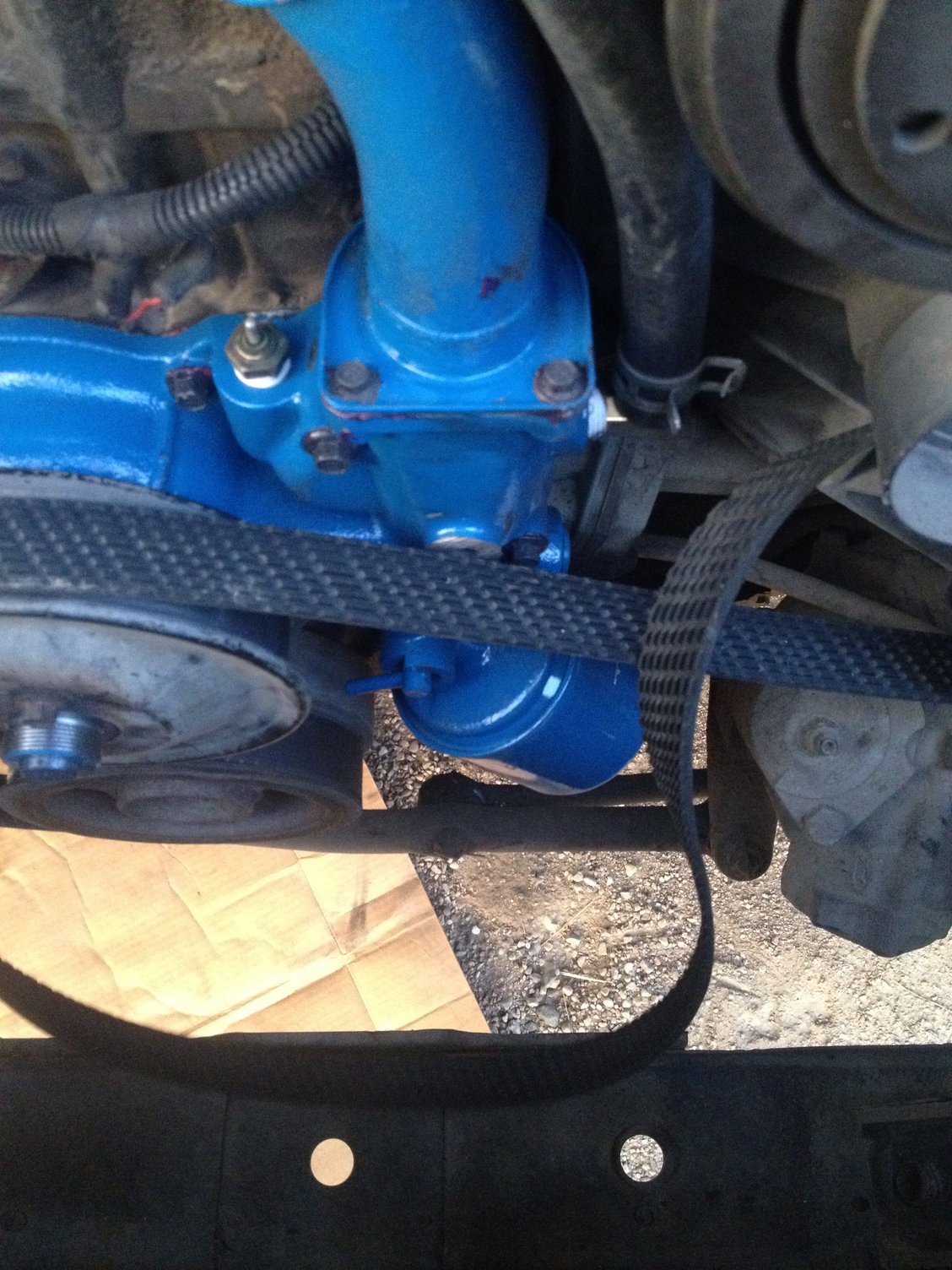

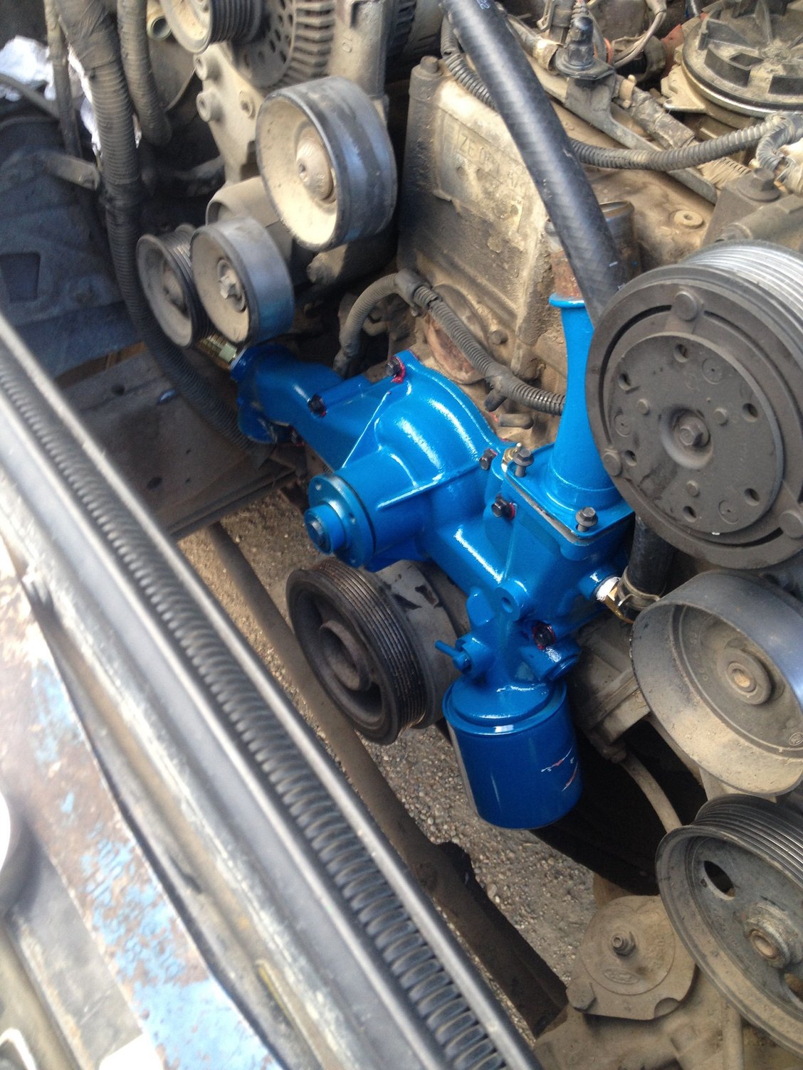

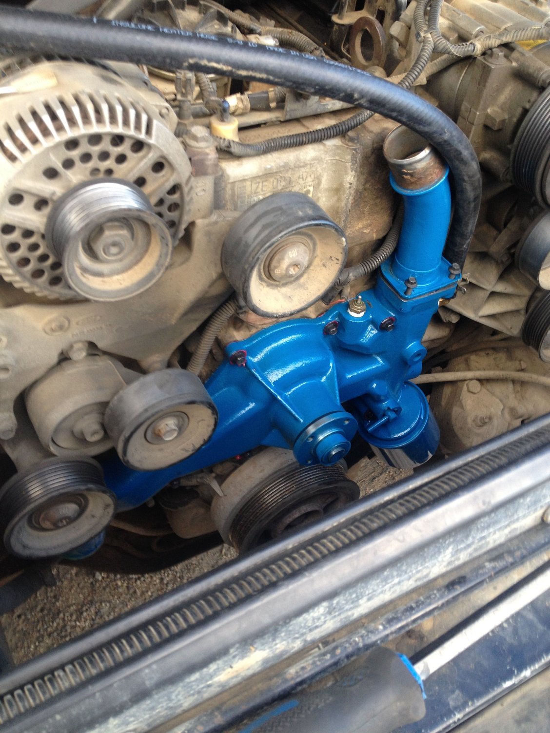

90 degree elbow. 3/8 thread to 5/8 hose barb. For the heater hose that was previously on the top of the pump. Longer hose required here.
1 inch thread to 1 inch barb for the hose that runs to the degas bottle. I just shortened off the top end of the stock hose and hooked the bottom to that barb on the pump because it had a nice pre bent shape to it already

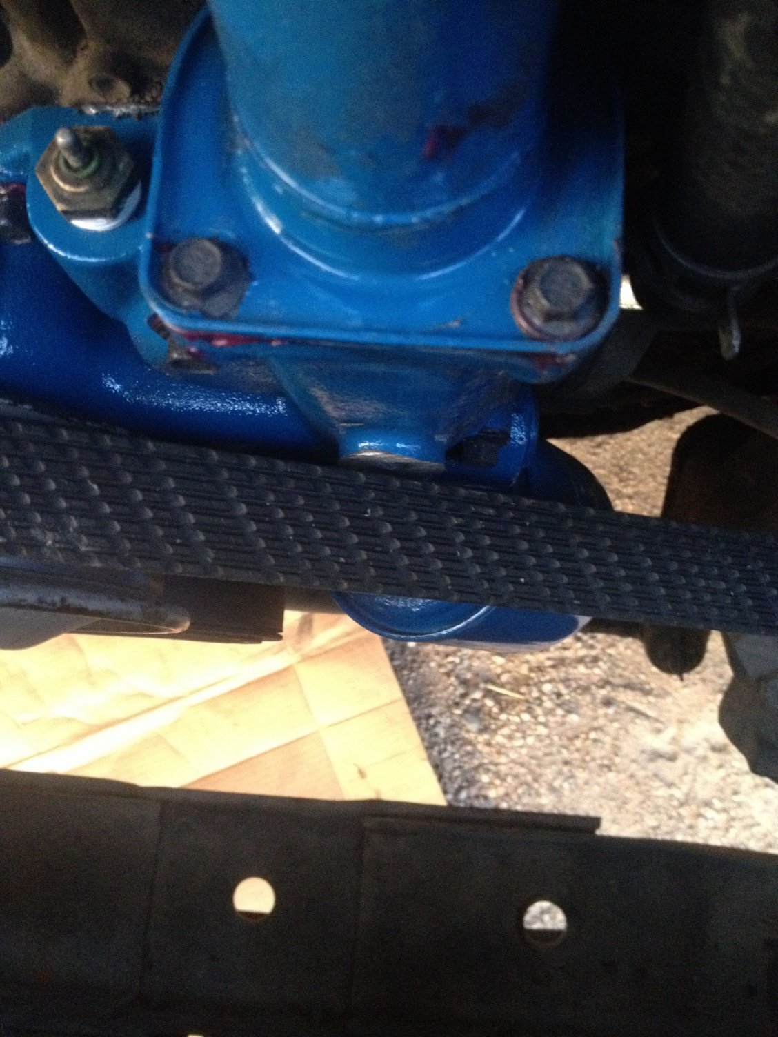

Belt clearance after grinding that part down while it was mounted in the truck

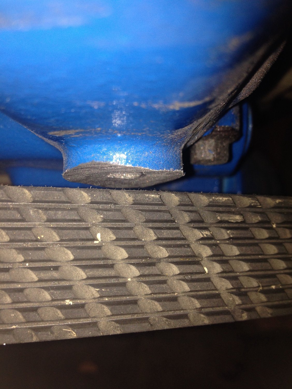

Close up of belt clearance
