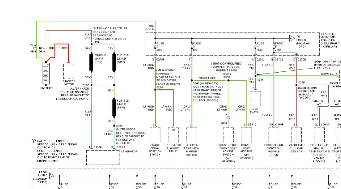

One diagram
Start here on battery with meter . Rum a long negative grd wire for meter reference . See where you are losing it.
