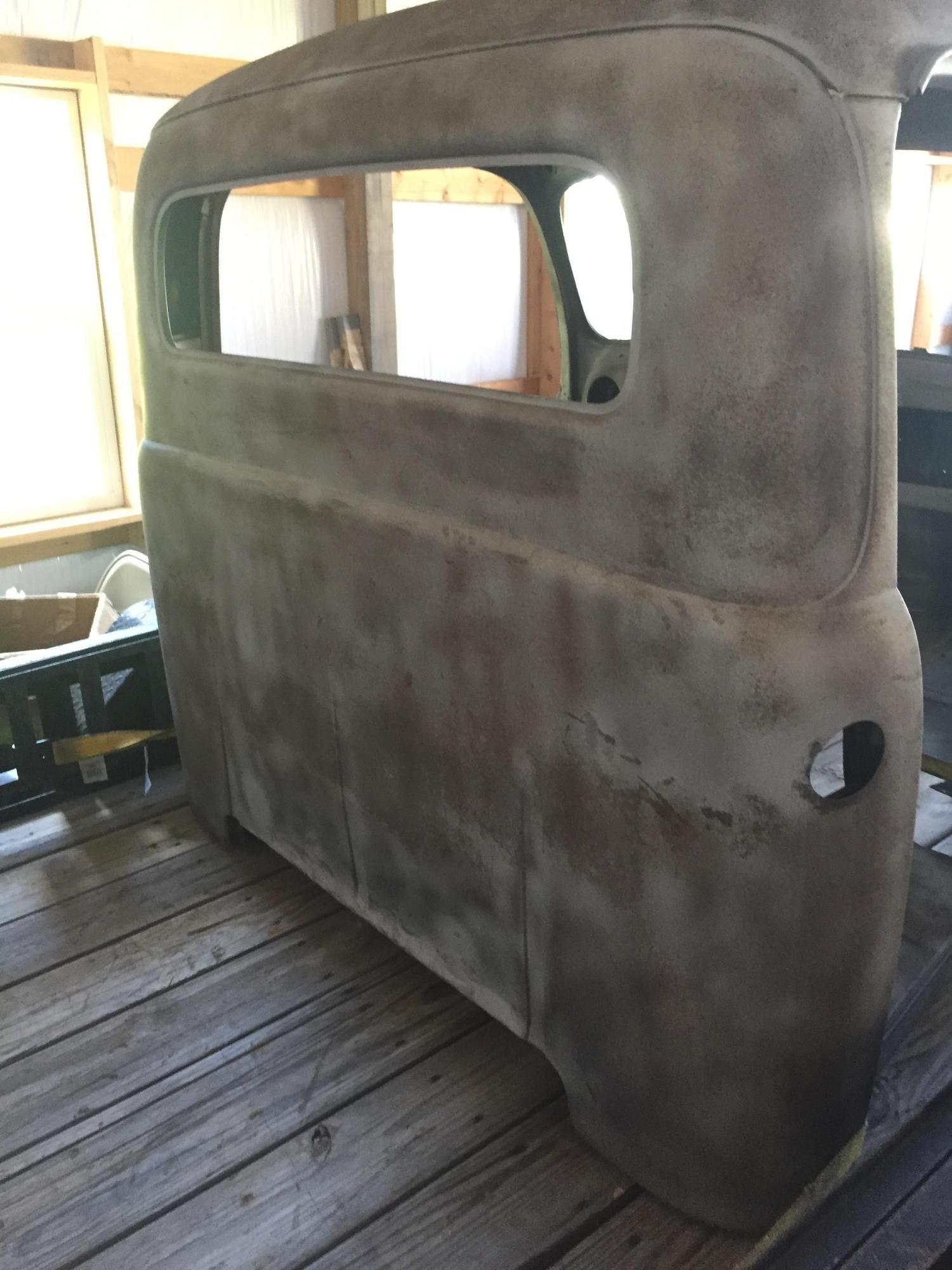

Here are some pictures thus far.
I saw where Dennis doesn't sale the floor pans individually anymore.. Is there any other good places to buy the floor pans from? I need the driver side.
After being sandblasted

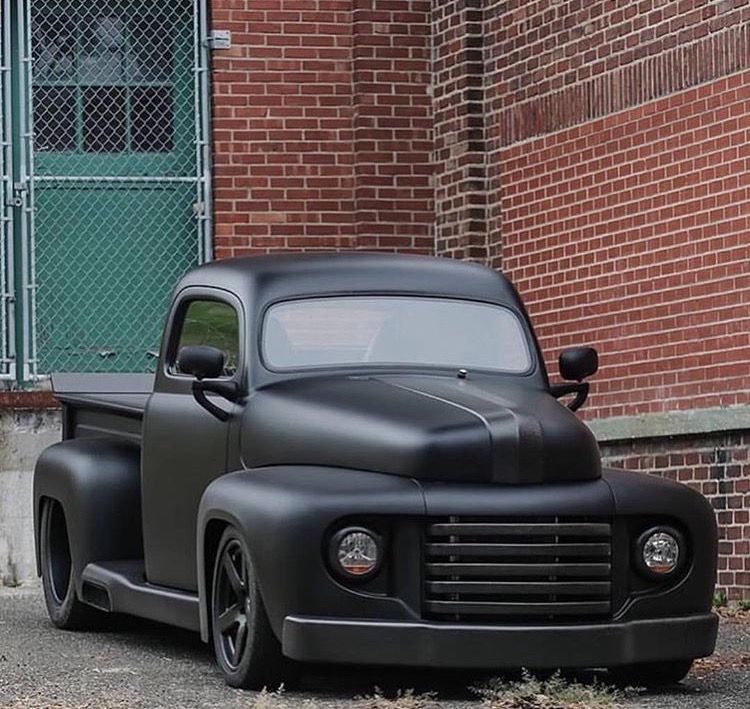

Was thinking something like this for paint scheme
If I could buy this truck I so would. I LOVE this truck.
Yes, I really like this one too. I like the headlights with the turn signals in them. I wonder if the top has been chopped or is it just because it sits low?
Old Jun 19, 2017 | 11:50 AM
  #28
Thisguy65's Avatar
Thisguy65
Joined: May 2017
Posts: 114
From: Raleigh, NC
I think it gives the illusion that it's chop by being lowered like it has.
