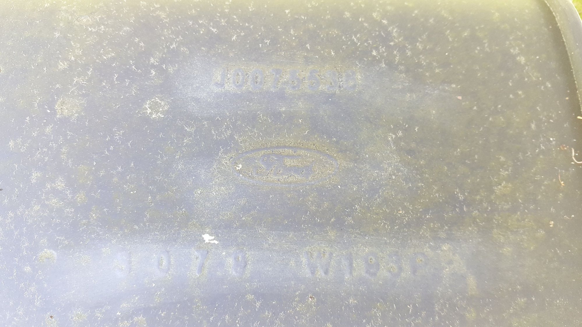

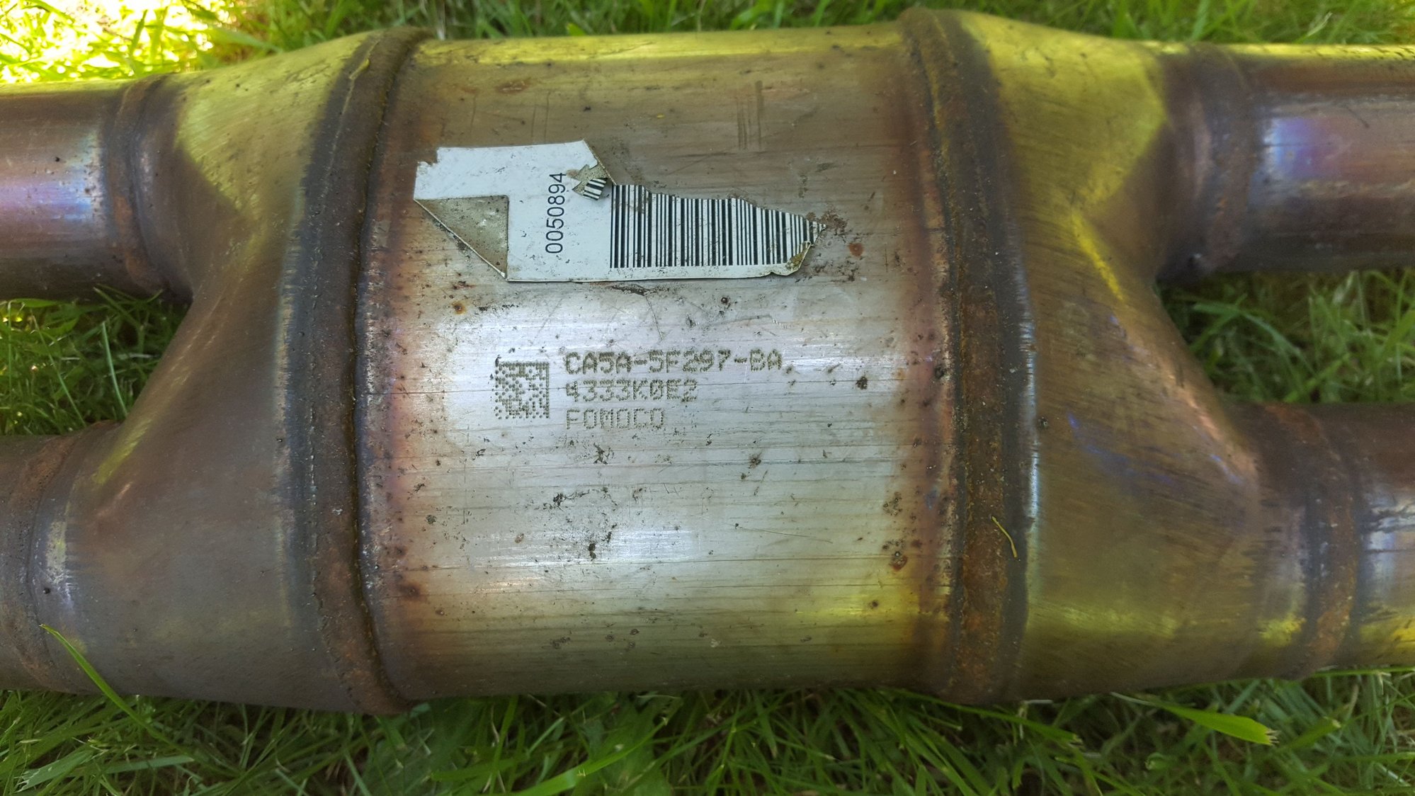

Can anyone help me identify what this exhaust system is from??? When I bought my house, this was in the back shed and I didn't get a chance to ask the previous owner. Full Ford system...

The PN Prefix CA5A identifies the convertor section as 2012 MKS.
The assembly tag (I believe) PN DA53 identifies it as a 2013 MKS assembly.
Take these two numbers to the dealer and he can run them through the CDP to get an actual Service PN and it's worth (evilBay).
