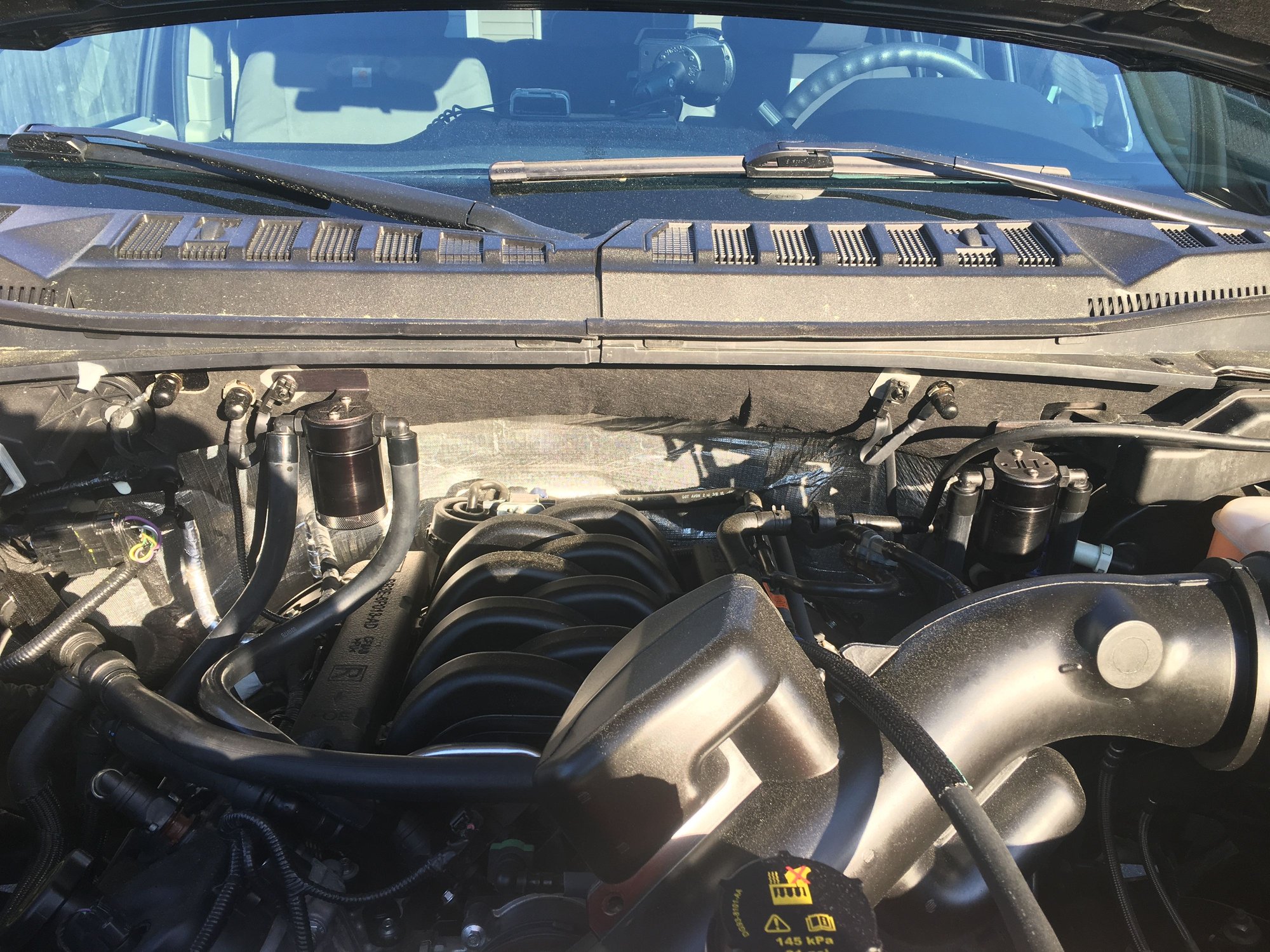

These are my 2 JLT catch cans on the firewall. Together they catch 3 ounces of oil every 3000 miles ... my intake valves must be so much cleaner , Thanks JLT !!!!
Nice and thanks for the info on how these have worked for you because i`ve been considering two of these for my 2016 Lariat 5.0.
