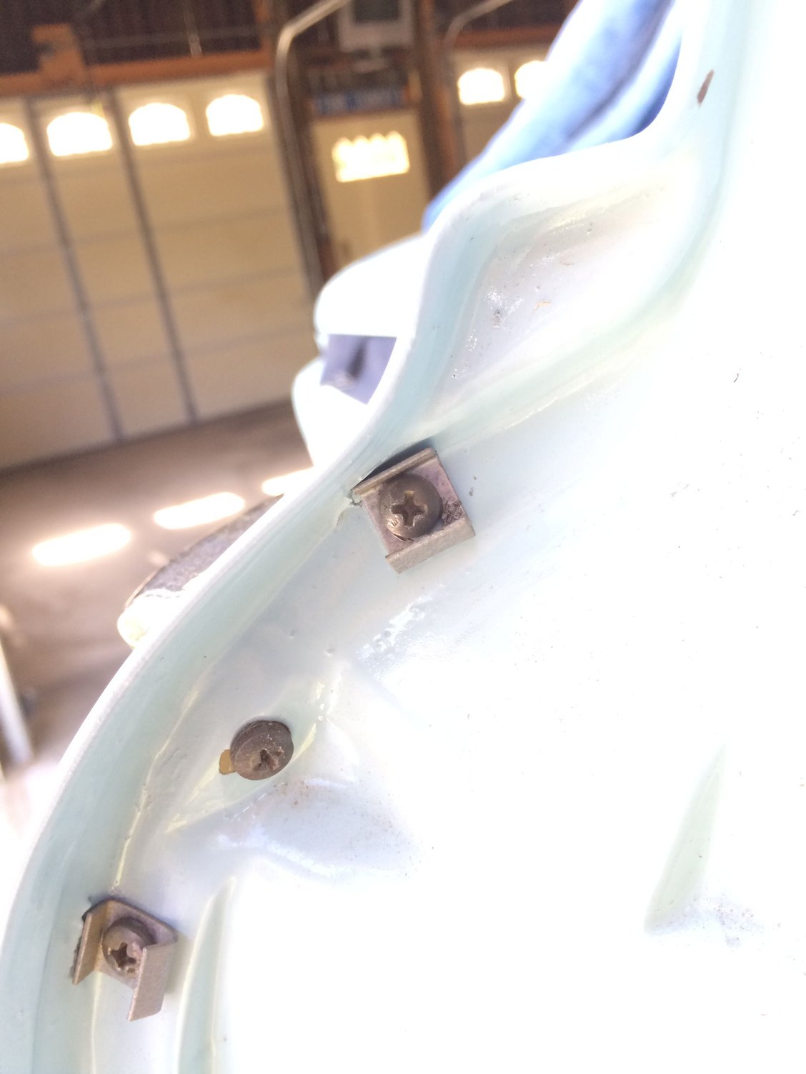

I'm sure this has come up before, but my search didn't really come up with the results I was hoping for. Has anybody made a sticky for the install, or done a step by step documentation of job? I thought I had subscribed to a couple of threads that talked about the process, but now I can't find them either. I have OEM Ford gaskets, so hopefully they will fit well. I think I may also be missing some of the clips (the ones that are screwed in key places for extra holding power). Shouldn't there be 2 clips here by the door handle?
It also looks extremely hard to get a screwdriver in at the fender side of the door to screw the clips in.
I suppose that when I get into it, I will figure it out from trial and error. I bought this truck already disassembled, so it makes it a bit harder to put back together.

Duh! I figured out that the clips stay put and you just tuck in the gasket. Still seems to be a tight area to get in there, but much more doable. I also was able to find the missing clips as well, but I really had to dig through boxes to come up with them. Funny thing is, I put gaskets on my old slick over 30 years ago, but I have little memory of the details. Well, come to think of it, I have less memory of everything as the years go by!

So you didn't have clips similar to theses pictures?
