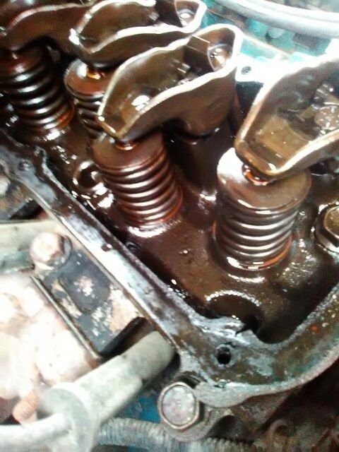

Did you take off the exhaust rotators or did you get the vehicle like that? Generally, the exhaust rotators are replaced with new retainers when an aftermarket ("bigger") bumpstick is installed.

Ok will do and I will let you know my findings. Thank you- what tool did you use to get the lifters out ? I'm not sure why there are no rotators I did not do it. I don't think they are there at least, ill post a picture.

Yeupp, you're right...no rotators. Interesting.

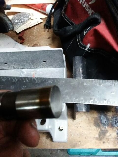

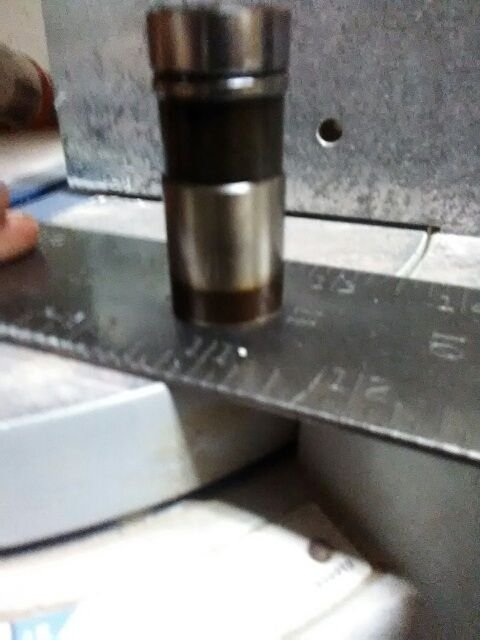

@ FILTHY BEAST So I pulled the lifters and they looked ok to me I will attach some pictures.

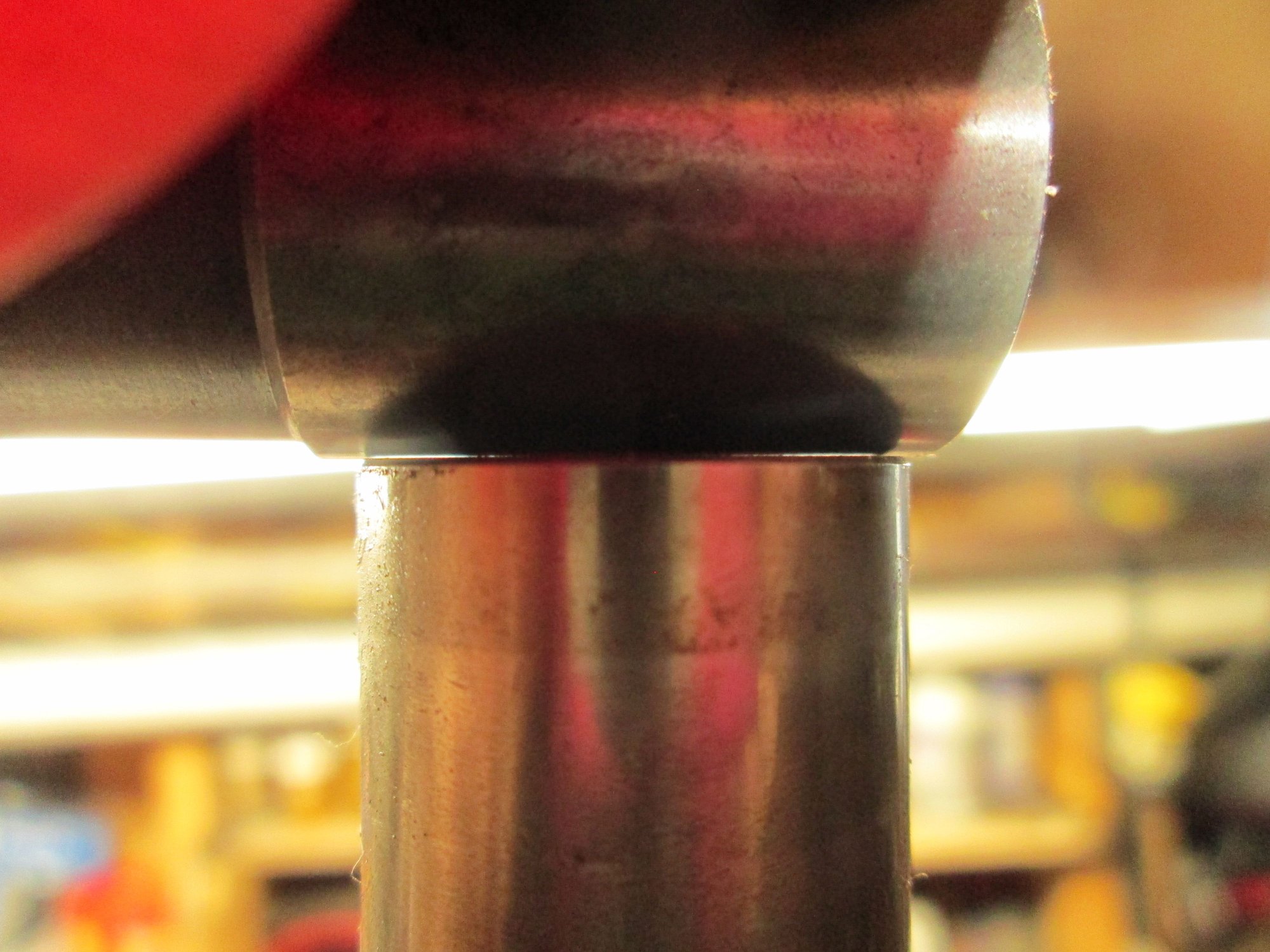

If you used the framing square as shown in the picture you might not get a good reading....did that lifter "rock" side to side a bit? I'll throw up a picture when I can....the best way to do check the cam/lifters, and the way I do it, is to put the lifters together such that they make a "T". Better visual. At least they came out without a problem, no?
I heard the ticking in the video....if you have her back together before I post a picture of the cam/lifter check, attach a vacuum gauge to manifold vacuum....what does it tell you? You could try whacking (with a brass drift pin) the offending valves to see if they move - on the valve stem, NOT on the retainer! Don't want to have the keepers flying off in all directions!
You could pull a few plugs - on the offending cylinders and look for what they're telling you.
From the second picture...that lifter's foot doesn't look healthy.....

This lifter (above) is pooched...along with the cam. Note the light shining through the middle...where a crown should be.
Good lifter and cam....note where the light shines through - on the edges - indicating a crown in the middle

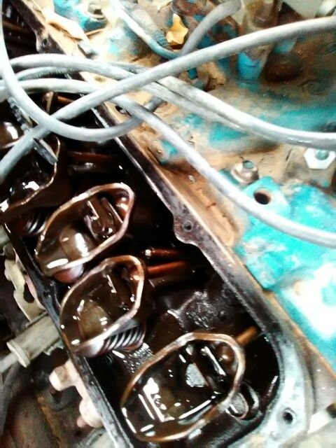

I could be wrong of course but I still don't see how to get 335 series lifters out through the head. I'm trying to post a pic.
