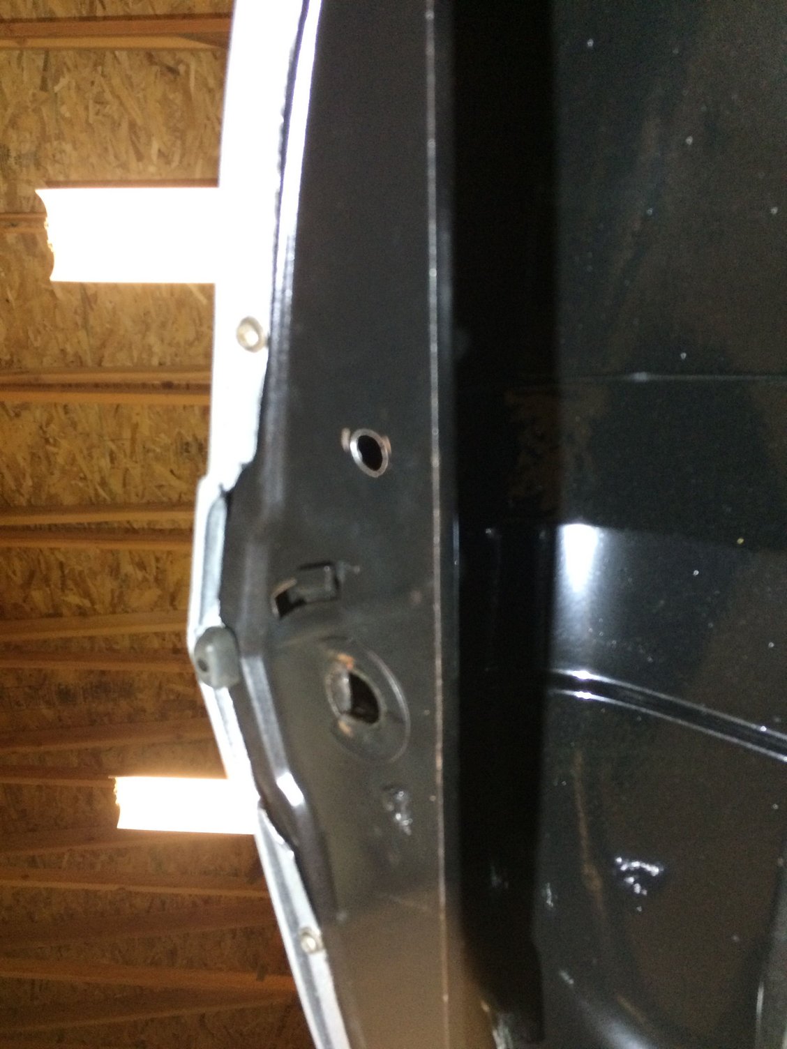

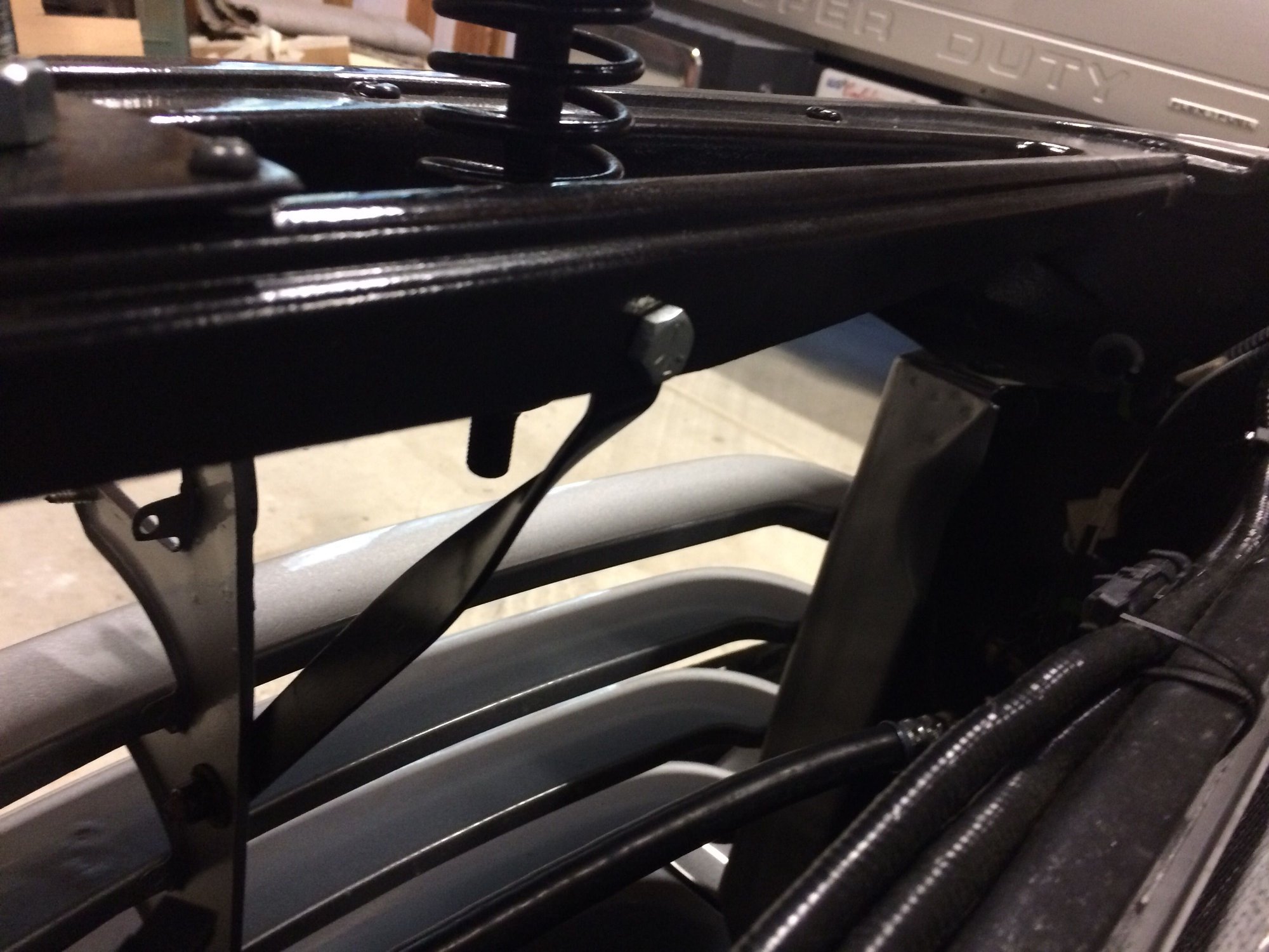

Does this seem factory or add on
I have a 51 F-1 with the following hood brace. Looks like it's homade or at least the bracket welded to the underside of the hood looks home made.
What do you all think?

That is a factory brace / support .

I had a similar brace on the hood that was on my 48, but not on the second one I bought. Could have been taken off on the second hood, or could have been a design change at some point. The bracket its bolted to looked to be the bracket that the middle of the air deflector bolts to, so that should be original.

Jimmy has the parts catalog Dan maybe he will post an exploded view but 51 maybe different
My hood is different than your Dan

My brace is on the grille to hood latch bracket

From what I have been told this is factory. Not sure about the angle iron welded to the underside of the hood, but I'll make it look good and keep it the way it is.
48 - 50 have the latch post and spring on the bottom, on 51-52 they are on the hood.

Thanks to all that replied. From what everyone says, It looks like the brace (with the twist) is factory.
Not sure about the angle iron welded to the hood that the twisted brace attaches to. To me, it looks like it was added by a P.O.. I am going to clean it all up and run with it.
