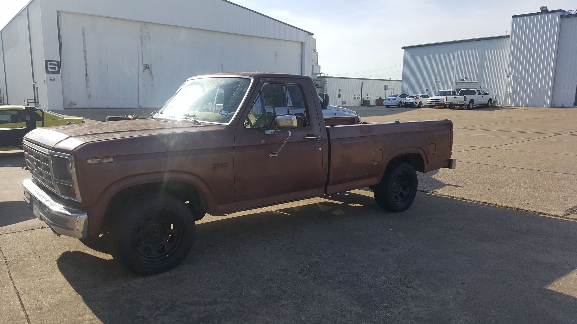

OK here is my door tag. Sorry it took so long to post. I have bad cell reception at the house and no internet.....

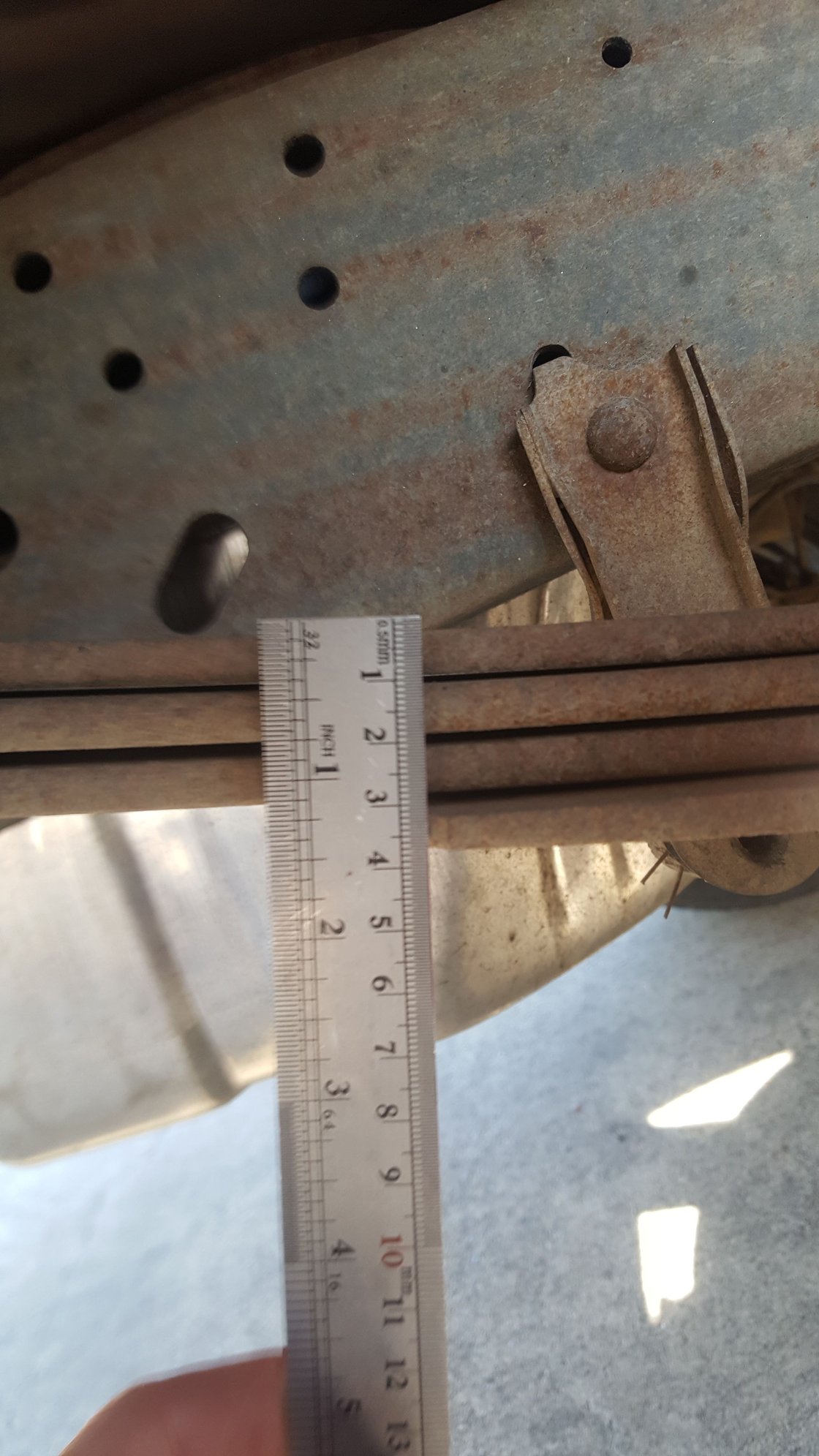

The rear springs on it now are a 3+1 three leafs and a load leaf.
All look same thickness too
Spring pack is 1.5" thick

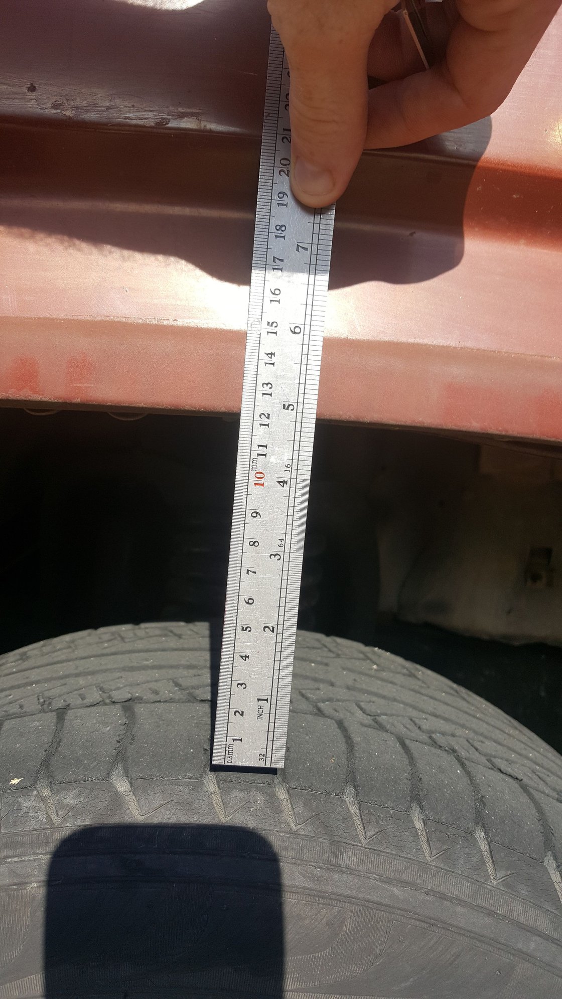

My ride height from fender to tire is just under 5.5" at the rear and 5" at the front so I am only about half an inch rake atm...
