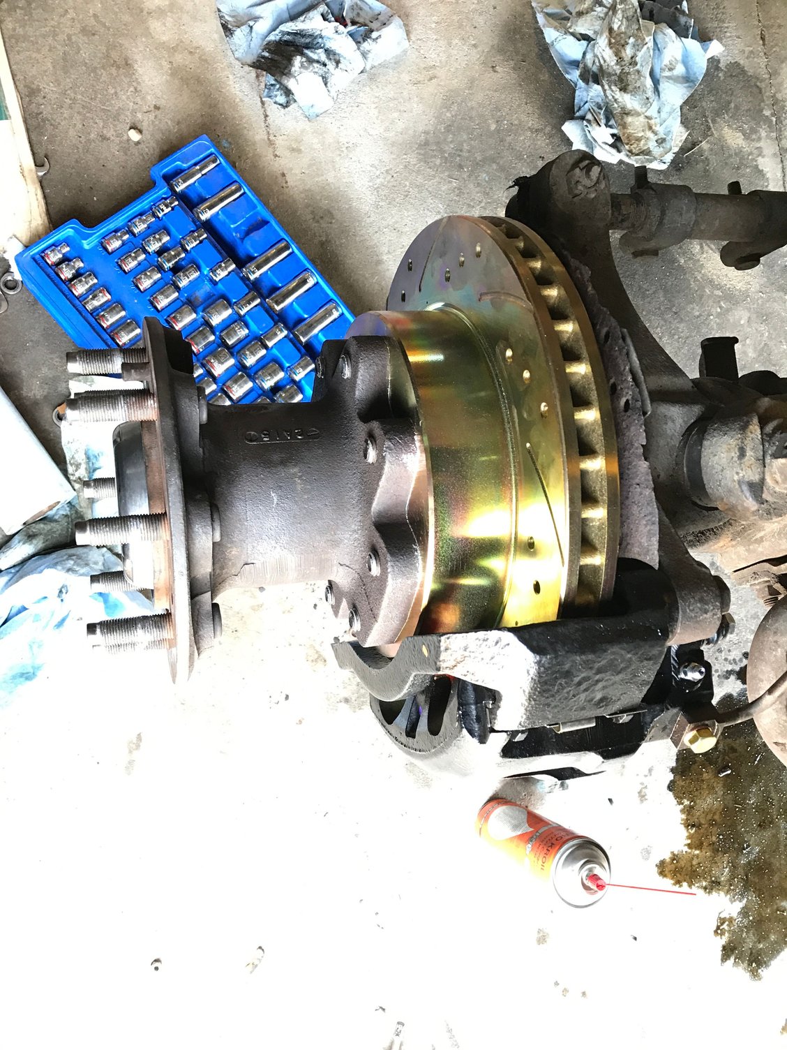

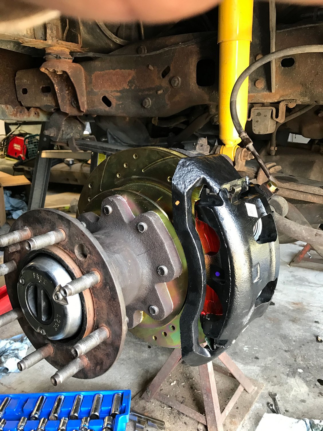

I just installed a set from eBay and was really impressed with their quality. My truck is 9300lbs empty and sees 100-200 miles a day. No issues here. I replaced my from calipers with Napa Eclipse calipers at the same time. You're sure you're adjusters are working right aren't they? I've seen the tabs bent and not holding the adjusters from spinning backwards. That'll cause long pedal travel too
[FRONT PAIR] DRILLED & SLOTTED PERFORMANCE BRAKE ROTORS ATL048694 | eBay
