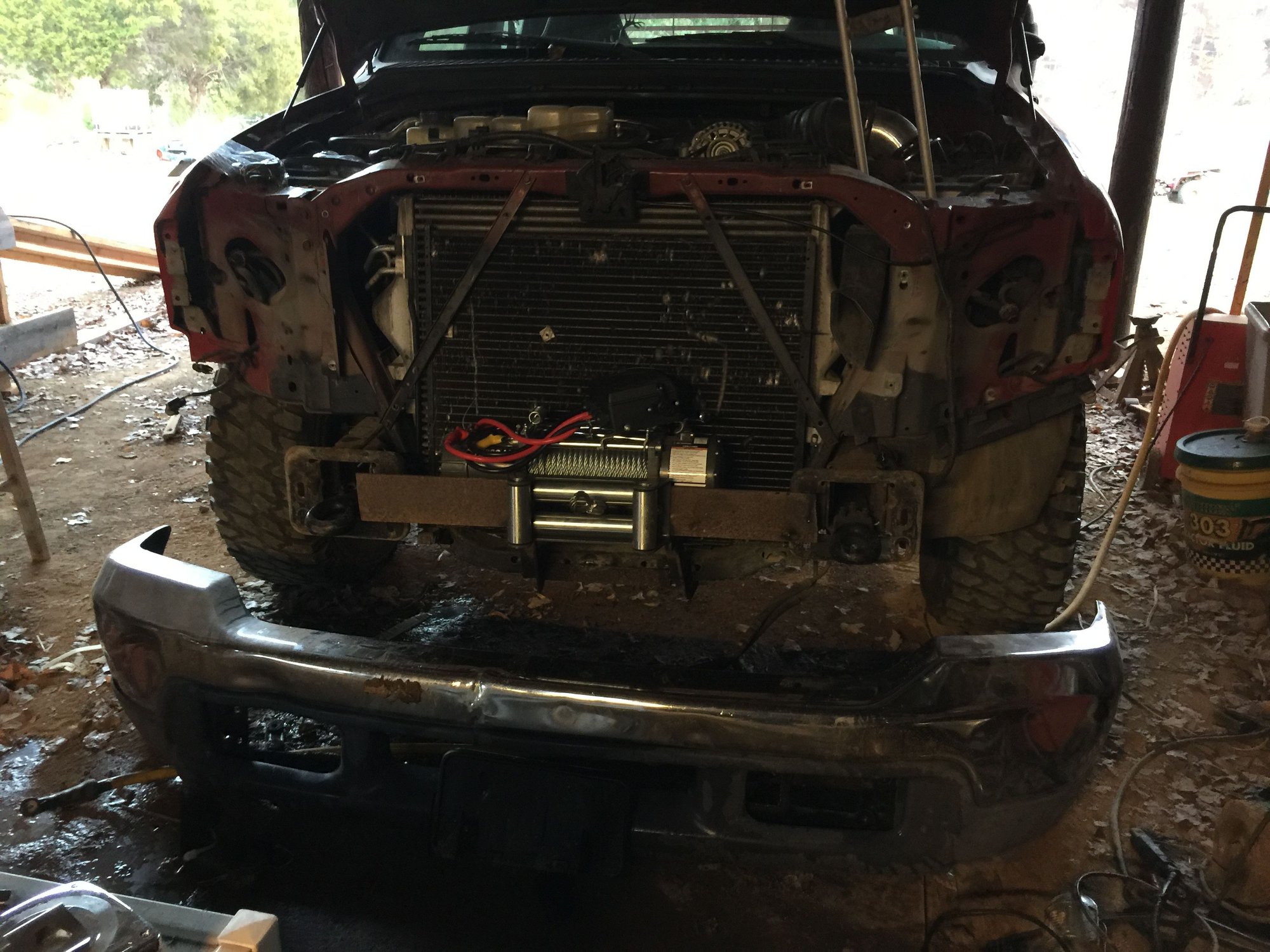

It's possible to mount a winch behind your factory bumper without getting the brackets to move the bumper out four inches.
I looked before I built and couldn't find any winch mount that didn't cost over 1000$ or move your bumper out so I made one with scrap laying around the barn had to trim about an inch off the bumper to fit the fair lead hopefully this helps someone

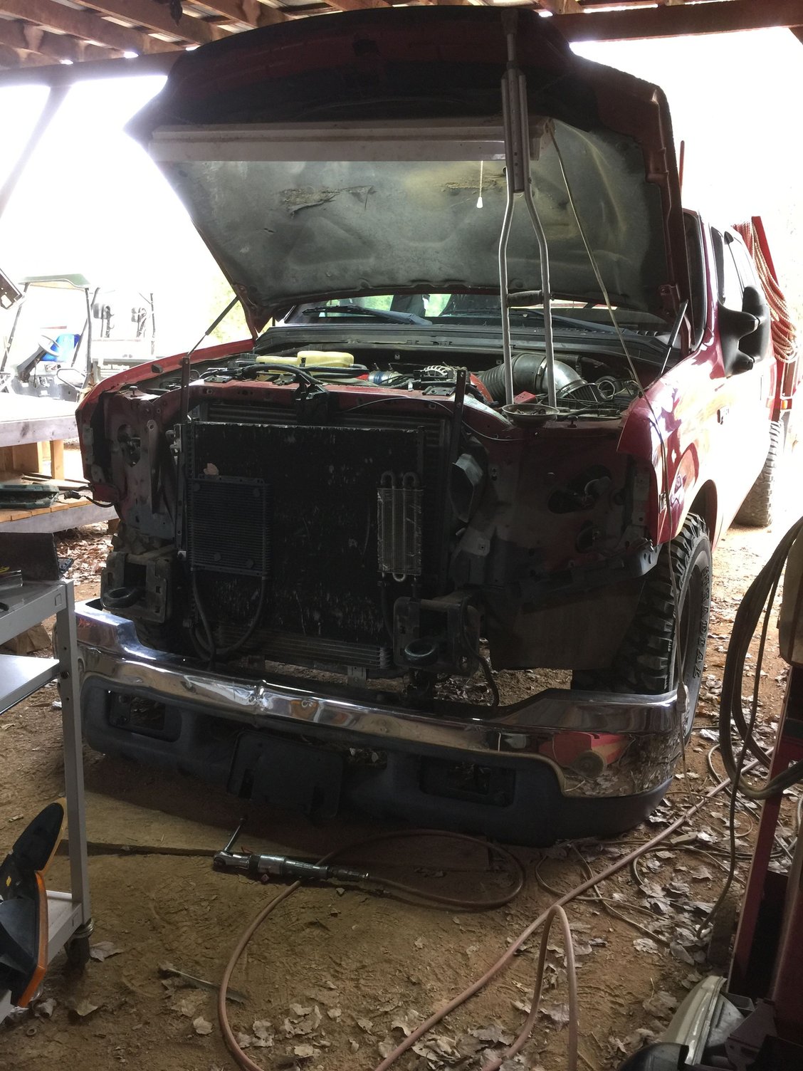

Not a very good pic but you can see the fairlead and how I had to cut

What did you do with the power steering cooler?
Old May 18, 2017 | 12:57 PM
Loggin's Avatar
Loggin
Joined: May 2017
Posts: 22
If you look at the second pic i put it back between the channel and ac condenser where it's pictured in the 1st
