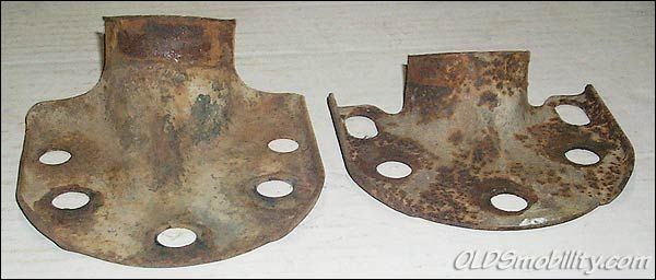

The steering column concentric bracket on the left in your photo is for (at least) a '65 - mid '69 Ford truck with manual steering or, for a truck that came with a Bendix PS gearbox.
The bracket shown on the right is for a mid-'69-'72 Ford truck with a Saginaw PS gearbox.

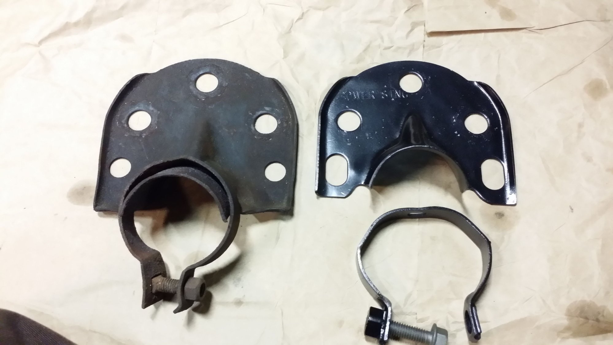

My old '69 F100 manual steering column bracket on the left. The shorter Bumpside PS column bracket on the right for a Saginaw PS gearbox.

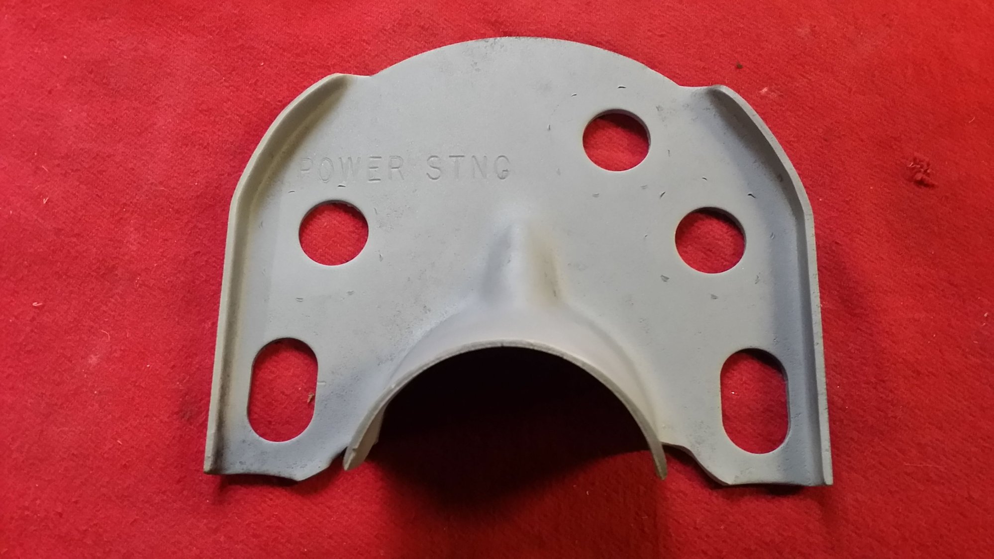

The shorter Dentside firewall column bracket (pictured below) is configured much the same as the shorter firewall column bracket for a Bumpside with a Saginaw gearbox except, you'll notice that the top bolt hole on the Dent bracket is at the 1:00 o'clock position instead of at 12:00 o'clock but, this could be modified with a new hole drilled at the 12:00 o'clock position to fit a Bumpside or a Slick.
The column brackets, for power steering with a Saginaw gearbox, are shorter (height-wise) and will have "POWER STNG" stamped on them. In the wrecking yard, the brackets are often rusted over and the stamping may not be easy to see. In this case, an easy identifier is to look for the two slotted holes on the lower portion of the bracket.
