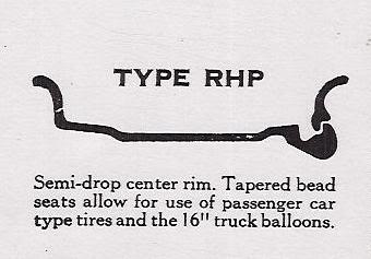

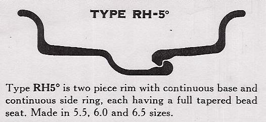

First, a welcome to FTE. Your truck's wheels are not widow makers. The trade name for the widow makers' rim is the Firestone RH-5°. Yours are more correctly called locking side ring wheels. The trade name for their outer rims is Firestone RHP. Diagrams for each are below.
I see from your profile that you live in Texas. It would be understandable that no Walmart or similar tire store would service your wheels, but, knowing that the RHP was widely used across the industry for decades by all manufacturers, there have to be shops in rural areas that are servicing the ranchs and other trades.

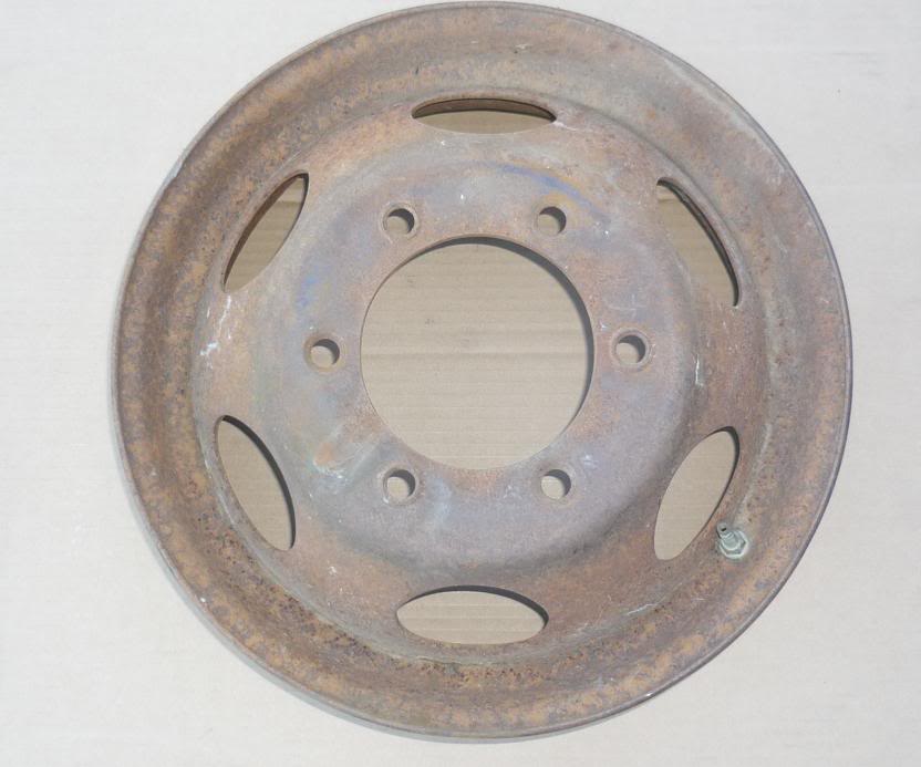

IMO the best tubeless replacement, if you are committed to that path and can find a set, is the original Budd #71320 (six hand holes) or #79120 (three hand holes) that were optional on F-350s, and similar Dodge, IHC, and Studebaker one ton trucks from 1956 to 1968. Ford through 1966. They are 17.5" x 5.25" wide. I don't know of any available sets right now, but they do show up on eBay and Craig's List. I'll also be doing a yard tour in coming weeks and always have my eyes open for them. Below are pictures. Stu
Firestone RHP
Firestone RH-5° Widow Maker
Budd #71320 Tubeless

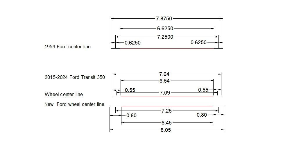

Has anybody tried redrilling 2015-2024 Ford Transit 350 (DRW) Wheels to fit the old 6x725 But use the step lug-nut of .80
Old Dec 23, 2024 | 05:32 PM
Willmott's Avatar
Willmott
Trailering
Joined: Nov 2023
Posts: 23
Has anybody tried redrilling 2015-2024 Ford Transit Wheels to fit the old 6x725 But use the step lugnut of .80. Standard and metric units.

At first glance it could be a viable option. It might even be possible to mount up the wheels with modern washer style lug nuts, with minimal redrilling.
But, how close are the center openings of the two wheels. Without proper centering of the wheels, they will not last long.
Lug retention will only hold so long. And the wheels will, creep off center quickly.
That will result in disastrous repercussions in short order.

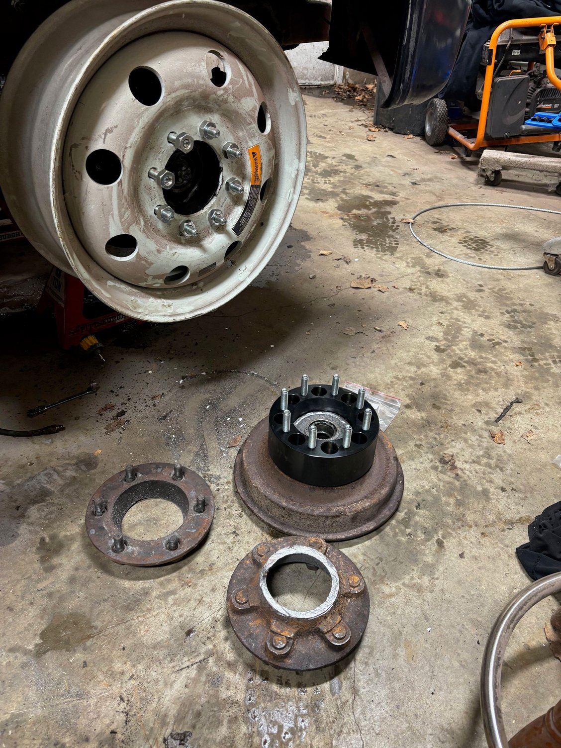

so im sure some one on this form will say something critcal about how we did this , but i got tired of 54 sitting in my garage not going anywhere because of the 6x 7.25 bolt pattern with widowmakers, we swapped the rear axle to a dana 60 and then did this.... it seems to work great , and now we can finally drive the dang truck with out fear of the old wheels and tires . ive now driving it down the road at "top speed" and have had no trouble what so ever
i will also say i got a lot of flack for drilling out our own custom wheels for the f5 and using trailer wheels on the f3 but they now have gone several thousand miles with no issues and had we not gotten creative all of these trucks would be be big old paper weights
