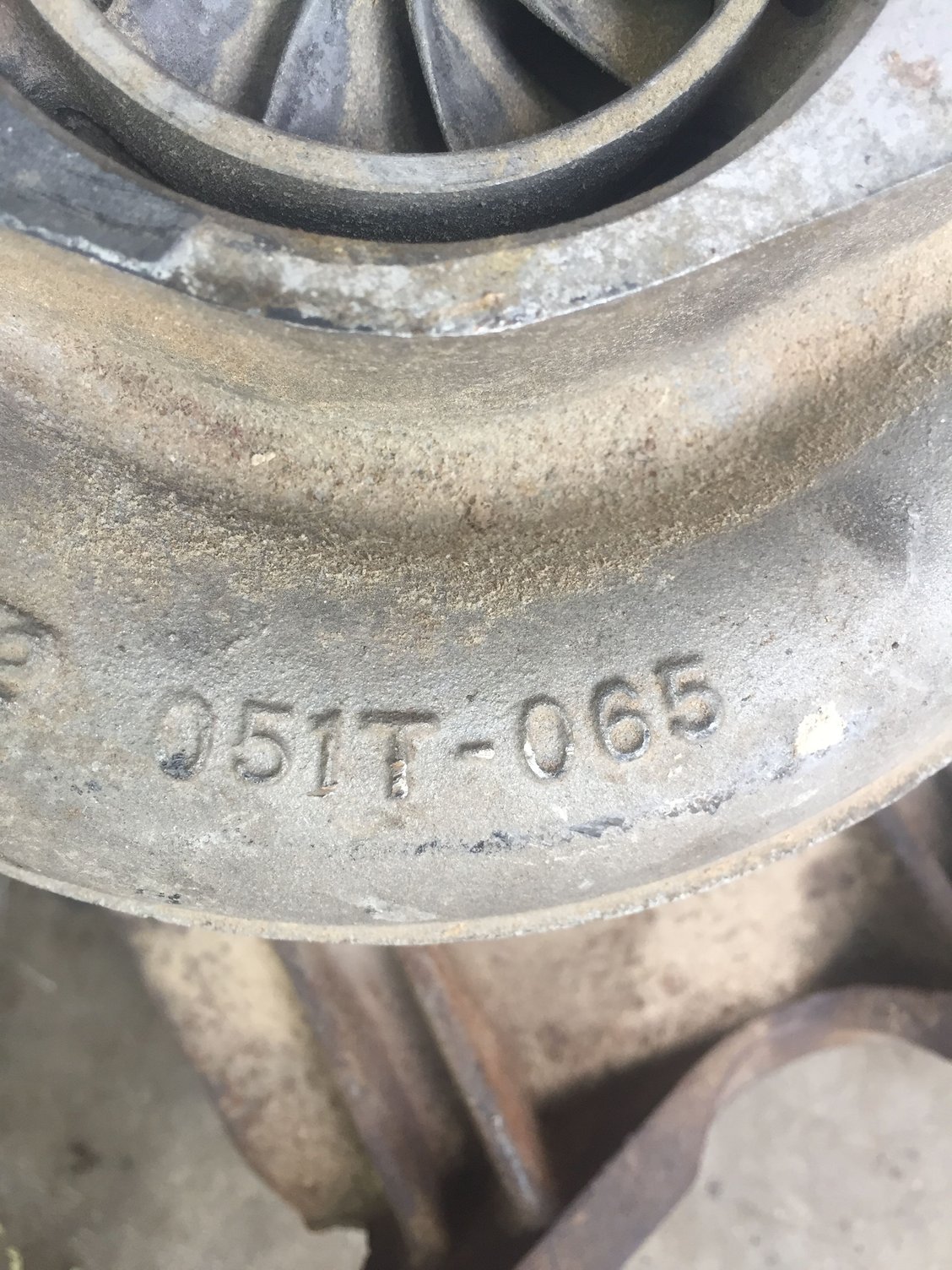

So my next question is does anyone see why the duramax turbo would not be a safe turbo to run on a idi motor hers a pic of the turbo

the problem is it is going to cost as much to make that work as it will to buy a used kit.
i would sell it and look for a used kit for the ford IDI.

another thing to remember is that turbo was designed for a 6.6 engine. it is gonna be small for a 7.3
