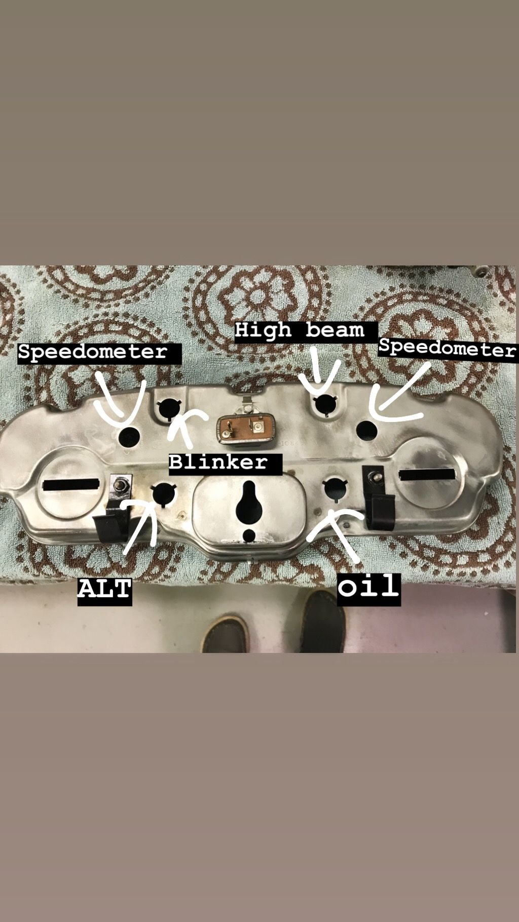

Old Dec 15, 2019 | 01:59 PM
Vandy23's Avatar
Vandy23
Joined: Sep 2019
Posts: 272
Likes: 24
From: North Jersey
Take a look at this photo. I just re did my cluster. I replaced the bulbs with new leds. It looks much brighter.
