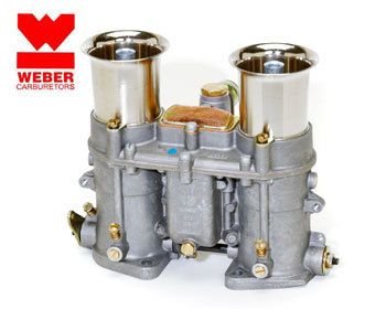

Originally Posted by Rasputin53
Every time I see those intakes I want to build an 8V carb to sit on top.
Wonder if (4) Weber IDAs could be adapted to the Cobra/GT40 lower intakes? ....not that I would do it because it's still carburetion but, might be cool on someone else's ride.

The spacing is almost perfect for the Autolite 2100 boosters. I have a pile of them, but not 4 matching. I bought a 5.0 lower from the yard a while back to experiment with. Could be done, but the custom body is currently what's stopping me. I've studied the IDA's and the old Harley carbs. If I could find four identical 1.08 2100's I'd be a good ways there. People used to sell them for $5, or just give them to you. Not any more.

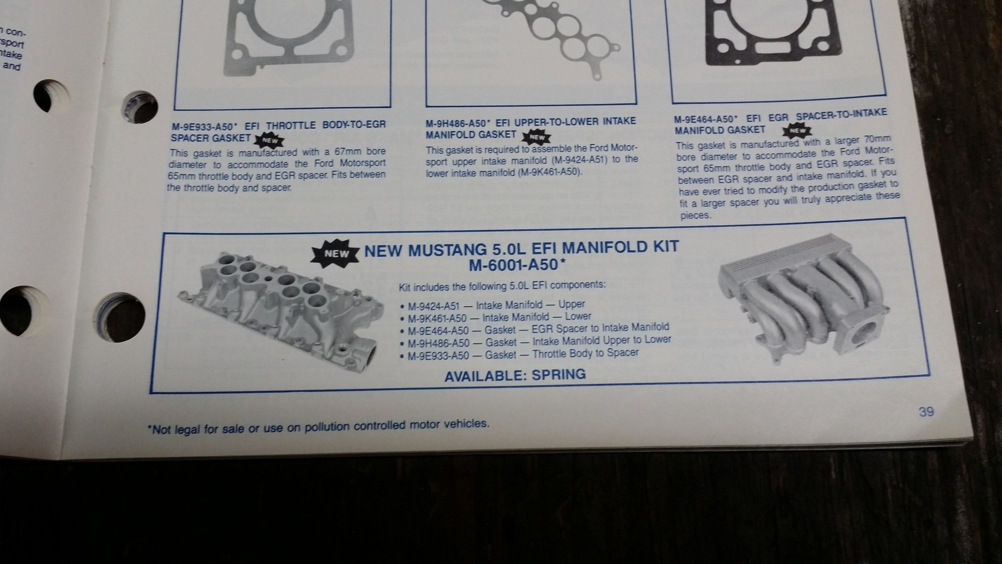

I have an old Ford Motorsport catalog. The tubular upper and corresponding lower were available as over-the-counter performance items two model years before the Cobra came into production in '93.
Notice the availability date for the tubular upper/lower intakes for a 5.0L engine.(Spring [1991]).
The Cobra cast aluminum upper intake can be Extrude Honed to out flow the tubular upper intake but, it's too bad the tubular upper never came on the the production Cobras from '93-'95. The tubular version just looks a lot more impressive and it would run cooler than the cast upper (more air circulation around it).

Yepper. The lower and upper tubular were "off the shelf" Motorsport pieces They (SVT) put on the 1st Gen Lightings to make them quick and comparable to the SS454 truck. The Lightning was Ford's answer to the SS454. AND DID IT WITH LESS CUBES!
