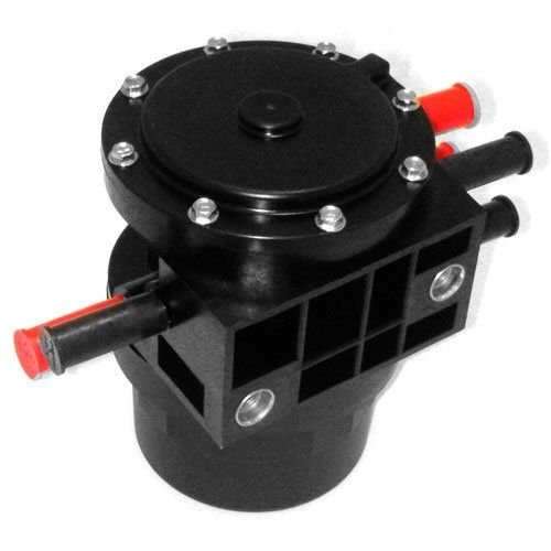

He doesn't have a 3 port. He has fuel injection so he has a 6 port, and he may have the "fuel reservoir" type switching valve where the pump pressure does the switching.
See if you have something on your frame that looks like this.

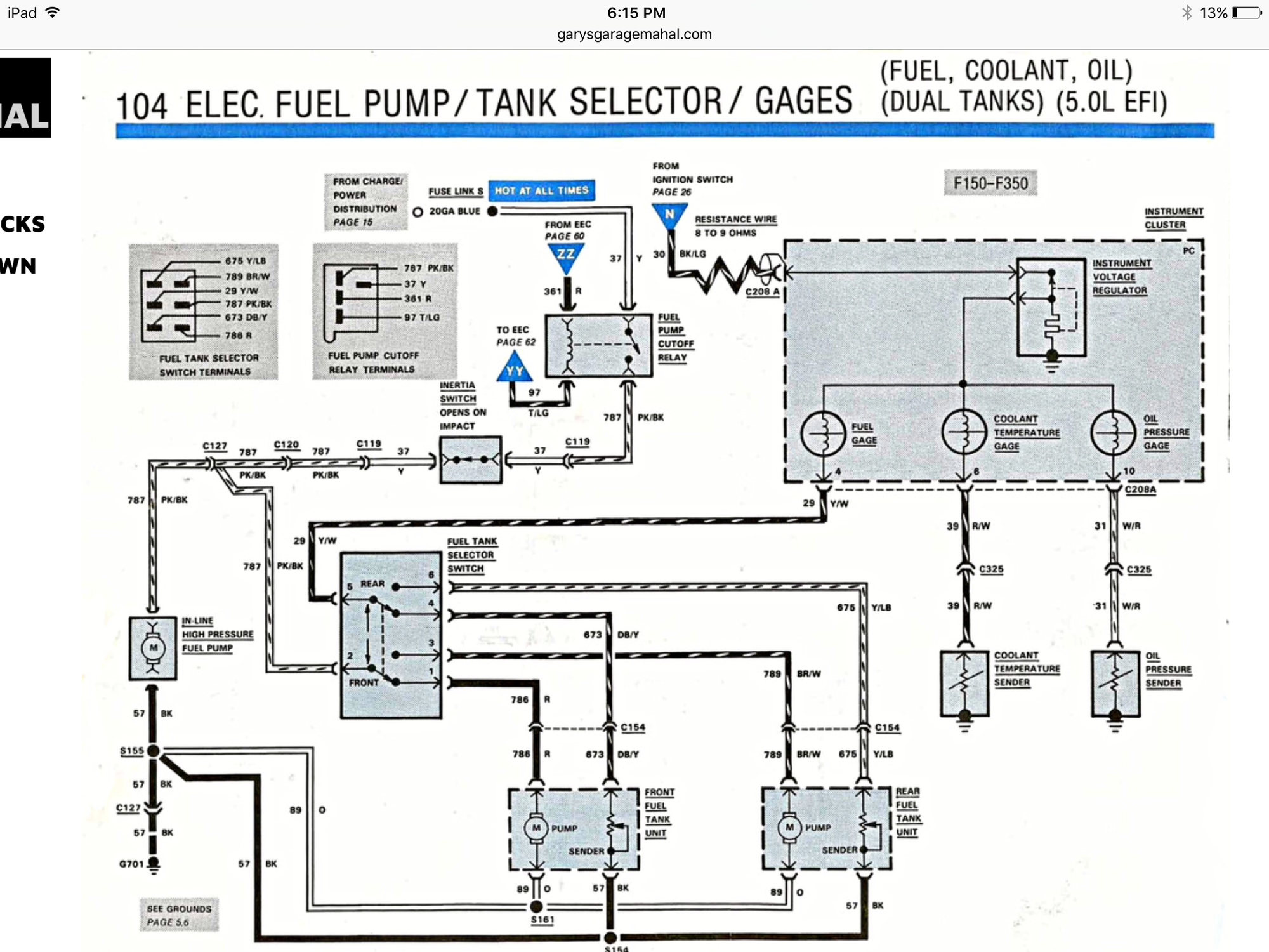

Since the fuel gauge drops to empty when the rear tank is selected then there could be a problem with the fuel tank selector switch, as shown below. Since that valve is powered by the fuel pump, it could be that the switch isn't bringing in pump and the gauge.
I would check power for the pump as well as pulsing power to the sending unit at the connector there at the tank.

Gary's diagnosis makes more sense. If you are still drawing fuel from the front tank, and the gauge is not reading either, the common denominator is the dash selector switch unless you have two problems at once.

There isn't a 6 port fuel tank selector valve listed for the OP's 1986 F250 302. OP's "About Me" profile says 1986 F250, but failed to mention this fact.
E5TZ-9189-A .. Fuel Tank Selector Valve - 3 ports with single fuel line system / Marked: E57B-9F271-AA
1985 F150/350 all I-6 & V8 gas with carb / 1986/89 F150/350 all I-6 & V8 gas.
1985/86 Ranger all I-4 & V6 gas.
1986/89 E150/250 300/351W under 8,500 lbs. GVWR
1986/89 E250/350 460.
Or, the OP's truck could have this:
E6TZ-9B263-C .. Reservoir & Fuel Tank Selector Valve / Marked: E5TA-9K044-AA or E7TA-9B263-BA
1985/86 F150/250 302 with dual fuel tanks.
