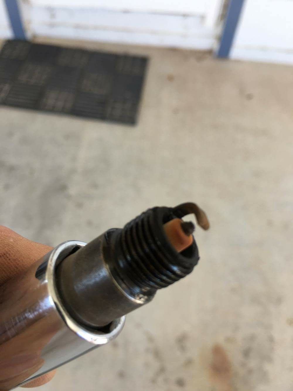

Ok, pulled a couple plugs out, and they didn't look bad-at least not to me. Interesting, however, that they were tan on one side, and white on the other side. By the way, these are platinum plugs, so the electrode looks funny:
Number 5 - tan side
Number 5 - night and day
So I pulled a couple more:
These looked similar to the first, so I pulled them all:
All the plugs looked pretty much the same. Nothing stuck out as immediately obvious
Once all the plugs were out, I blocked open the throttle and ran a compression test:
The pressure rose Immediately to 120ish, and topped-out between 150 and 160:
Pressures within 7% and nothing extremely low or high
The plugs don't have that many miles on them, but are probably a couple years old. Since they're all out, I'll probably go get new ones now. Copper ones...

The tan color on one side isn't too bad....a tad bit fat, but overall, very good....it shows what side of the plug gets the fuel/fire. #6 plug doesn't look that good (lean), unless the tan color is on the opposite side of the picture. Compression is good all around
Nothing to gain with platinum plugs except a few more dollars out of yer pocket. The copper ones - Motorcraft, Autolite are better for our vehicles.
