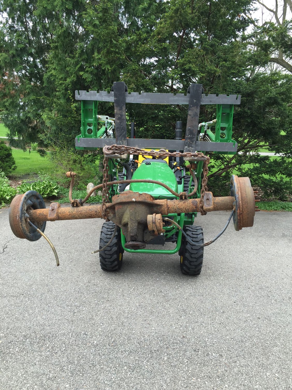

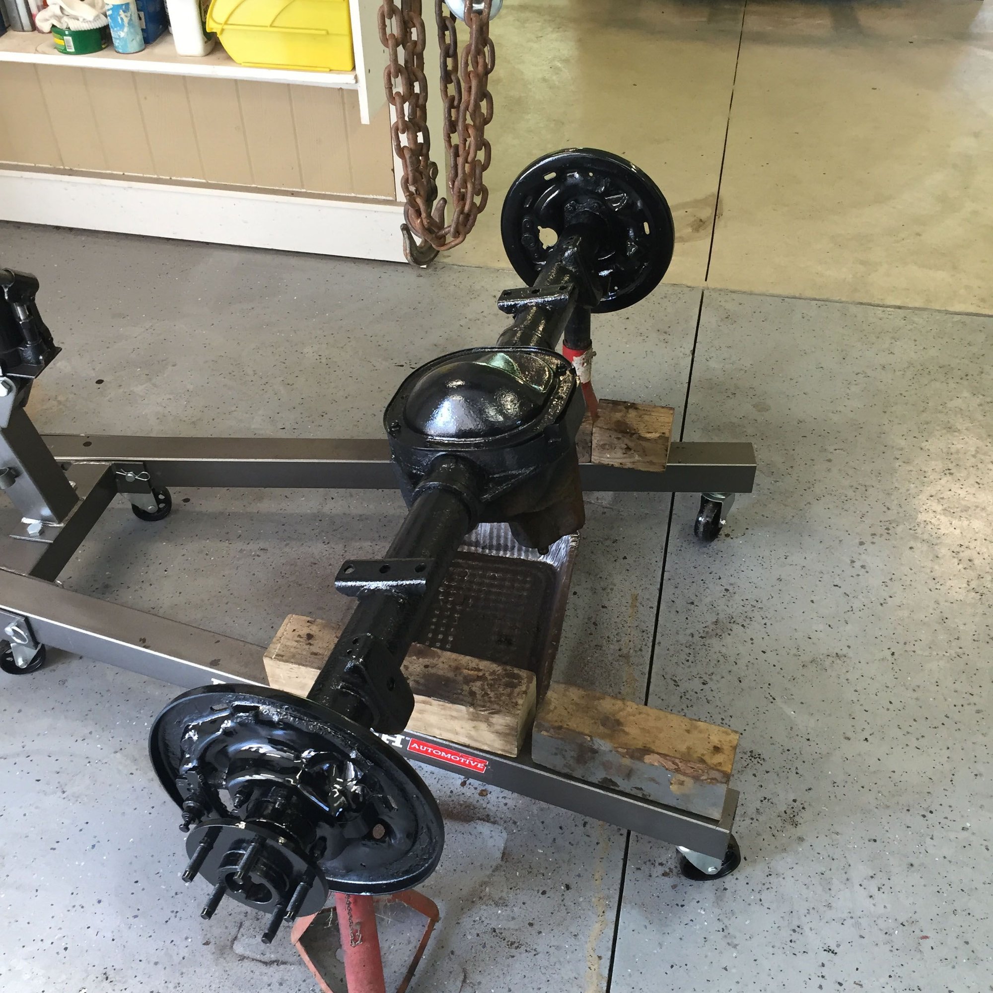

I agree, I decided to go with an 8.8" from a 2001 Ford Explorer Sportrac. It was a much better bargain.
Before
After
looking good

Originally Posted by armyaviation
How did you clean yours up, wire wheel ... sandblast?
Elbow grease. I used a combination of scrapers, wire brushes and wire wheels of various sizes. It was a messy job. I didn't want to use a sand blaster as the grit gets into everything and I did not want to totally disassemble the axle as the wear pattern on the ring gear looked good.
