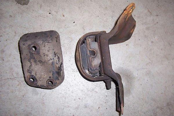

Hey guys,
Currently doing a 460 swap into a 2wd. I have acquired the correct 73-79 f250/350 460 2wd motor mount towers and rubber insulators but I am having the hardest time getting the last piece. I need the plate that bolts to the 460 block and drops down on the motor mounts. If anyone has any info on where to find these or knows someone who has these pieces it would be greatly appreciated. The pieces I am describing are on the left in this picture.
Thank you, Dave

1973/79 F100/350 460:
D3TZ-6028-A Right & D3TZ-6029-A Left .. Engine Supports aka towers/stands/perches / Obsolete
D3TZ-6030-A Right & D3TZ-6031-A Left .. Brackets / Obsolete
These brackets bolt to the block, the rubber insulators (D3TZ-6038-A R/L same) bolt to these...then to the engine supports.
No Ford dealer or obsolete parts vendor has any.
Note: 1975/79 460 Econoline supports, brackets, rubber insulators will not work on 1973/79 F100/350.
Note: 1968/78 460 Passenger Cars did not use brackets, used different (car only) engine supports/rubber insulators.
