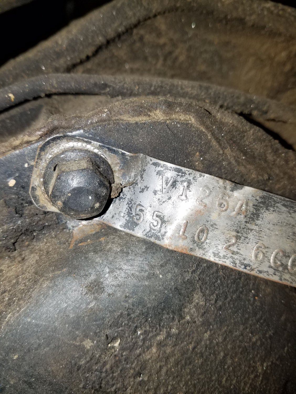

It is a double pumper i got it for free. No lift and the tag on rear end says v126a 552026co5

I don't recognize anything on the tag except it may have 3.55's in it. They usually punch a hole right through the 3 for the mounting bolt. 3.55's would not be a bad gear for that truck with that small engine.

Yep, 3.55's like Dave said. But, a 600 CFM carb is about right for a 351, so I'd go smaller on the carb for a little 302. (A 302 in an F250?)
