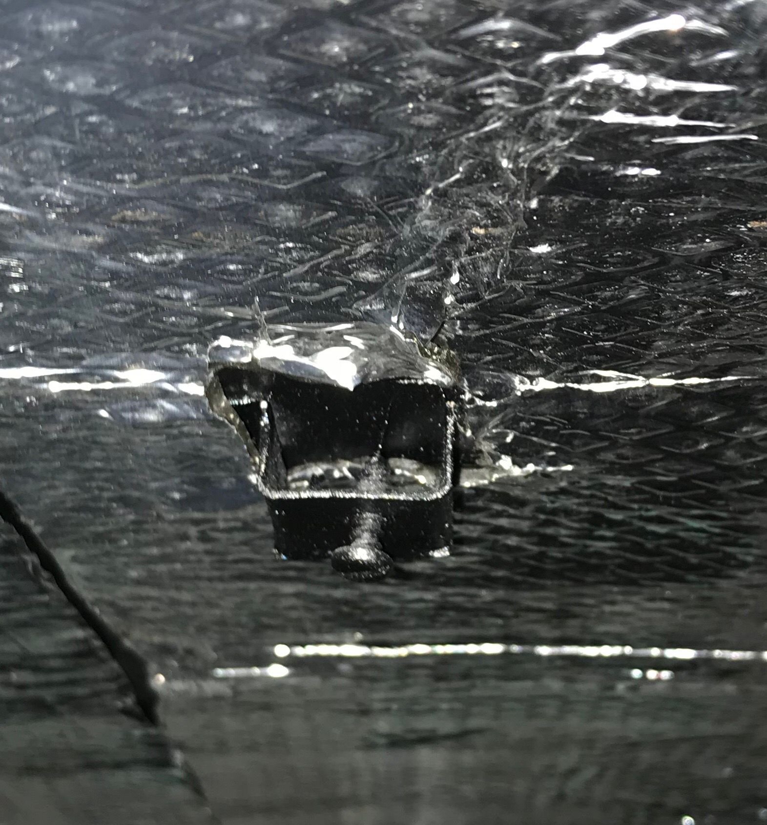

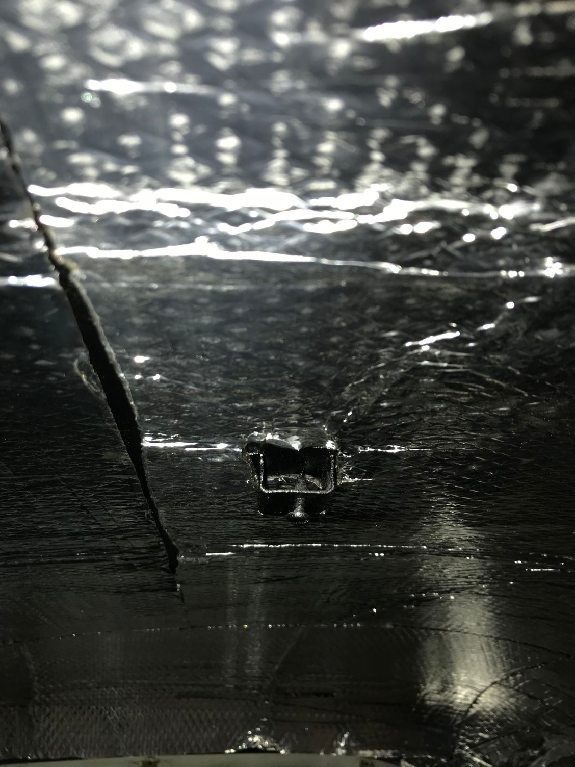

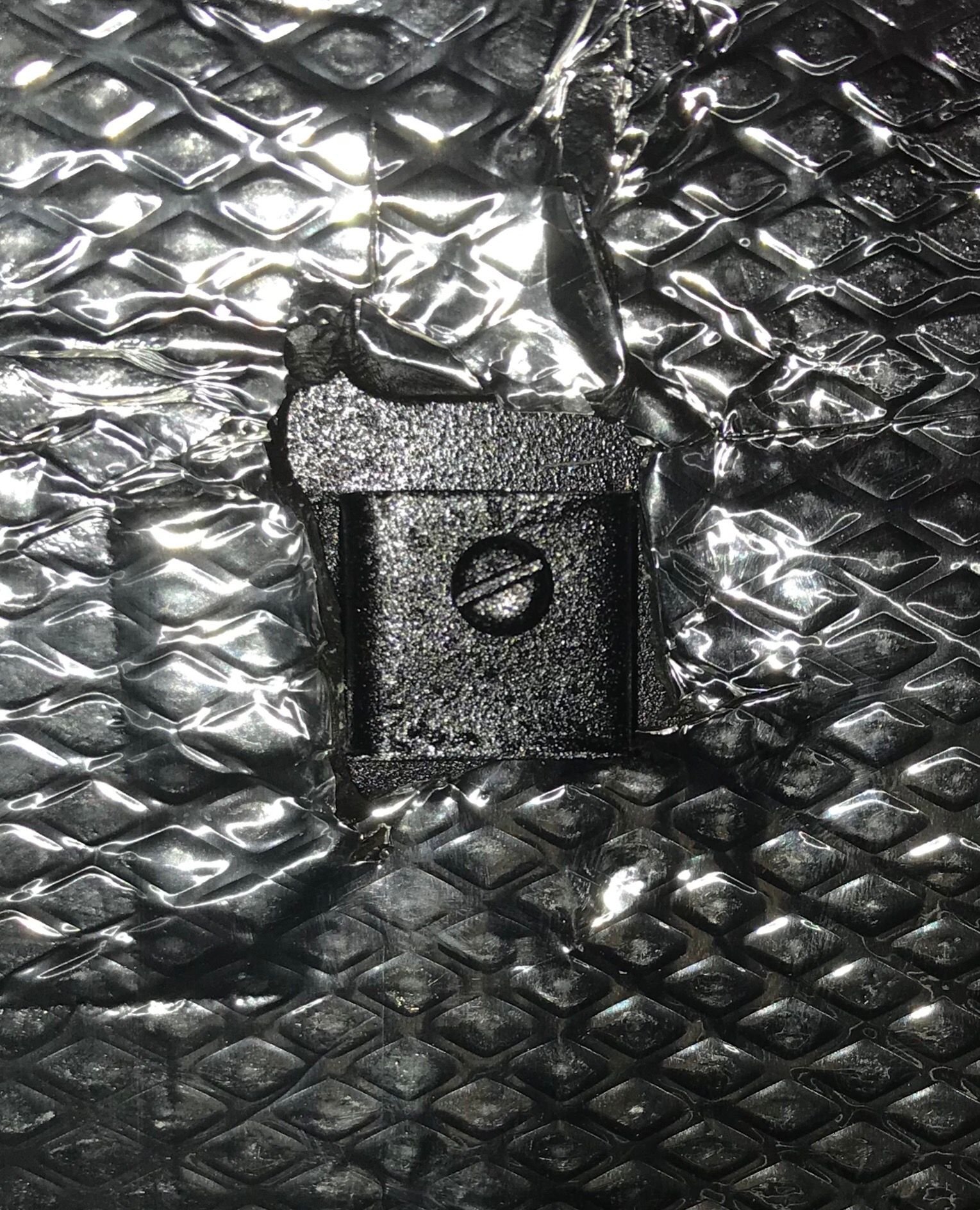

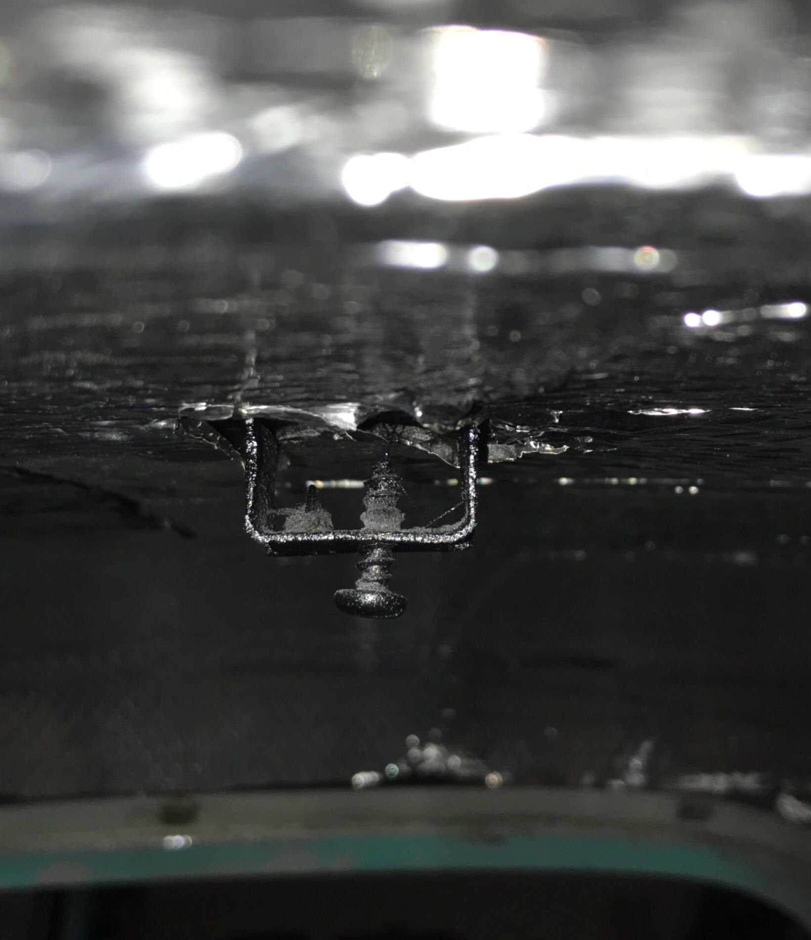

Ben I can get you a pic but it will be tomorrow cause it's just too darn cold to go out there right now

Here is the bracket on my roof (wrapped by my sound deadener)
