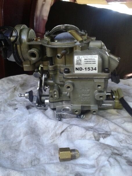

So my first order of business was to make sure that the engine would actually run, so I opted for a cheap-o 1-yr. starter to get the engine rolling over for ~$40, and a Wal-Mart battery for about the same price. The starter install was as straight-forward as anyone could hope for with only two bolts, and I had it in & out from underneath in less than a half hour.
I added 5 gallons of fresh gas and cranked it over to find that it runs, and doesn't have any knocks or clatter, but the carb started puking fuel through the vent after receiving the hammer-treatment. Being that I am a handy guy with a grounded view of my own limitations, I decided to skip the process of failing at a carb rebuild, and opted for a newly rebuilt commercial unit instead.
Once I started pulling off brittle plugs and other plastic pieces, I managed to break a mystery part as well as nearly all the plugs going to the carb that have become brittle over the past 30 years despite a heavy coating of engine oil, but the first part to let go was a breather elbow that's only available NOS for $30!!!
The factory plastic wing-nut didn't last long either, however, I think I found where that vacuum line with a nail in it was supposed to go.
It wouldn't be so bad if I had smaller hands, but I still managed to get the carb off. NOTE: The vacuum line attached to the carb below is the one that had a nail in it; does it really go to the bottom side of the air cleaner? Anybody know? <---Input here would be much appreciated.
I have to admit that I was a little disappointed by National Carb's workmanship.
It's obvious that the core they rebuilt had gotten a LOT more of the hammer-treatment than I ever gave mine, which perhaps that couldn't be helped, but the brass fitting was actually jammed into the fuel inlet line.
There was also a star-backed retaining nut that was missing from the new carb that I ended up replacing with a stainless nut & a lock-washer.
I wire-wheeled everything before I shot the brackets and air cleaner with Dupli-Color Semi-Gloss Black (DE1635), cleared the solenoid, and added a new Purolator fuel filter.
A new pack of vacuum caps & $10 worth of v-belts later, and it runs great - though it smokes enough to add a valve-cover gasket to the to-do list, so I decided to do something drastic, and I pulled the shifter.
This is a build-thread, not a carb-replacement thread, so stay tuned as there's much more progress underway! Cotton
