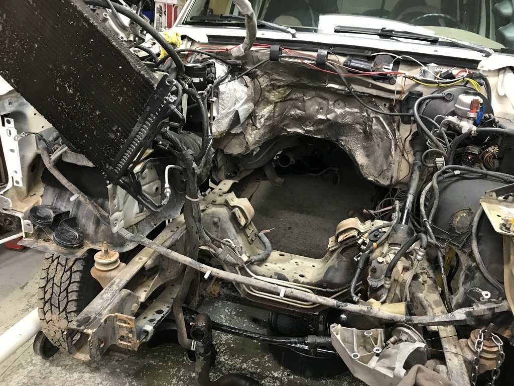

Hey everyone, hope you all are well. Been crazy for me for the last year+ but hopefully I have time to be on here a little more.
Just finished up with quite a few things on my truck. I pulled the engine out since I was doing so many things.
Here is a list:
New AC Code injectors
New Bosch 17 degree HPOP
SD turbo conversion
Garrett 38R turbo
Bellowed up-pipes
Comp Cams 910 valve springs
SD valve cover gaskets
DIY-ish Efuel with Strictly Diesel harness and Mark Fufazzotto fuel block
Riffraff billet plenums
AFE Bladerunner intake spyder
New pads, rotors, calipers
New radiator, waterpump, hoses
I resealed the oil pan while I was there and rebuilt the oil cooler. I didn't take near as many pics as I wanted as I was short on time and I didn't have someone to run the camera.
These are when I first had the engine out. Not much room in the shop.

Looking good man, how much did you have to modify the down pipe to fit the 99+ setup?
Old Apr 23, 2017 | 10:23 PM
Chris56ford's Avatar
Chris56ford
lost
Joined: Apr 2003
Posts: 290
From: Worland, WY
Thanks!
I had both the stock SD down pipe and my Diamond Eye down pipe. The SD one was not even close to fitting. I had to cut the Diamond Eye in one spot on the bottom side and change the angle a little so it would fit the bell joint. Other than that I just had to weld the SD flange on. It wasn't too bad. I also put new Energy suspension cab mounts in at the same time so that helped with clearance.

Nice work. If my eyes don't deceive me, those look like Dorman VC gaskets. How long have you been running them? Any issues?
Old Apr 24, 2017 | 05:50 PM
Chris56ford
lost
Joined: Apr 2003
Posts: 290
From: Worland, WY
Yes they are Dorman and I hope it doesn't bite me in the *** but I have read both good and bad on them. I like that they don't have the problematic inner connector, its all one piece.
I have used them for a month and so far so good, they seem to be decent quality.
